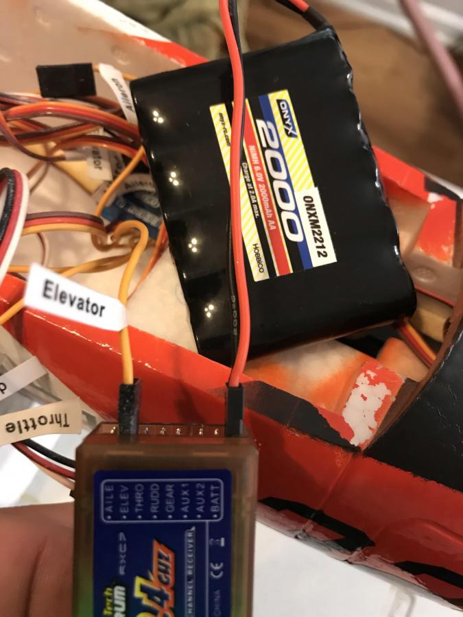

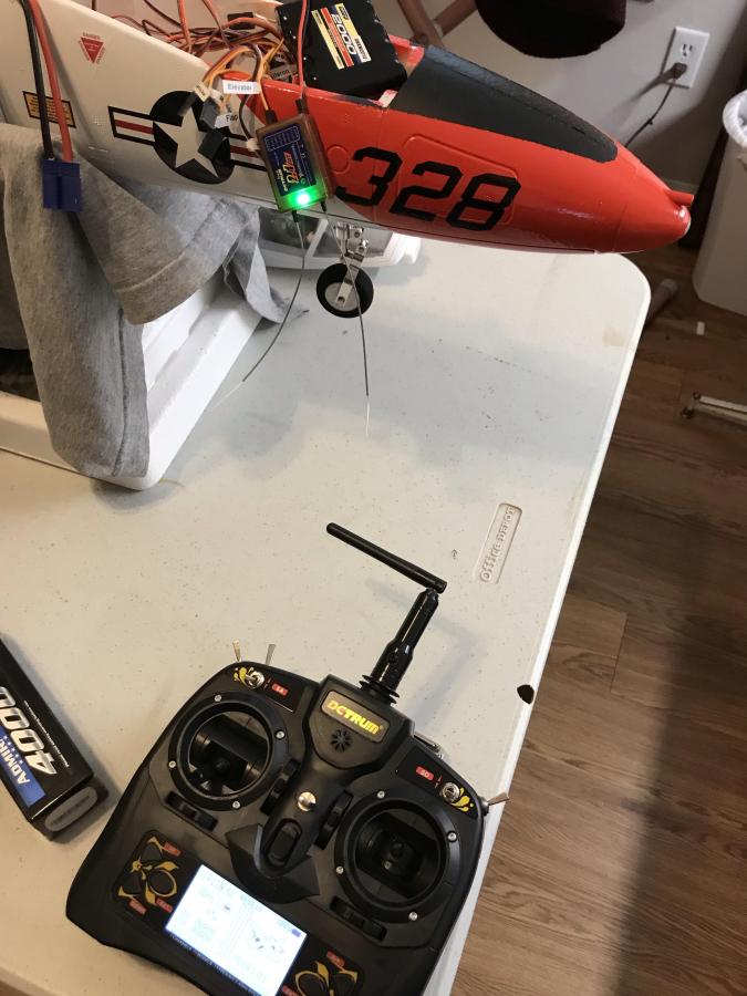

      ok, let me do that right now. BRB
      OK I tried it as pictures and nothing, nothing moves at all.

        First You always turn on TX first
        Second- If there was no beeping and tone, esc didn't arm, check throttle trim and increase low trim, check esc start up instructions
        Third- if esc doesn't arm, servos will not work, just lights

              I would take out throttle lead to rx and use a separate battery to bind tx and rx. Also make sure leads from rx to box are put in with right polarity. One last thing you can do is unplug one of the input lines to box and connect it directly to rx, leaving out line from box. If this works, then the box may be bad.
              • #8
                Originally posted by RMatteson View Post
                Also make sure leads from rx to box are put in with right polarity. .
                I am shamed to admit this after 25+ years of RC building & flying but yes, that is what was causing the issue. Everything is working as it should now. Thanks
