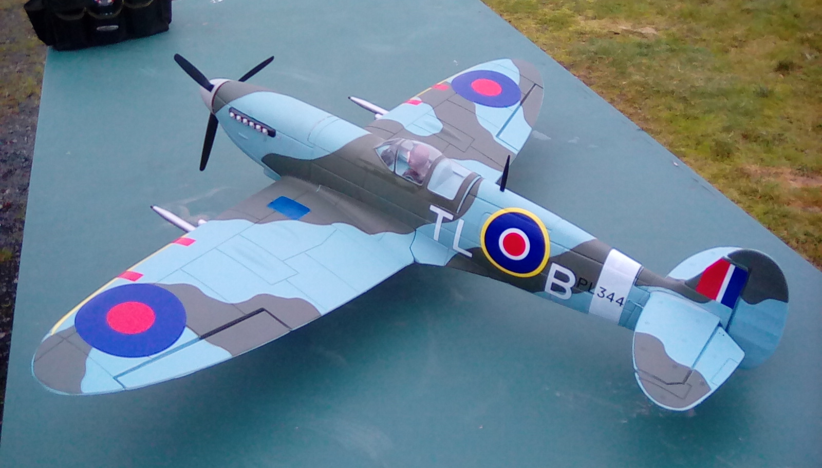

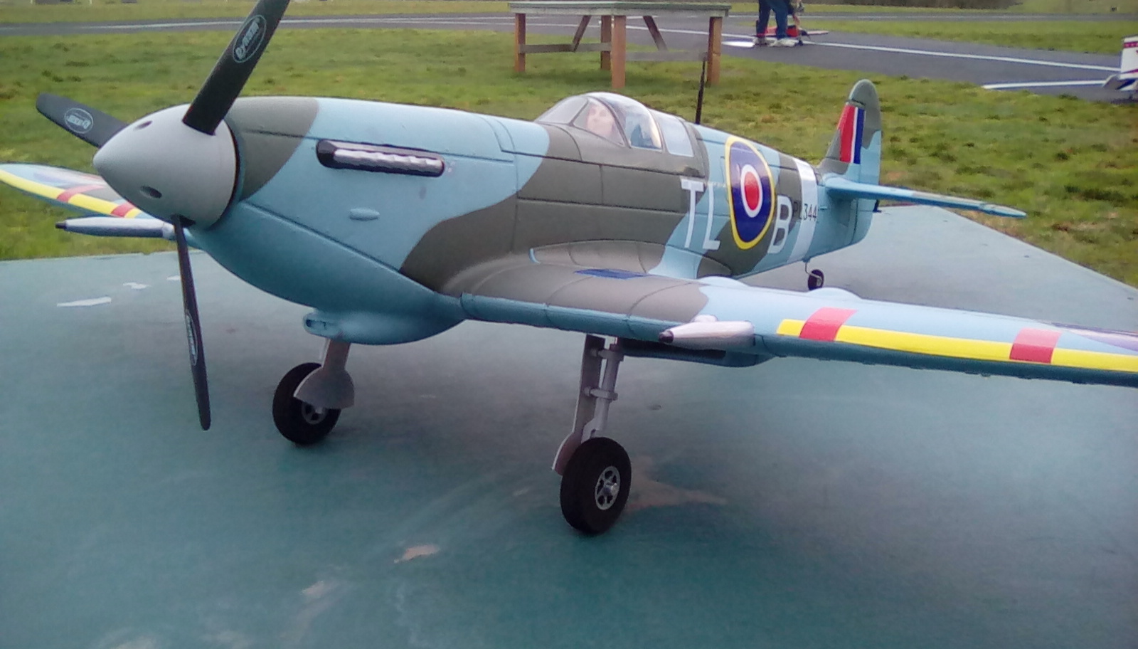

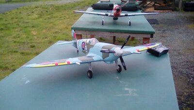

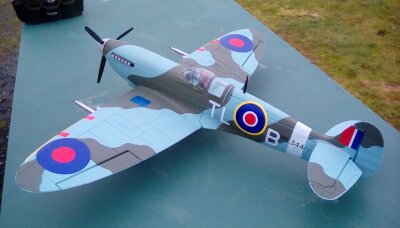

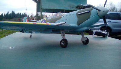

My winter build this year is the Dynam Spitfire. This build is going to be pretty cut and dry. Being well informed in Dynam war birds, Only a few mods are going to take place. For starters I'm throwing out the stock motor and ESC. Not fast enough and the stock 3 cell motor DONT LIKE a 4 cell pack behind it. Surging and vibration will kill it in around 4-5 flights. Instead I'm opting for the Dynam 4 sell KV650C motor and a 50 amp ESC most commonly found in the SU-26. The motor is also 5mm's longer so trimming for spinner clearance not needed. The only trimming will be in the batt bay. Its all plug and play and will bolt right up. The other advantage is, I will be able to select a number of prop sizes until I find the one thats going to work the best with out ground striking the prop and getting the most speed. I'm thinking an APC 12x12 single blade is going to be my best bet. Single blades work best on any plane for speed and performance. Sure wont look as sexy while on the bench, but dog fighting and racing around the poles is what we do here for fun. Next all hinge surfaces will be reinforced with nylon hinge tape, landing gear raked forward as far as possible, And a set of DAVE BROWN shock absorbing tires to complete the build. And if I find the motor swap is not fast enough to stomp the competition, Plan B is to swap in the P51 strega motor next winter which is going to require a lot more time, energy, and reinforcing. The Dynam Spitty and P51 Mustang are perfect matches for the Strega motor swap because of there flying weight, and stock prop size. Why not just buy one those 980mm speed demons you ask? Because there 980mm's of twitchy. The bigger they are, the easier they are to fly, and I dont recall a Spitty or P51 war bird in there line up. If MRC had speed demons in the 1250mm class I would be all over it. My bank account would be empty, and I would be divorced, HA!
