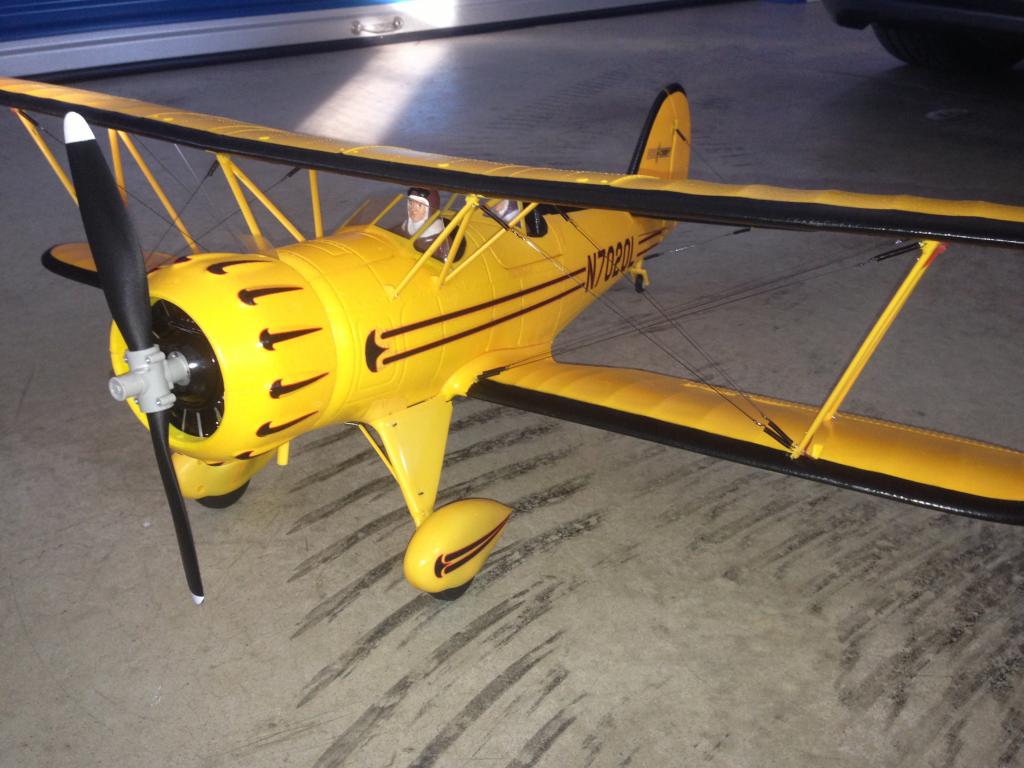

        I just got mine together, not flown due to weather here in Indiana.
        A few build notes.
        I had some trouble with the screws that hold the landing gear retainer plate, I had some alternate screws that worked better.
        Landing gear leg fairing plates; I drilled a couple of holes on either side of the retaining clip and ran a few turns of wire around the legs and through the fairing plates to more securely hold them on.

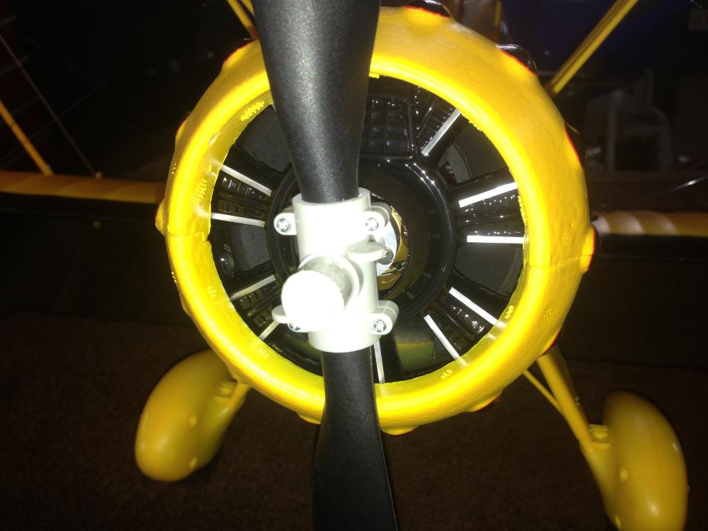

        Dummy Engine; I opened up the area between the cylinders to allow more air through. I painted the firewall and inside the cowl flat black. I added pushrod tube detail with 1/16 inch silver stripe tape.
        I used 24 AWG black wire for the brace wires.
        The aileron servo wire channel in the lower wing was pre-covered with yellow tape. It needs to be pulled up to run the nav light wires. This left the tape unusable so after the light wires are run, I used new white tape and painted it yellow.
        Prop balance; mine was off and caused quite a bit of vibration, don't fly it like that, a trip to the balancing stand took care of that.
        Check all the linkage screws before you fly, mine were looser that what I'm comfortable with.
        This plane was a bit more work than a typical monoplane but the results are well worth it.

                      The RocHobby (FMS) Waco Bipe arrived today!!!!
                      Just finished unboxing and inspecting everything and all is well!!
                      What a georgous airplane!! Interesting note, and I really don't know if perhaps this plane is made with a different foam density or of it's the paint job...... but the plane has a kind of - for lack of a better term - rubberized feel and texture to it. Unlike any model I've encountered. It's not a bad thing, just different.
                      I also noted that the areas between the cylindar heads of the simulated radial in the cowl are already cut out for ventilation.
                      Like some others have previously mentioned, if there is a low point it would have to be the variations in the coloring of certain components... primarilly between the foam and plastic pieces. I'm thinking of converting them to black, maybe.
