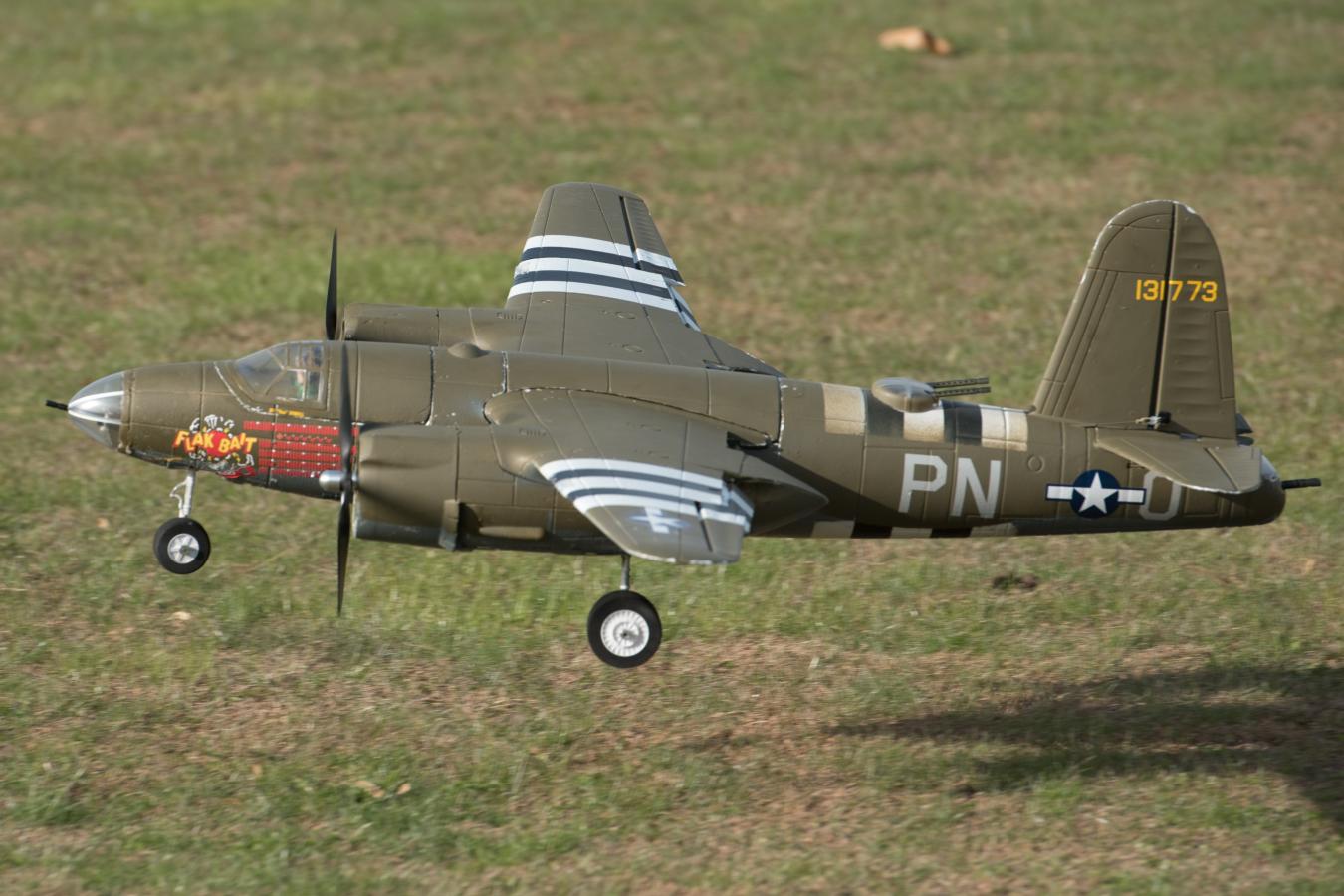

    Took my Dynam B-26 maiden flight this weekend. Winds were 8- 10 mph. We only have grass runway. Took off into wind with partial flaps. Took her up high and slowed the plane down..It did a wing tip stall and went into a death spiral.. My chief test pilot saved it. He flew for another 5 minutes on the 4s 3600 battery. As he were getting into the landing flight pattern , he turned into the wind. It slowed the plane down and plane went into another death spiral...but at a lower height. Real scary!!!. Again my pilot saved the day. He indicates that the plane is under powered. He wonders if we can put a 5s battery in the plane or change out the underachieving motors or ESCs? Does anyone have experience with upgrading to get more reserve power? My dad flew a mission in Flak- Bait on Sept 5, 1943. He was shot down on Nov 3, 1943 and ended up in a POW camp.

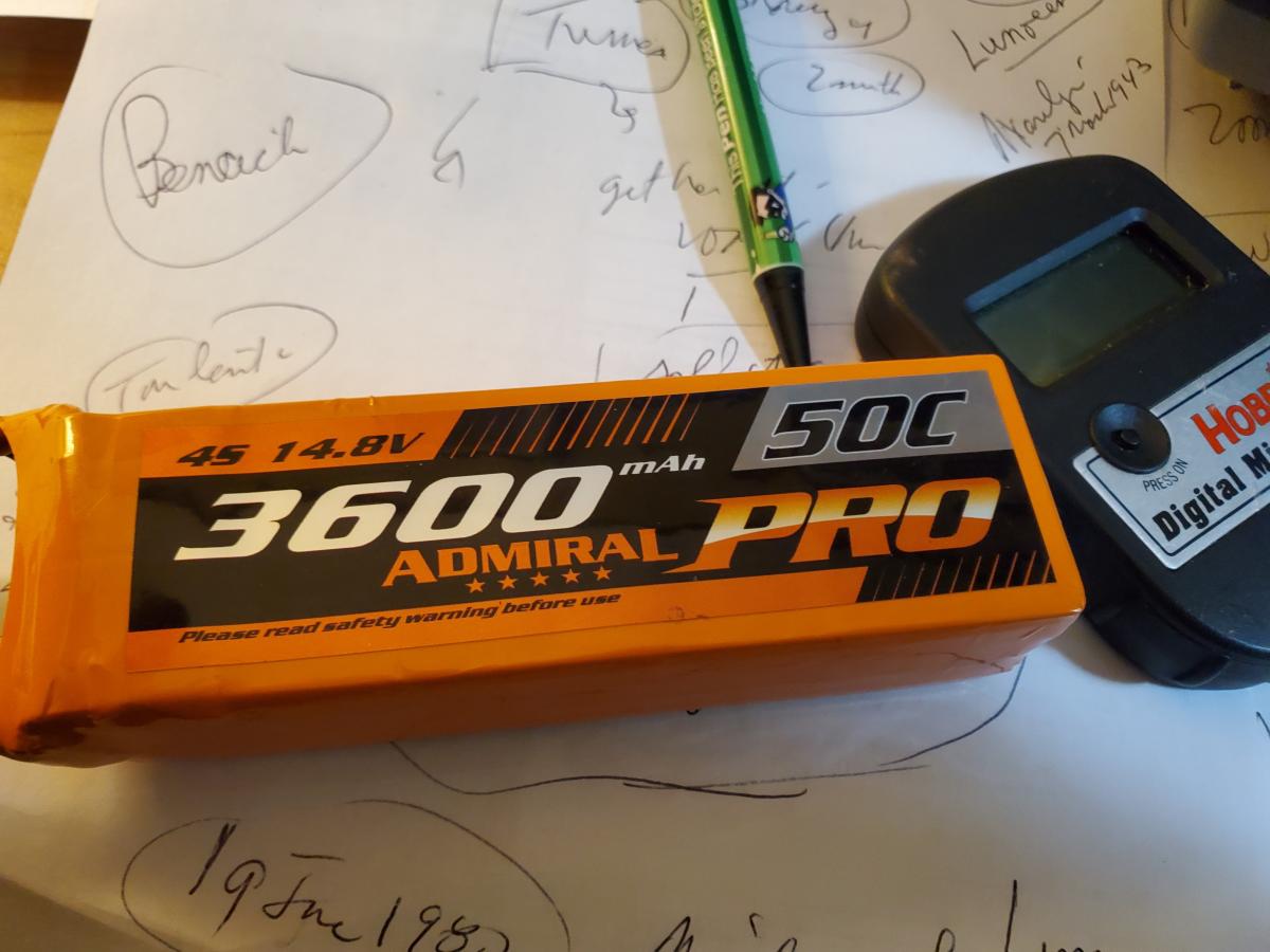

      I used my Hobbico Digital mini -tach to see what rpm on current motor was- motor was powered by 3600mAh 50C admiral pro battery. I read 11700 rpm at 100% throttle.

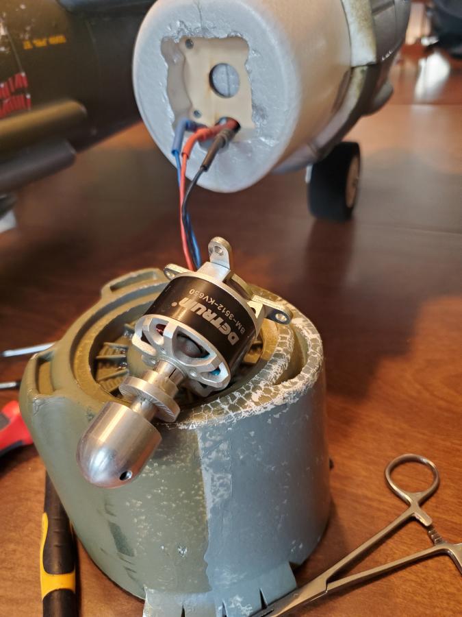

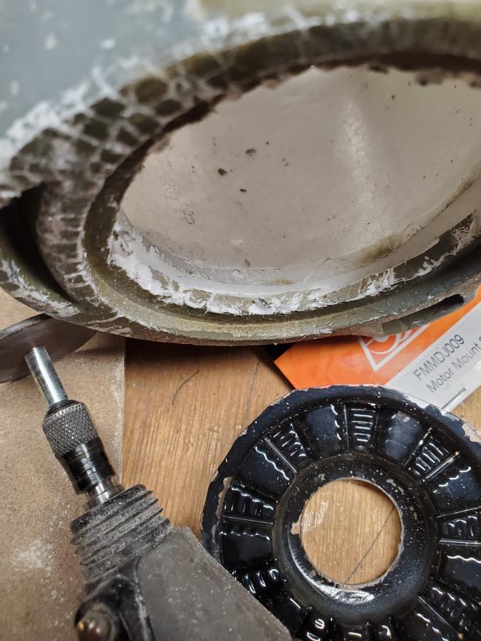

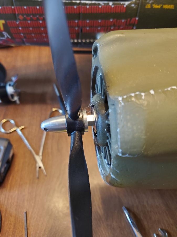

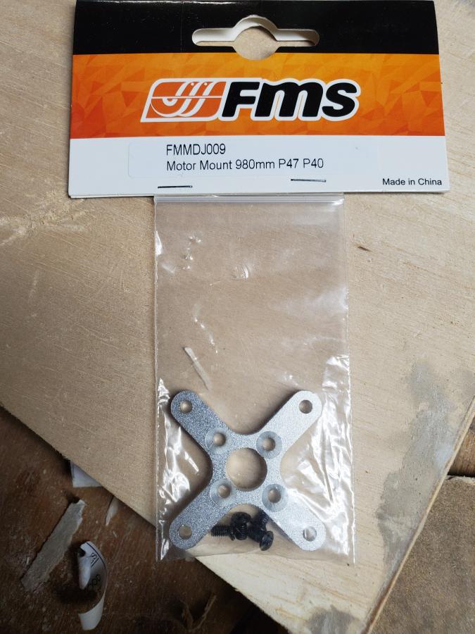

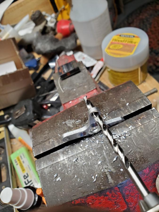

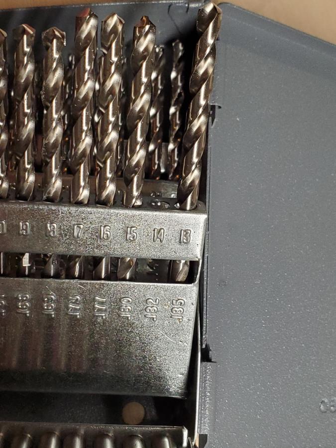

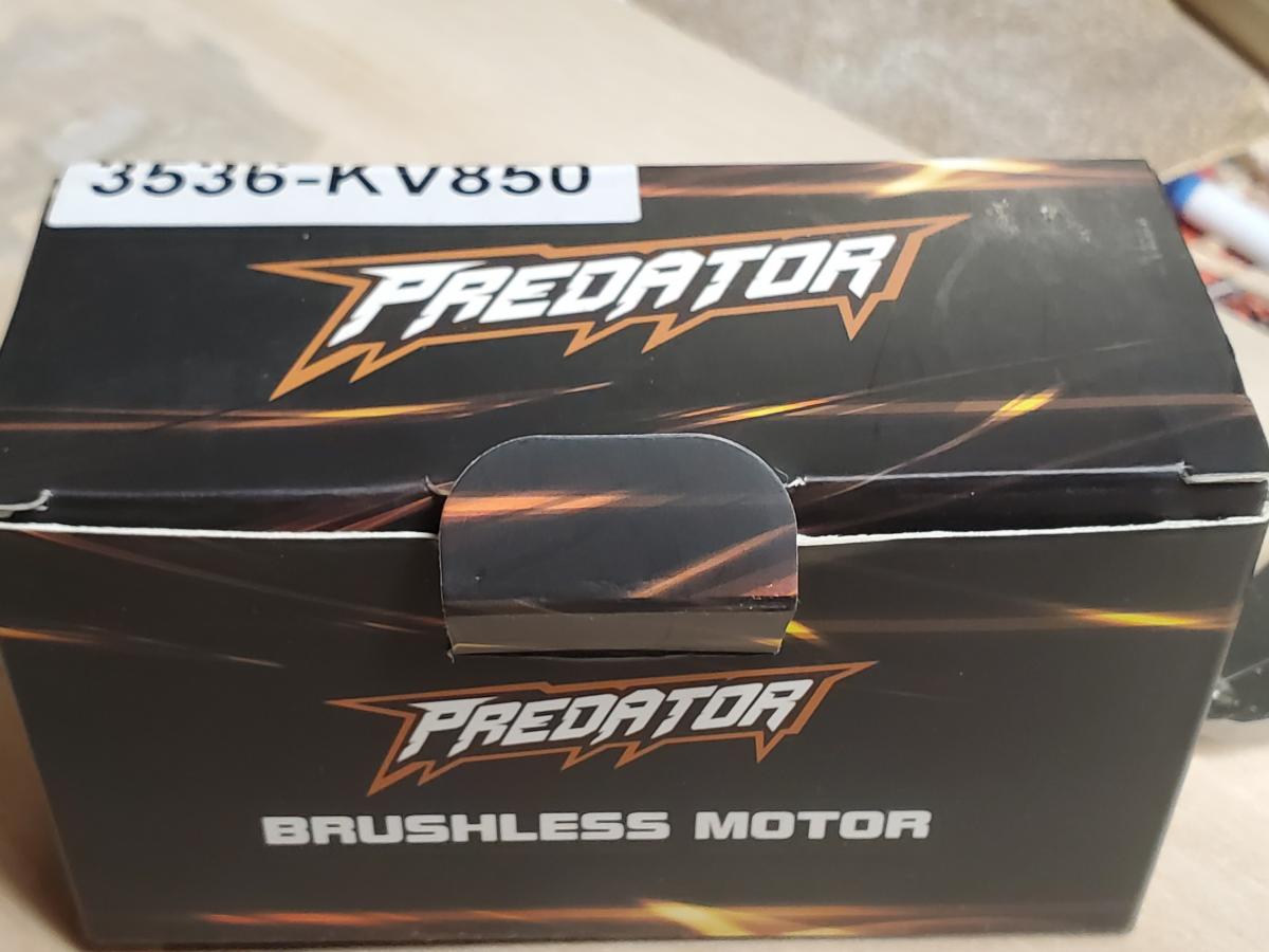

      I changed out existing motors with Predator 3586 KV850 motor. It is OK to run with existing ESC. I had to also enlarge holes on mounting X-( FMS FMMDJ009) with a 14 drill bit to be able to fit current hole configuration on firewall. I adjusted cowling as motor is longer than original
      I put it back together. I re tached with new motor.. RPM is now up to 24,800. Props are not now counter rotating with the way I hooked them up. I am going back to Bob for some advice as to what color motor lead goes to what color esc to get to correctly work.

        WOW, you've more than doubled the max rpm, however, that doesn't sound right. An 850kv motor running on a fully charged 4s battery should only be cranking out in the 14,000 rpm range. Your reading for the stock motor is about right at 11,000 rpm.
