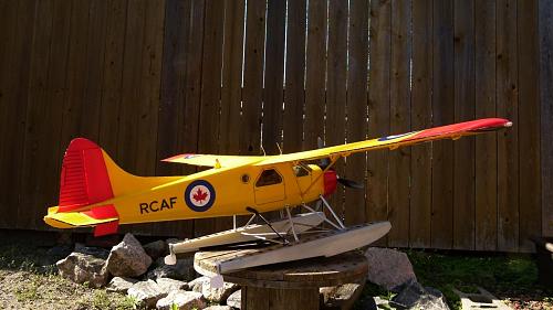

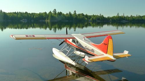

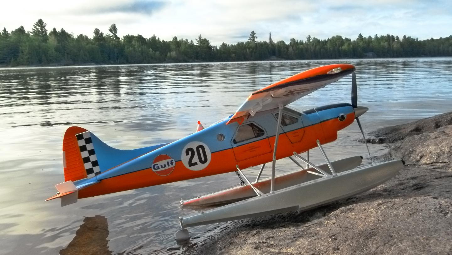

        You're welcome Corsair! I haven't tried the camera set-up yet. I will get into that one day. It would be great to see aerial footage of the lakes and rivers I fly on here in Ontario. I have 2 Beavers and 1,Turbo Beaver which HH cancelled in a year or so of production. The Turbo flies great. Higher kv motor. No parts for it either. I'm buying a new FMS Beaver 2000. Freewing should produce a DHC2....Take care and a Merry Christmas...
