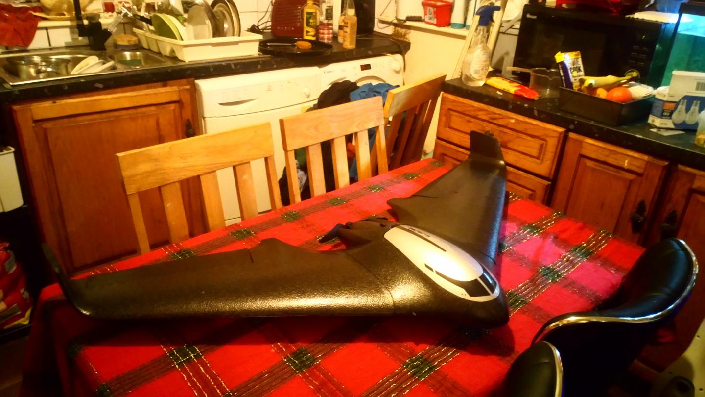

ID:	232600its just under 1.800mm
            • 8835
            OK, so you don't have the JDX525. I can find no information on the 1800 JDX. It's even more obscure than the 525. You're likely going to have to go to where you bought it and make inquiries there.
