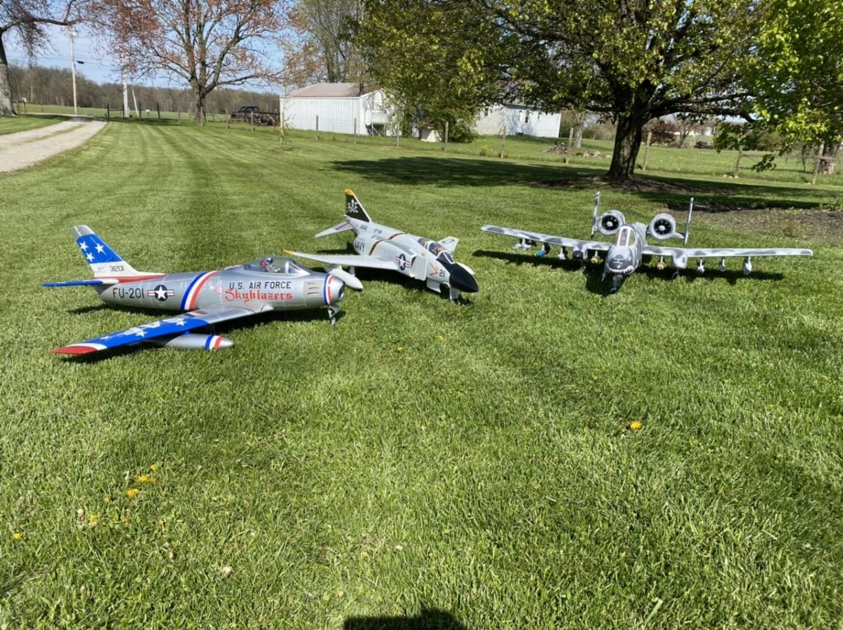

      combatflyr if using rattle cans I tend to stick with Krylon. The F-86 in the pic below was painted with Krylon. The F-4 and A-10 were painted with latex thru a HVLP gun and airbrush.
      Funny the only plane I didn’t repaint is my Avanti as well.

        Very nice fleet! I especially like the F-86, the Sky Blazers theme is one of my favorites. A long time ago I worked as a mechanic on privately owned Sabres. I was engine run and taxi qualified, loved that plane. Free Wings paint scheme on the new Draken is hideous and the only one offered I think that is a marketing mistake.

          The Skyblazers paint scheme was the most difficult one of the bunch. The base coat kept lifting on me. I just put the maiden in it Saturday and it is a sweet flying plane and has a great sound.
