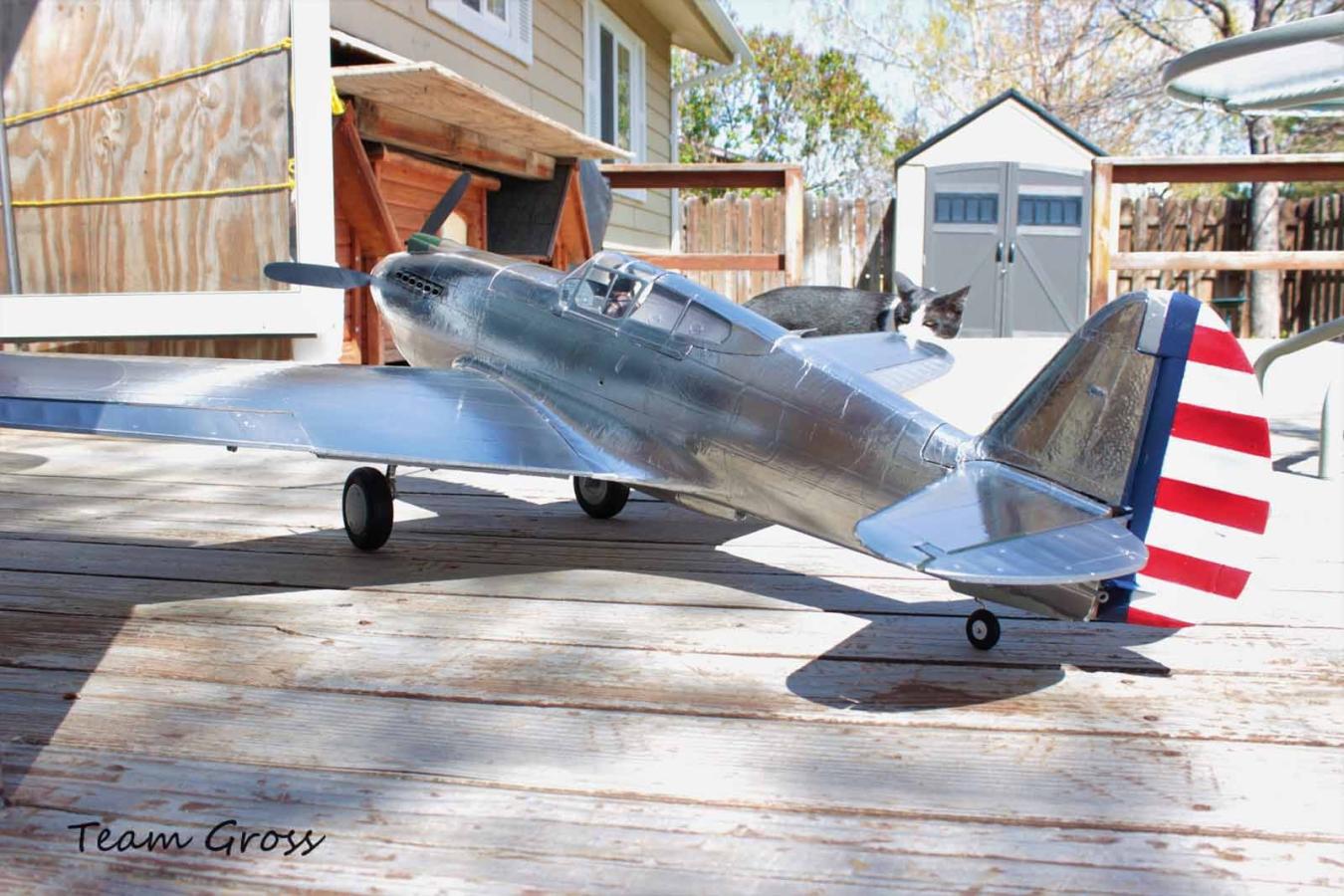

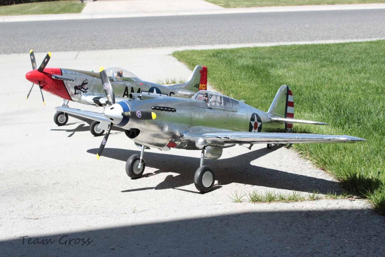

            Dan, what is your paint scheme and markings you're going to use for the P-40 after you get the flight metal on it?
              • 7437
              This was the inspiration:

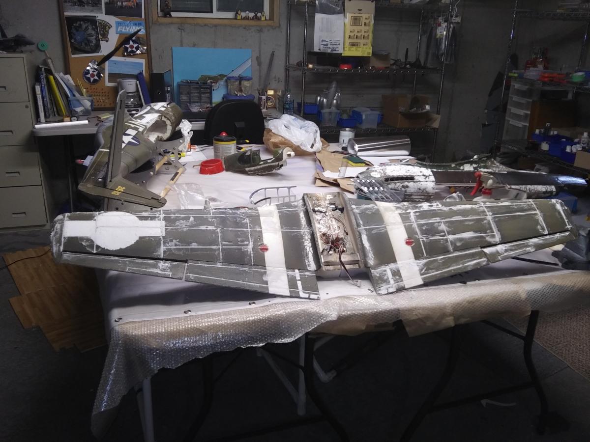

              This is where I was with the aluminum colored Duc Tape:
ID:	326736Click image for larger version

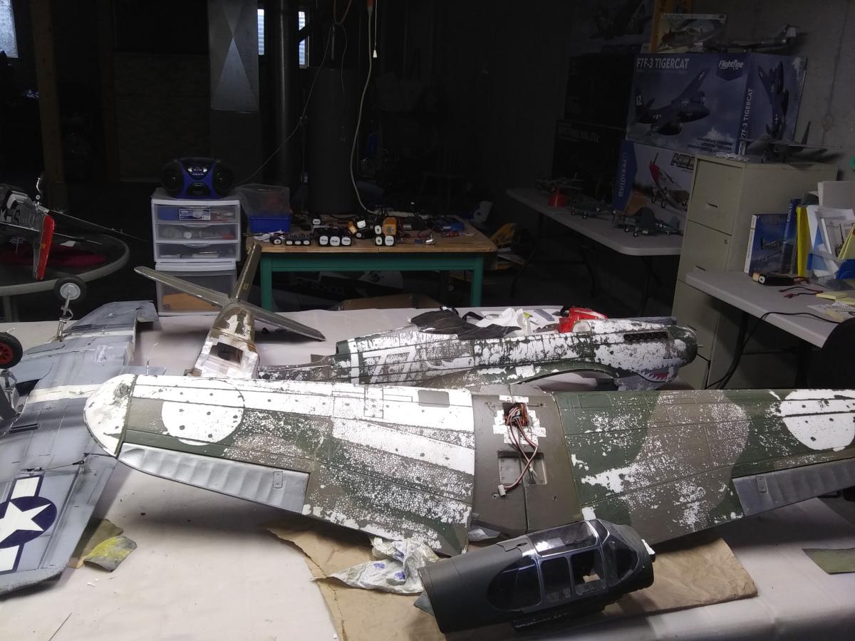

                There was little damage to the plane, most of it around the carb intake/machine gun area of the upper fuse. I cut that piece out to find that they have a weight installed on the underside of it. So when I go to CG it again, I'll leave that piece loose in case I have to add or subtract any weight, its the ideal place!
                She'll be pretty again!
                As For The P-51B, I'm thinking of doing a full rebuild to scale on it, fill in the panel lines, prime and sand. Following RC Geek's example with his F 14. It may or may not fly again, I'm missing the attachment point in the fuse for the wing, I'm sure its around here somewhere or I might have to rig something up. If that's the case, she'll just look pretty. I am planning on replacing every servo on her now that I suddenly have a bunch of good servos from La Patrona. They'll all be tested before installation of course.

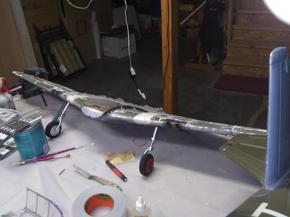

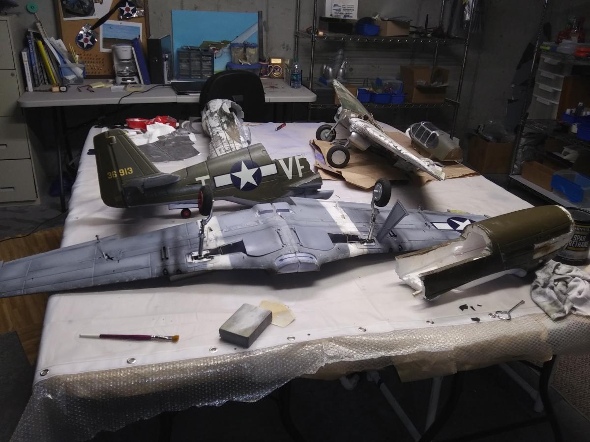

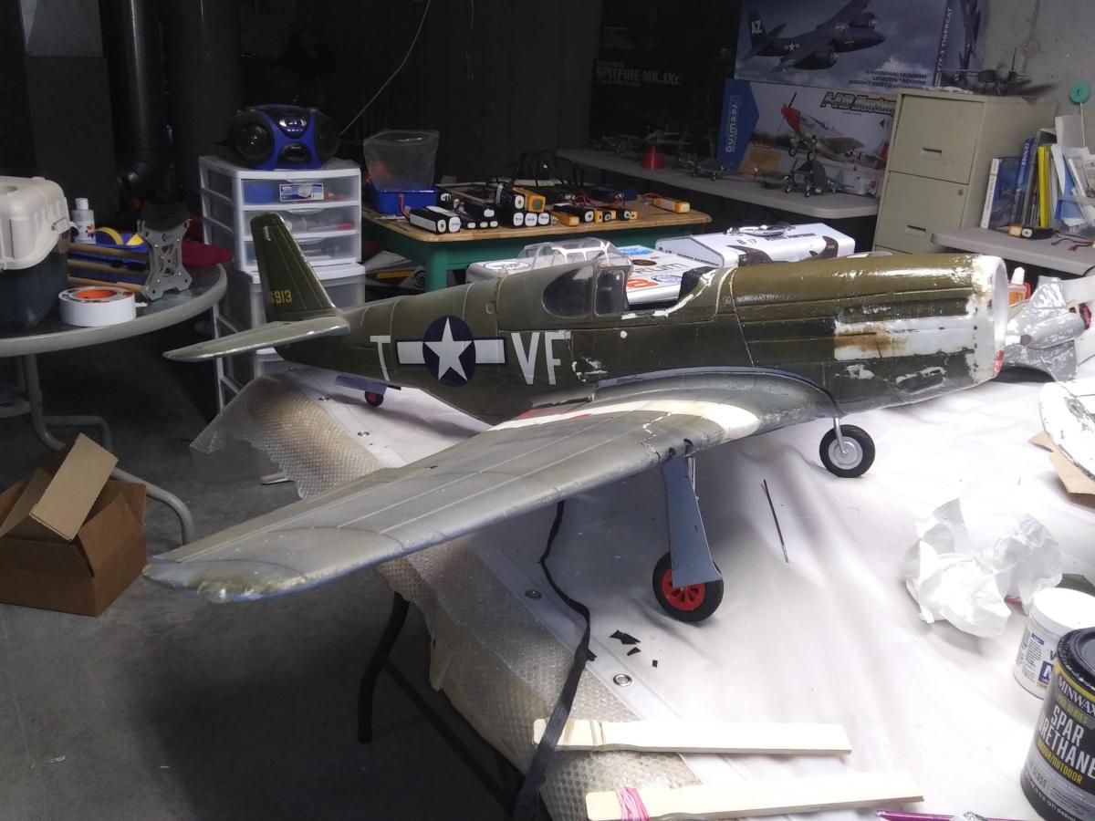

                          So, I'm digging into the projects, started applying Flite Metal to the P-40B and started in on the Mustang. The Mustang is Project Make A Mustang Great Again, Again!
                          I decided to completely refinish her using the methods that RC Geek demonstrated with his D model and the F14

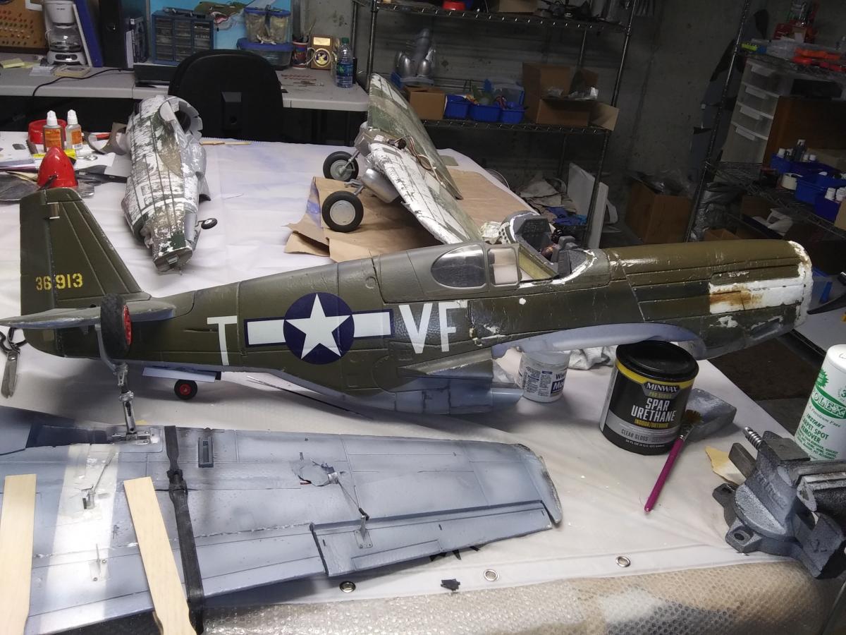

ID:	327171 . Filled in the panel lines and my buddy Ron built me some new pins for the landing gear.
                          Filled in the panel lines and removed the decals Click image for larger version
                          A trial fit to see what I was dealing with. and Below I was reattaching the flap using stir sticks held together with rubber bands to make a great set of clamps, the velcro strips to help hold it against the wing.
ID:	327168Click image for larger version
ID:	327169Click image for larger version

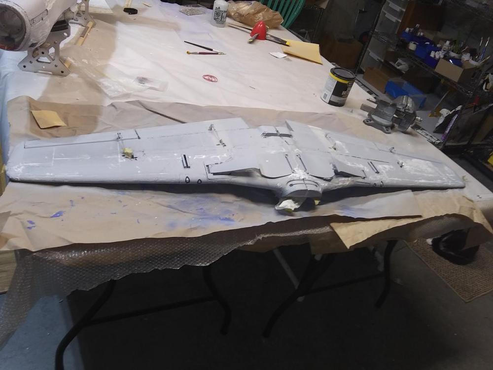

ID:	327170picture one is where we're at right now. I plan to fill in all the panels lines on the wings and fuse, sand and primer then repaint to stock colors. then add panel lines with a mechanical pencil and clear coat, add new decals, clear coat again then start the weathering process. I'm also filling in the gap between the battery hatch and the fuse. She always had one and now is the time to fix that as well. Haven't decided whether she'll fly again, but I am going to run every electrical connection and servo through testing to try to figure out what the heck is going on. Let's face it the FMS 'B' model is an endangered species and deserves to be preserved on way or another. She's starting to sound like her full sized sister.

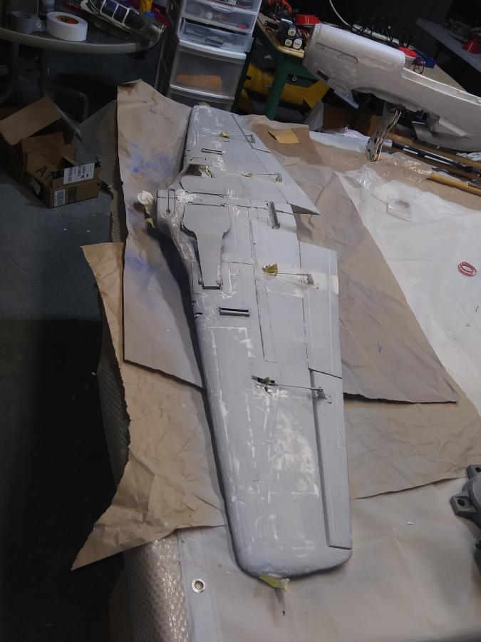

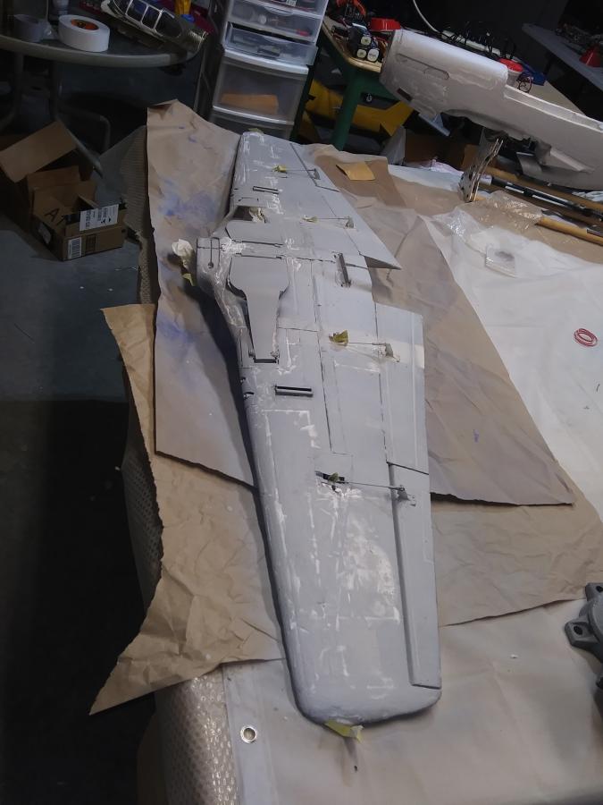

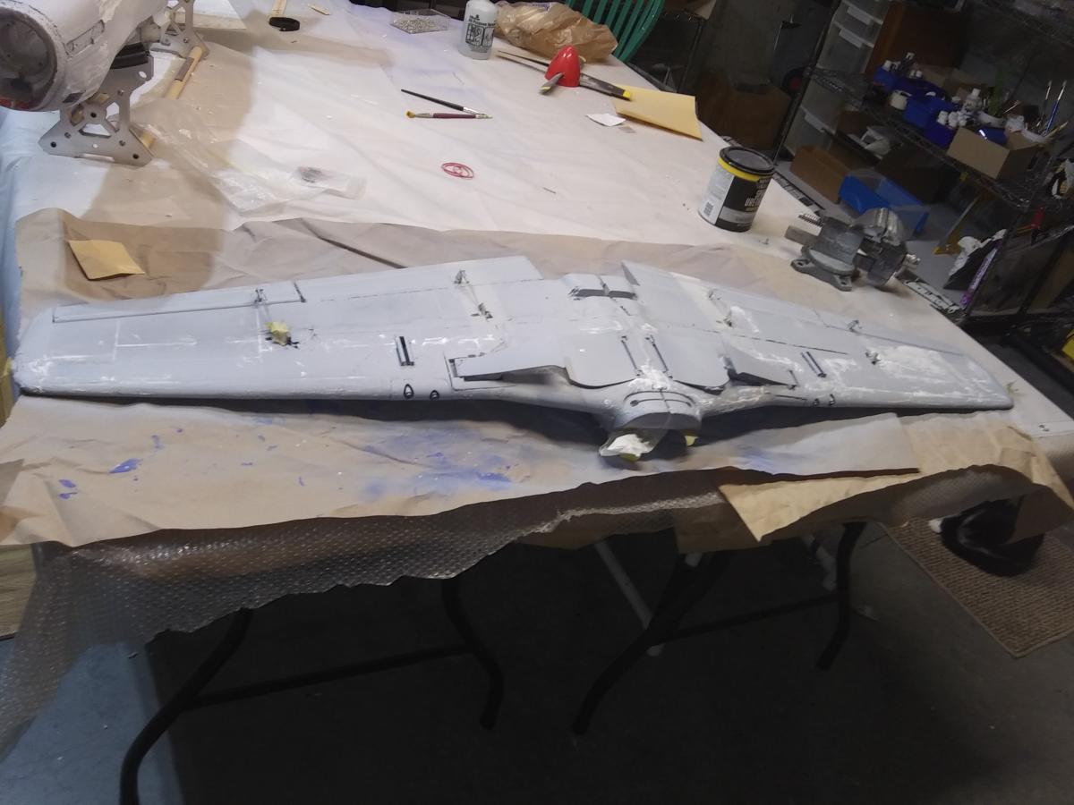

                            • 7437

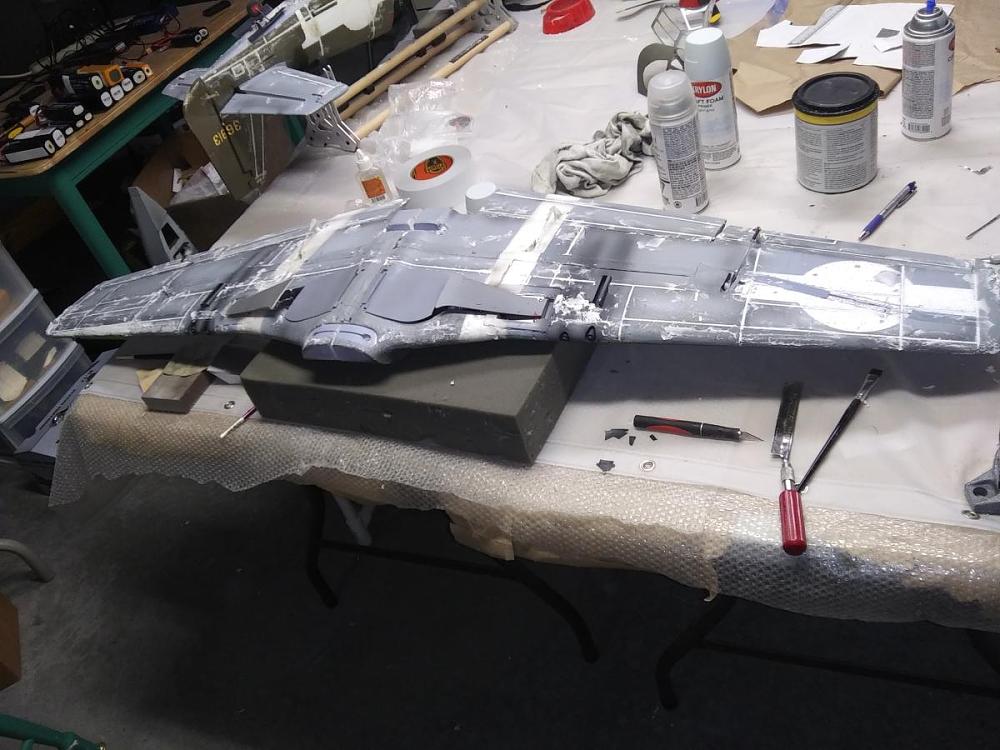

                            The top of the wings are ready for primer, the bottoms have just been spackled. The fuse is in one solid piece and the panel lines are all filled in she's partly sanded, stopped to let everything dry up again.
ID:	327465Click image for larger version
                            The hatch/ cockpit area may look a bit funny, but its all part of getting rid of the gap between them.

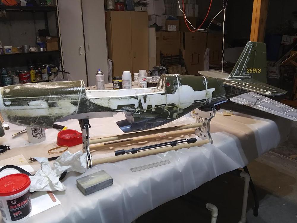

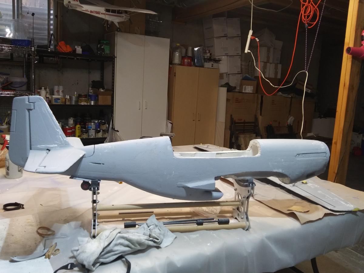

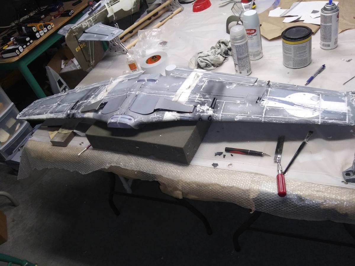

                              • 7437

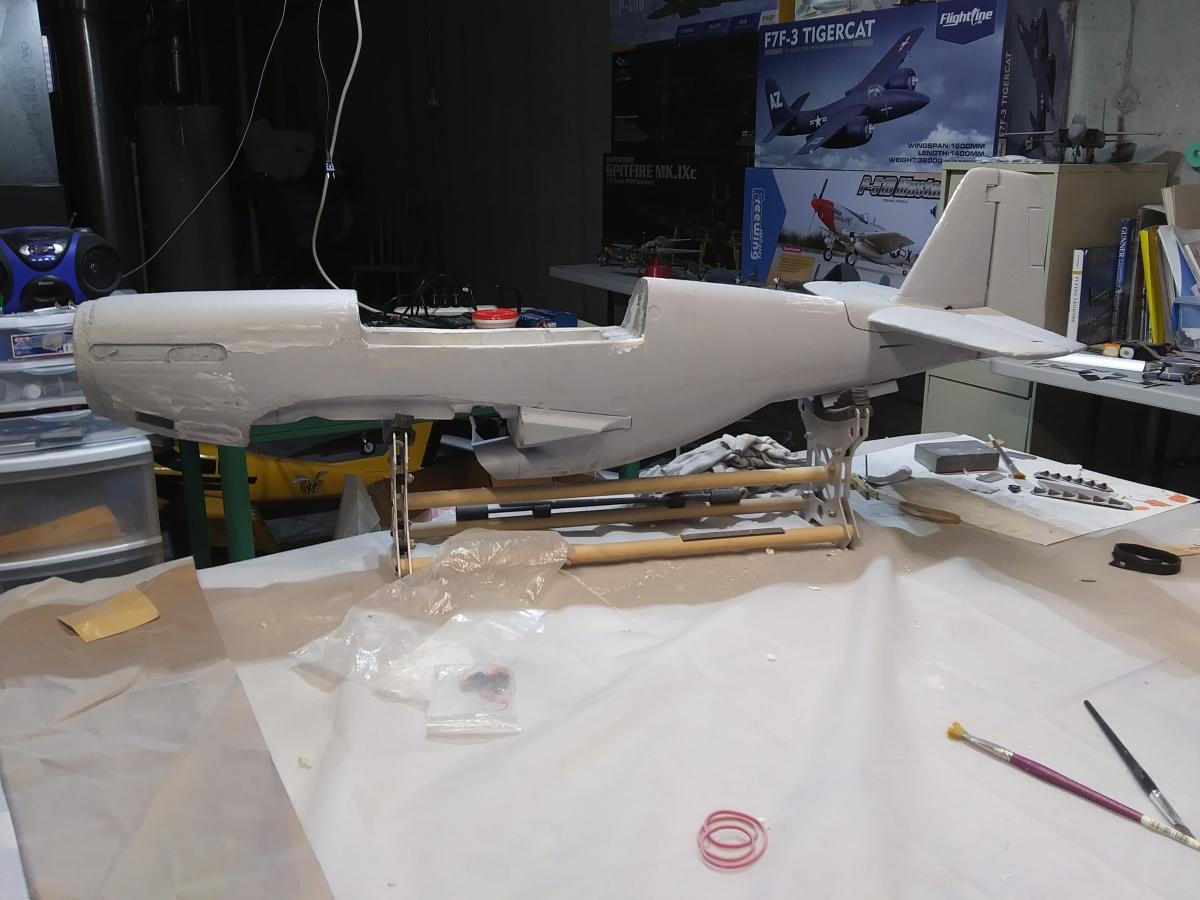

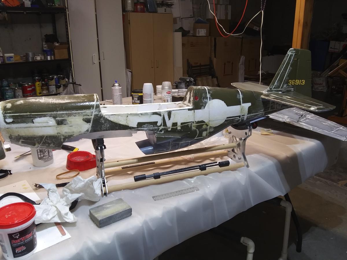

                              Fill and sand fill and sand. I think 'm almost there now, the last of the filling and then wet sand in preparation for paint
ID:	327938Click image for larger version
ID:	327941Click image for larger version
ID:	327939Click image for larger version
                              I'm living by the old adage that it must get ugly before it gets pretty again.
                              I'm looking forward to the day....
                                Dan, What are you using for the fill ?
                                  • 7437
                                  #17
                                  Walmart light weight spackle. Did another pass with it for little spot touch ups. I've watered it down a bit to help the flow on the smaller indentations. Tomorrow it will get wet sanded then I'll try some paint on her.
