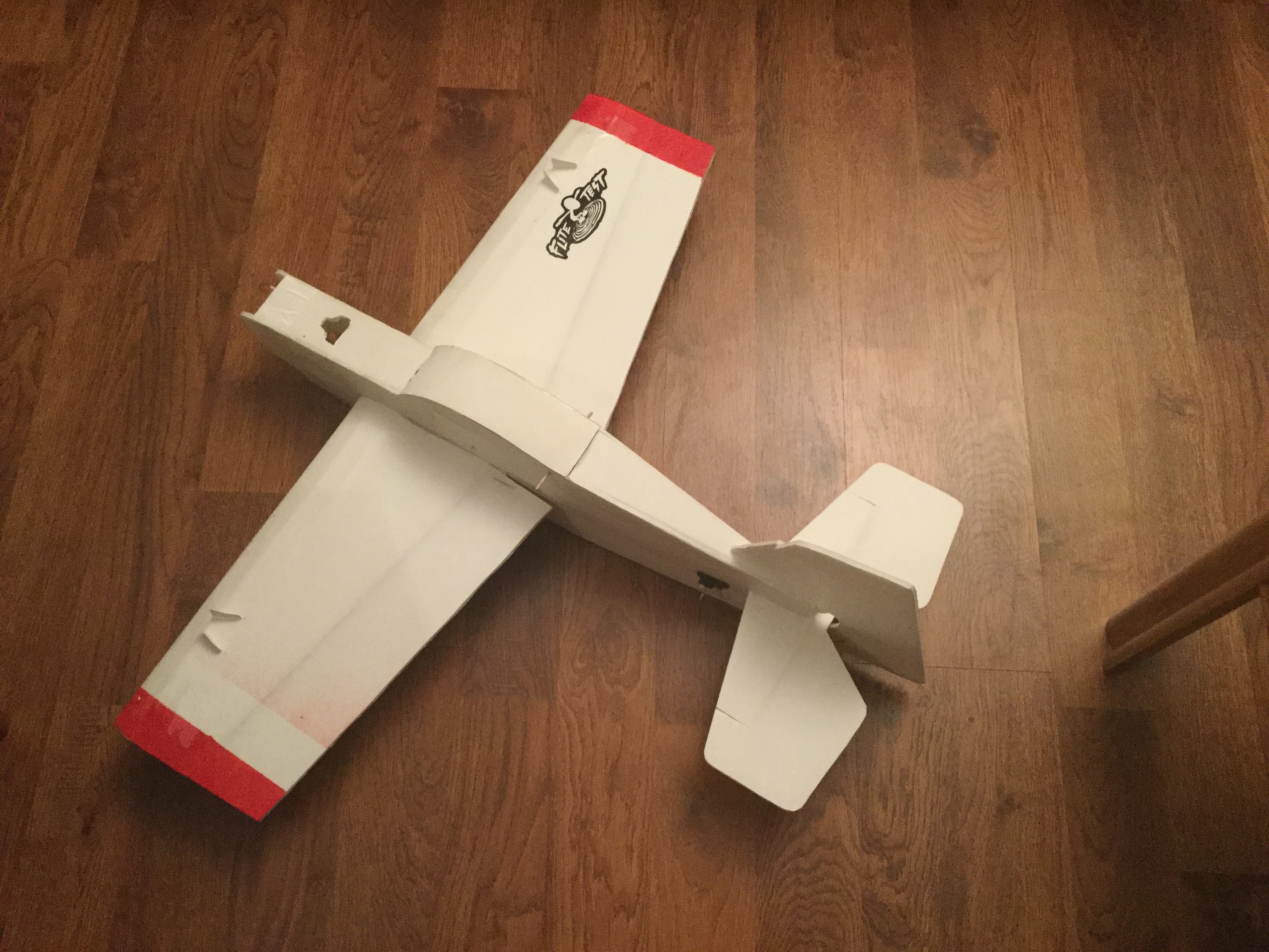

    Here's a pic of my FT 3D, which took roughly 10 hours to build, since I was taking my time. On this aircraft, the power train is modular, so I can move it from plane to plane. I take no credit, as Flite Test designed the aircraft, all I did was trace, cut, and build.
