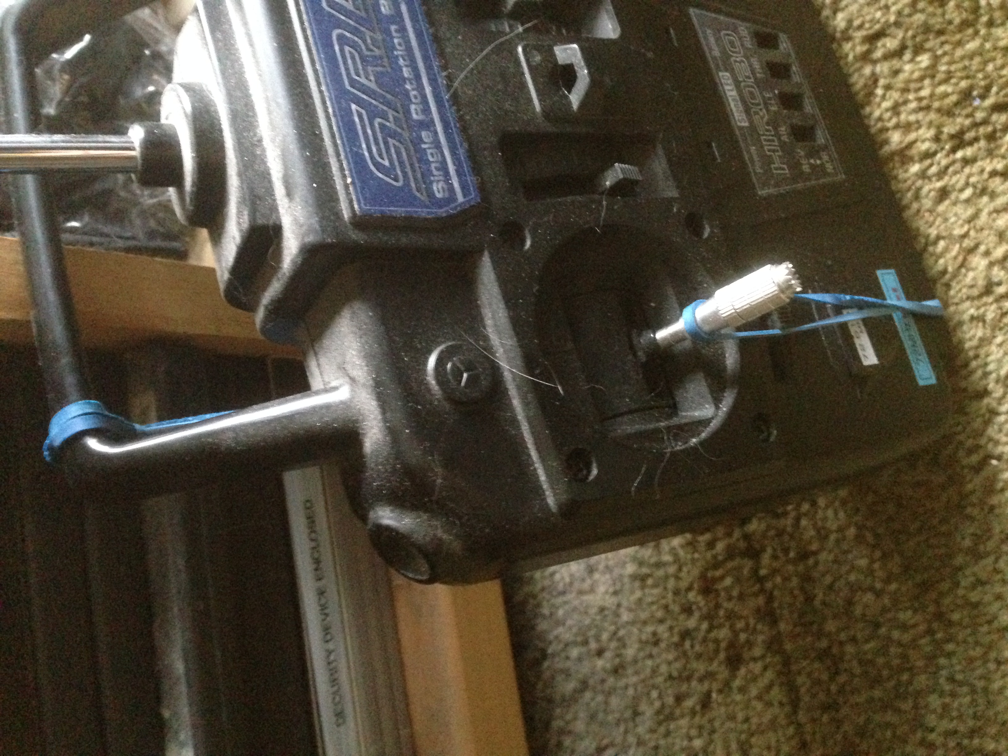

                      For those who don't have "throttle cut" on their TXs, this is what I do. I stretch a strong rubber band around from the TX handle, around back, under the base and hook it around the throttle stick. Click image for larger version

                              Good thought Viper, in a pinch that would do the trick.
