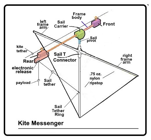

A device that drops a payload from a single line kite has been developed. The device,
called the KiteMessenger
uses a sail to ascend the kite line and a 433 mhz transceiver to drop a parachute
load and allow the KiteMessenger to descend back down the line so the operation
can be repeated.

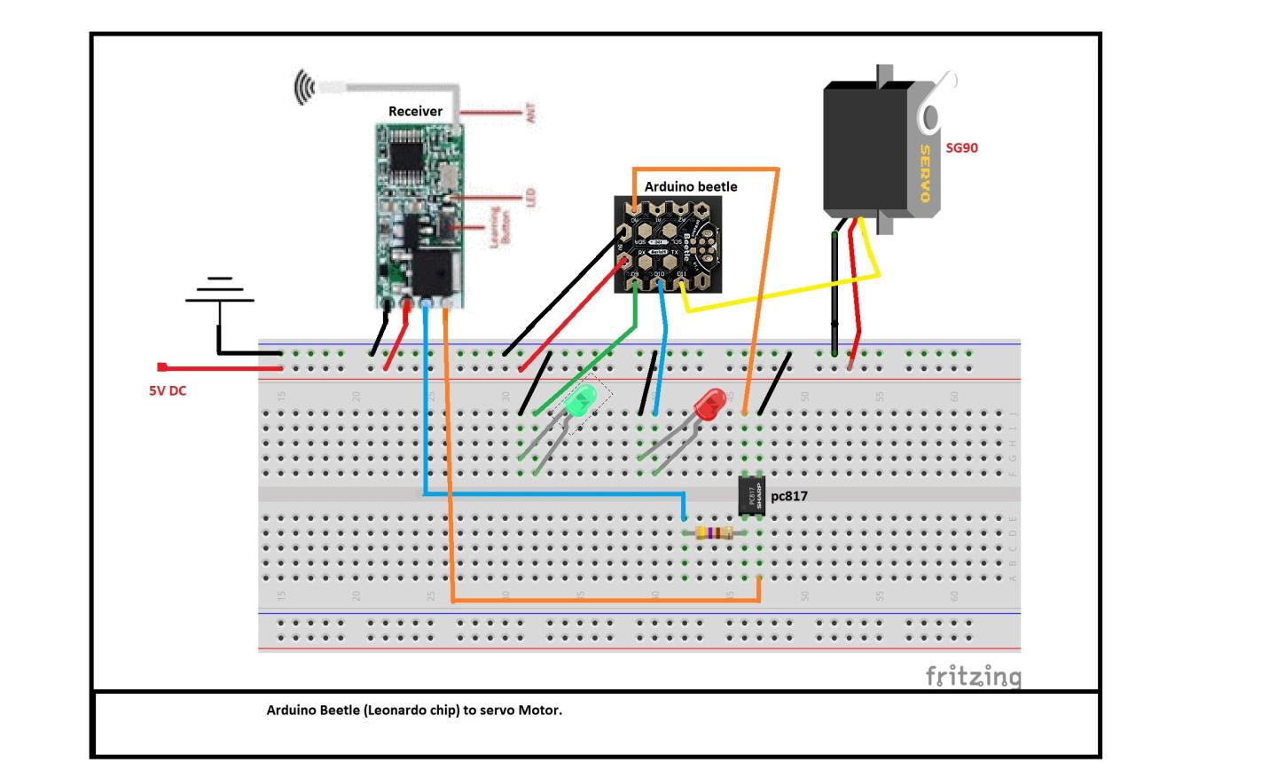

Research on single channel remote control transceivers that can send a signal to
a microcontroller
indicates that besides the transceivers found on Amazon
like the '433 mhz Wireless Relay 12V Long Range Remote Control Switch' referenced above
