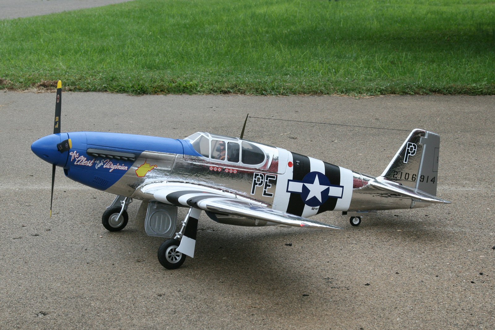

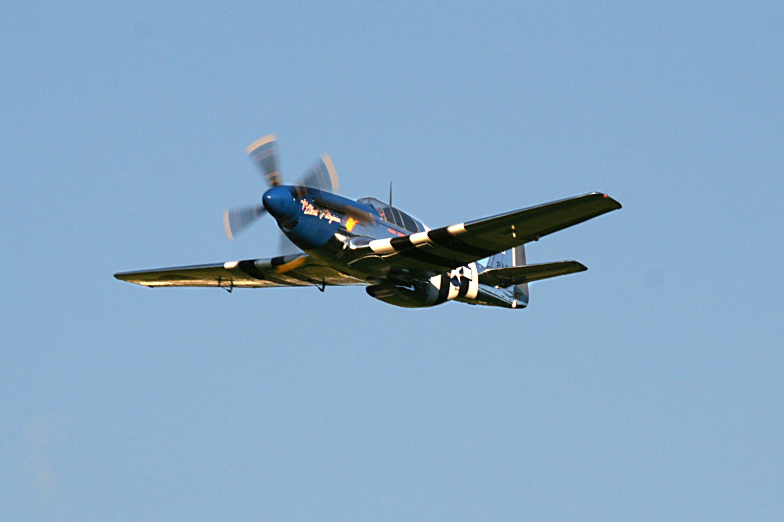

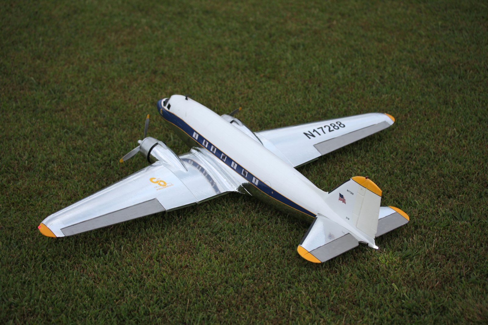

    This is my FMS P-51, covered with Oracal chrome polyester film. The film added about 140 grams to the plane, but it still flies great.

    That's a pretty darn good job on the chrome covering! Where did you find the chrome film?

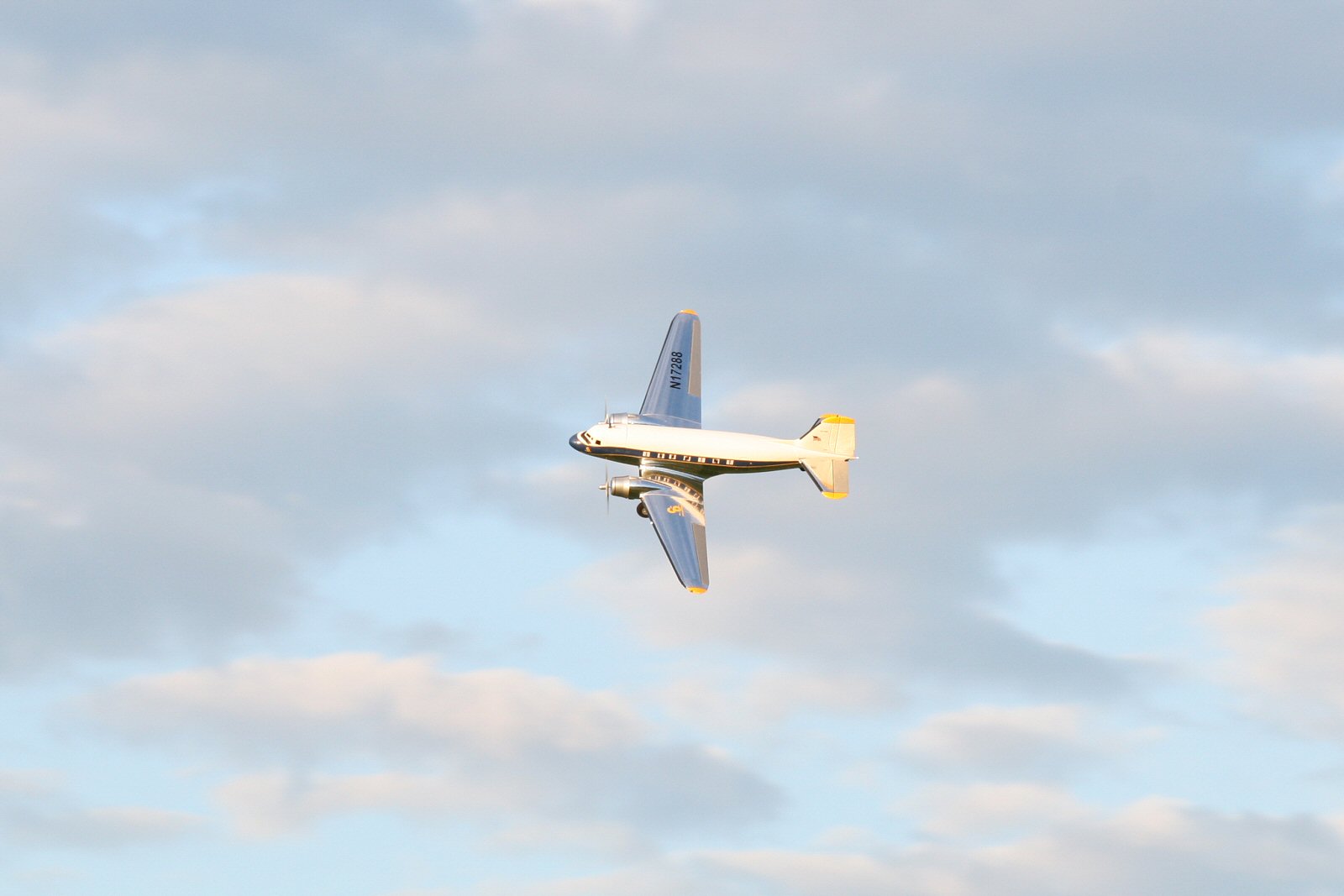

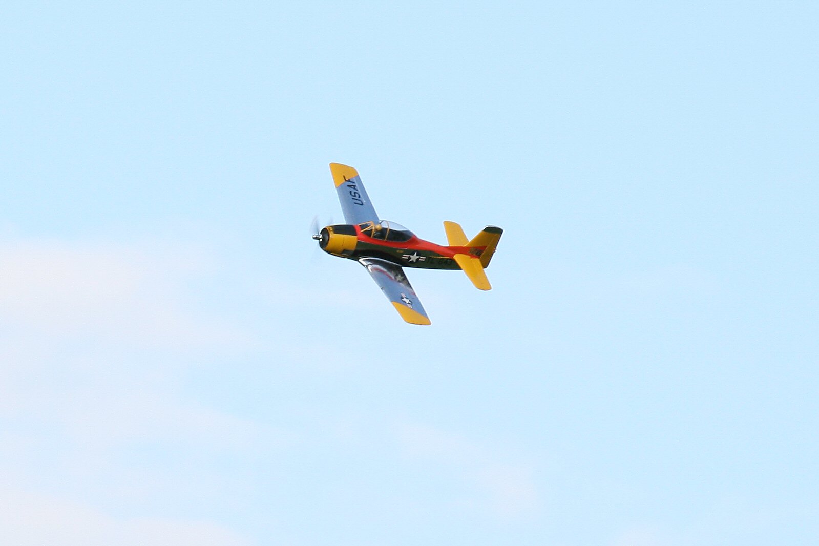

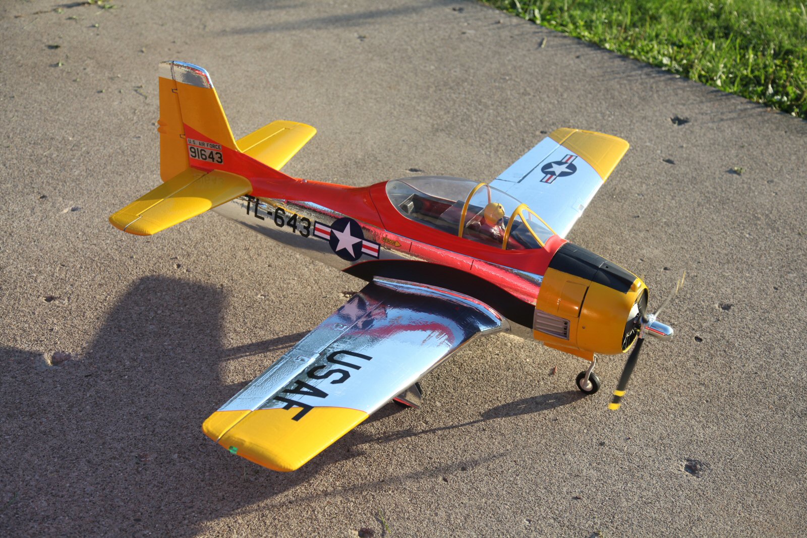

      It's by Oracal, they make vinyl and polyester film for signs and automotive wraps. I get it on line from Advantage Sign Supply in 15 inch by 10 yard rolls for about $28.00. There are plenty of vendors and I'm sure 3M makes a similar product. A roll will do a few planes. The film is peel and stick, self adhesive and I think it's easier to use than Monokote. You can use heat to work it around tight curves, but it takes a lot less heat than Monokote, so you are less likely to gator skin the foam. The Mustang is the third plane I have used it on. I also used it on a Dynam DC-3 and an FMS 1400 T-28.

        Thanks for posting your idea and the photos. I may give that a shot. I've never used any films such as monokote before, but if I can get that real plane skin look I think it's worth trying.

            I have to give you thanks for turning us on to this product. I have wrapped a few of my planes with Orocal and it really does provide the finishing touch. Like you I used it on the DC-3 and P-51b, using the old Eastern Airlines logo for the DC-3. I accidentally ordered the 2mm film initially, and found it difficult to hide the seams. Using the 1mm product is completely different, able to use small pieces on compound curves and having seams disappear, it is a very cool product.

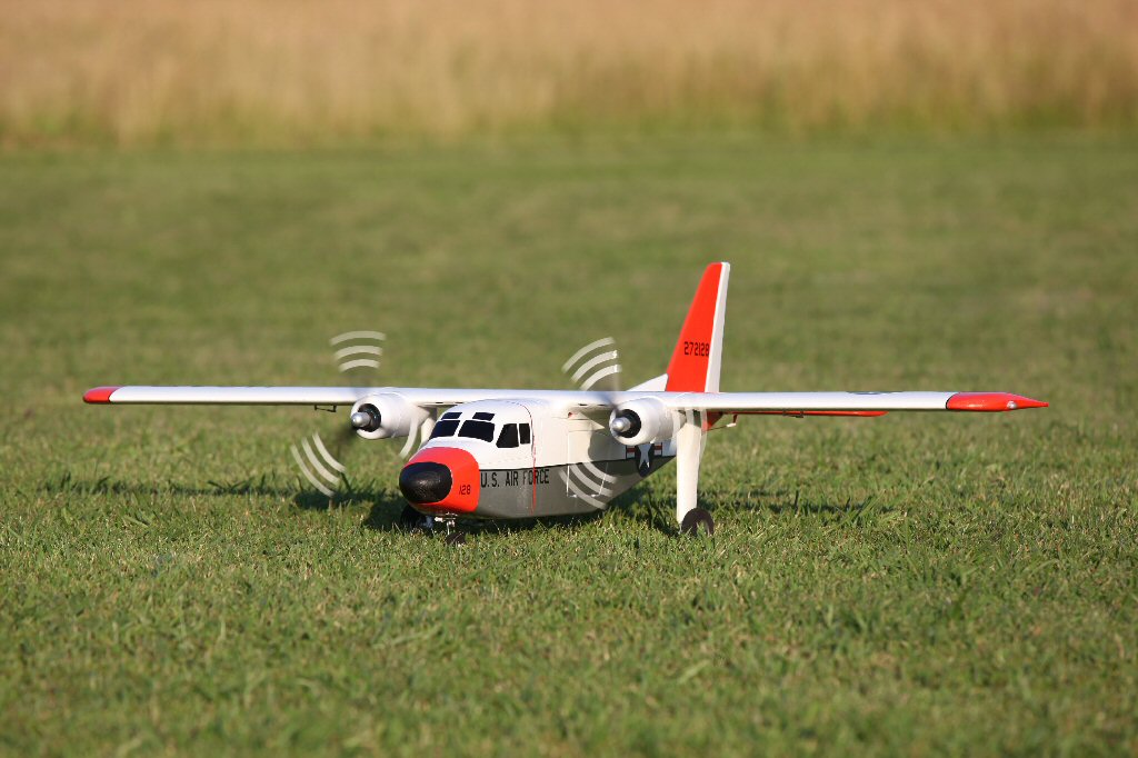

              To give you an idea of how it helps protect a foam plane, I purchased a Durafly SkyMule, but hated the decals that came on the plane. Even though if is not a replica of any real plane it is close to some and close enough for me to wrap it and decorate it in a fantasy USAF scheme.
              Last week I lost a prop just as I was taking off, full throttle, and the plane cartwheeled in coming to rest upside down. From where I was, I figured I'd be scrapping that plane, it was the most violent crash I have had in a long time. It was so bad at time you could see the USAF on the bottom of the wing, via a camera on top of the fuselage.
              When I checked the plane, the only real work was to re glue a nacelle back on a wing and repair some compression wrinkles on the nose.
              I firmly believe the vinyl film helped keep this plane from becoming a box full of foam bits.

                        The 351 is the metalized chrome, not vinyl. I think it is a Mylar based film. Very thin, but a little harder to work with than the vinyl.
                        The 751 series is 2 mil and I think very easy to work with. It comes in a lot of useful colors, but not in metallic.
