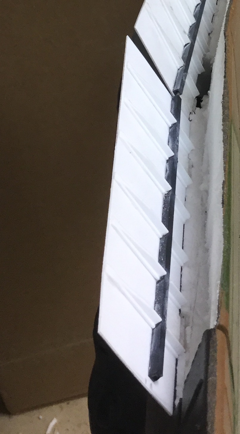

    The next part of the build was adding split flaps. People over on RCGroups had great success slowing down the model using small fixed flaps, but I opted for a more scale actuated version. I used 0.03 in thick styrene for the base of the flap, and a 3mm square carbon tube to limit twist. The "ribs" are plastruct styrene 1/8 in "T"s sanded with a taper. The flap sections are joined together by a small metal rod that runs between the square CF tubes of the inner and outer sections. It is glued on one side and free to slide in the other. Two 9 gram metal gear servos were used to drive the flaps.

                That's some fine work there, Delta. I really appreciate the work you put in to the split flaps. Those look really nice.
