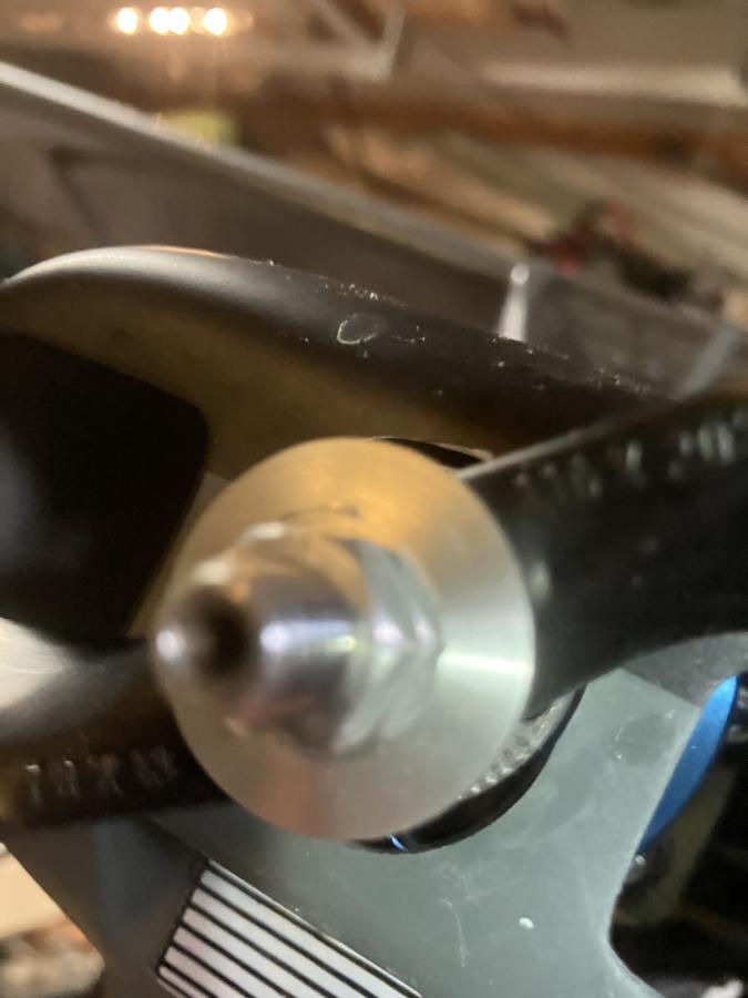

                  No it is on correctly Click image for larger version
                  and it never gets to flying speed grass is freshly mowed and not wet. I do not believe 6500 (which is what prop tach’s at) is enough for grass. Maybe concrete!

                        • 8819
                        It looks like your prop is on properly and is the correct pitch/length. 6700 rpm max for that motor and 4s fully charged battery is also in the right ball park. I'm at a loss for why it won't get off the ground. You can try a 5s BUT that's at your own risk. You may luck out or you may see blue smoke.
                        I've had a couple of Nexa planes and they seemed a bit under-spec'd. I only had success when I went from their recommended 4s to 6s.
                        No, I don't have one. Just trying to make some suggestions on what to check as I doubt anyone else here has one or will respond. I had a friend who had his prop on backwards and it couldn't get off the ground. Changed it around an it took off like a bullet. That's why I brought it up.
