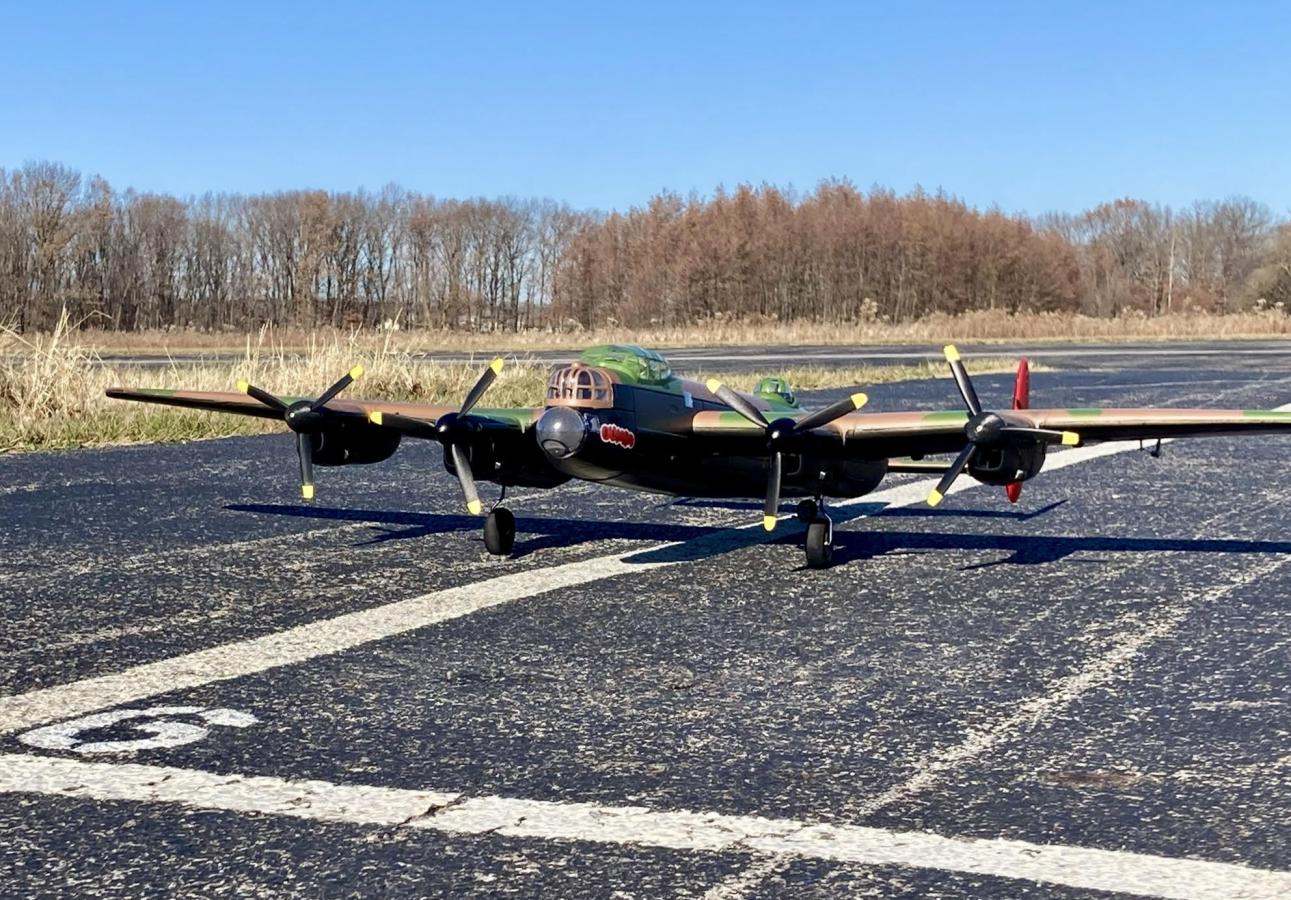

                    I have the HK Lancaster (I have two, actually, one for spares). As it comes out of the box it looks fine but is quite poorly engineered as a flying machine. I managed to fix mine up to be reliable by:
                    washing out the wingtips to help prevent tip stalling,
                    Addiing additional retaining screws and 3DP parts to the wing attachment (otherwise it can move around),
                    Adding the optional main retracts since I am not keen on hand launching it, and adding a steerable tailwheel,
                    Making the battery mount more secure,
                    Differential thrust to help ground handling,
                    3D printed collars around the front of the nacelles to fill ridiculously large ugly gaps between the nacelles and spinners
                    Integrating the differential thrust with the yaw stabilization from my AS3X+ receiver (this needed a custom Arduino, code available on request). This really helped with the ground handling.
                    As with all HK models, its availability comes and goes, and the spares situation is abysmal.​
                    If you're prepared to make the effort and to deal with the vagaries of HK, you end up with a nice model.
