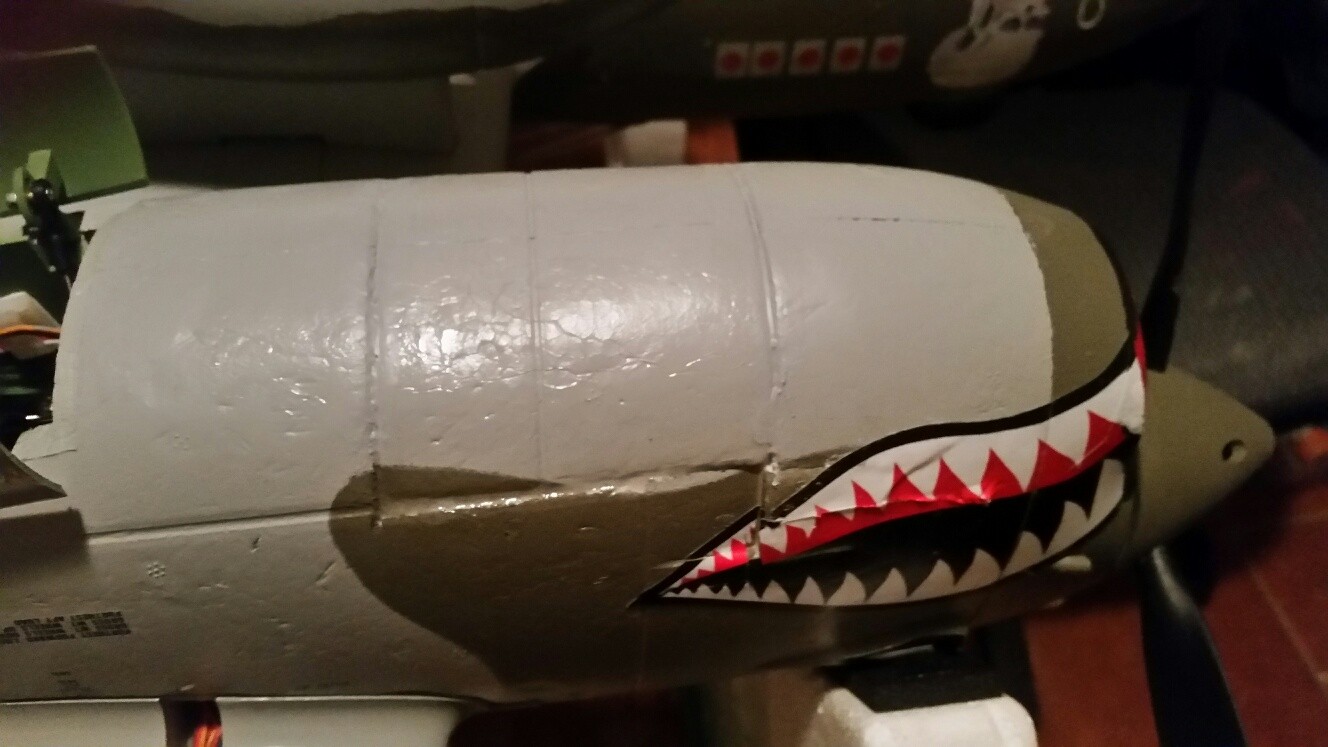

      Yes, I did and sorry for not seeing your post sooner. Been awhile since I was here. I did cut into the 1st and 3rd panel lines behind the boom nose (see photo) and removed the panels. You can see the horizontal cut as well. I then glued the speakers, face down into the bottom of the booms behind the motors. The panels were easy to cut away with an exacto blade and made for a very good fit afterwards. I used foam tac to reapply the cut outs. Hope you can see the cut outs in the pic. Then I glued hardwood sticks under the ESC's to keep them above the speakers, as the speakers do get hot to the touch. I have read posts where a plane caught fire in the air because of the ESC's overheated, due to being in contact with the speakers. I put the sound card under the canopy, but had to do some minor alterations to fit it in when the canopy is locked in. No biggy there. One of the fun parts, was to turn it all on and adjust the start up sequence to the throttle on the TX. (I have the Graupner MZ-24 Pro). Haven't quite got it JUST right yet. There are posts about how folks have done this and it's been awhile since I last posted. I tried playing with the throttle trim and a knob on my TX, where the motors will start as soon as the sound startup sequence starts on the MrRc Sound system. It's a "play around with the set-up" thing in my configuration. Have fun with yours yours!
