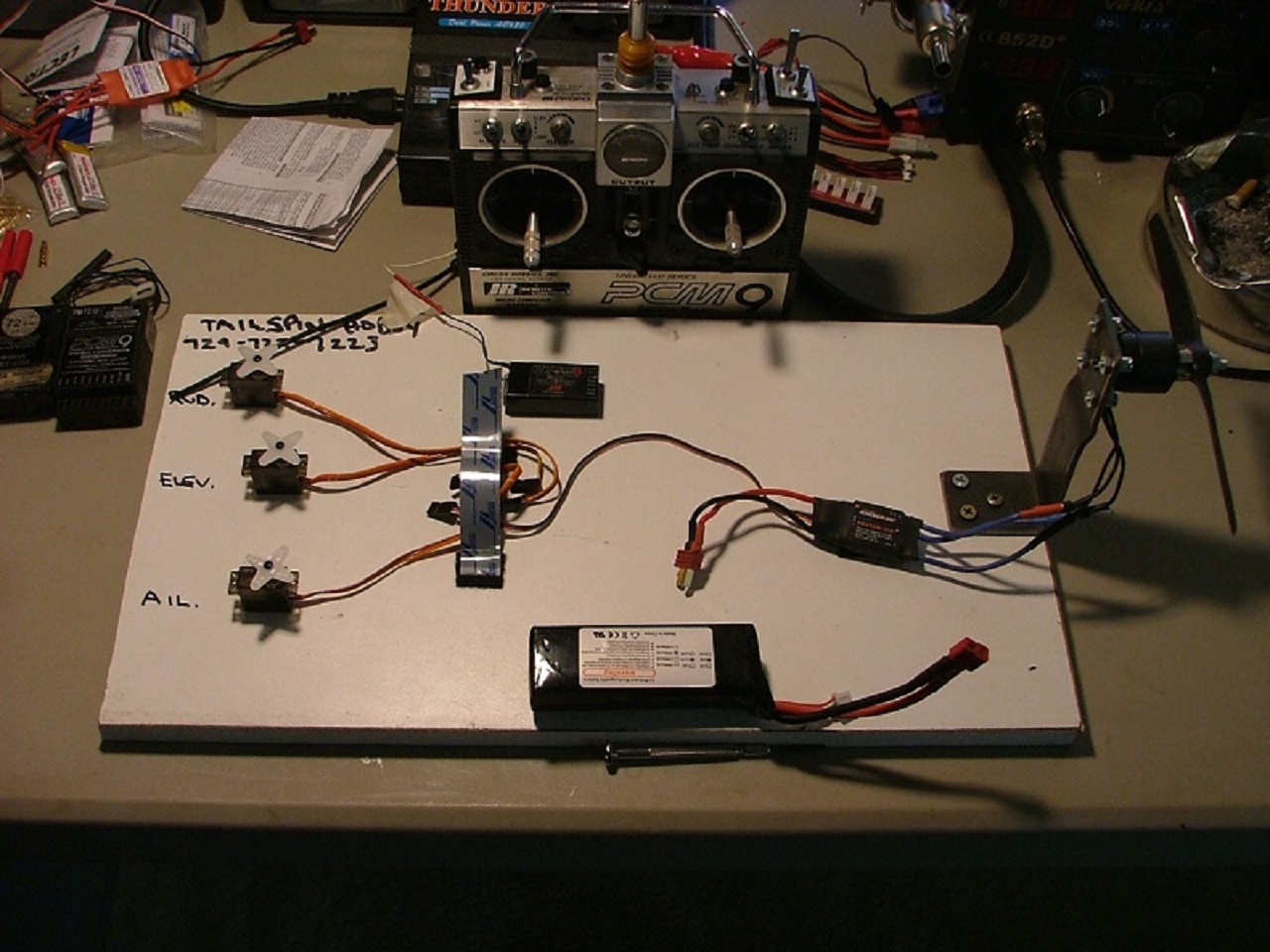

        I used to go out and just start buying replacement parts. But as I collected more and more spare parts in the bin, I had the ability to do some testing before buying stuff. I've bought so many parts only to find out that "that wasn't it". If you had a known good motor, you could have tested the "damaged" ESC to make sure that's what was wrong OR taken a known good ESC to see if things started to work. You don't need the exact size or type of part just to do a test.
        • yorkiepap
          'ol fart still flying...
          • Aug 2014
          • 190
          • SW PA
          An easy to make problem solver is a simple "test station". I made this up to check Rx's, ESC's, & motors. This helps even for new models if a component seems questionable. Pic attached...
