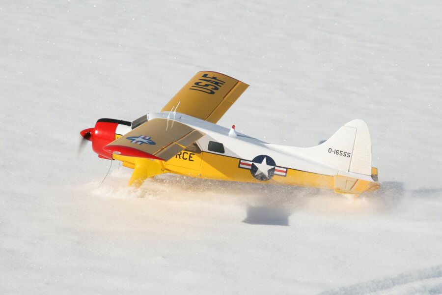

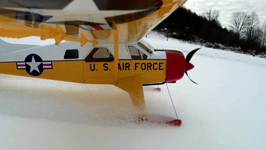

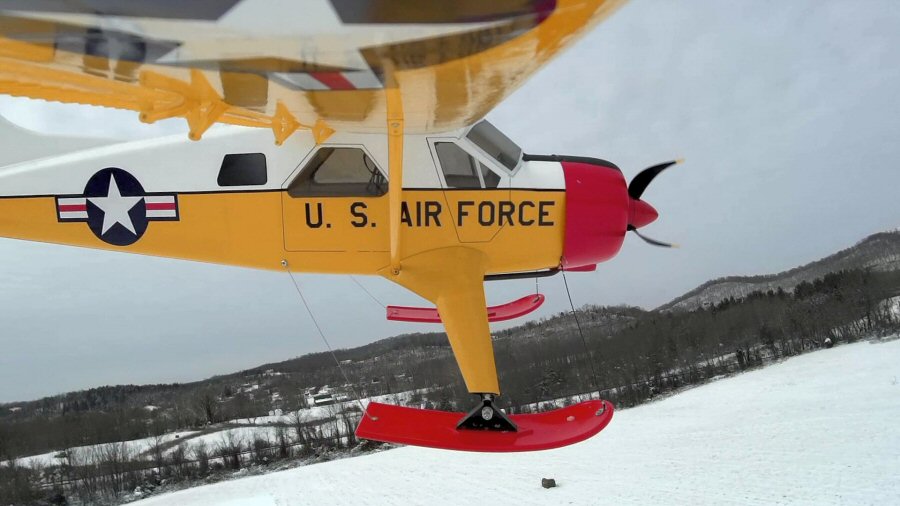

    The more I fly this plane, the more I like it. It really does it all. Flies great from land, water and snow!

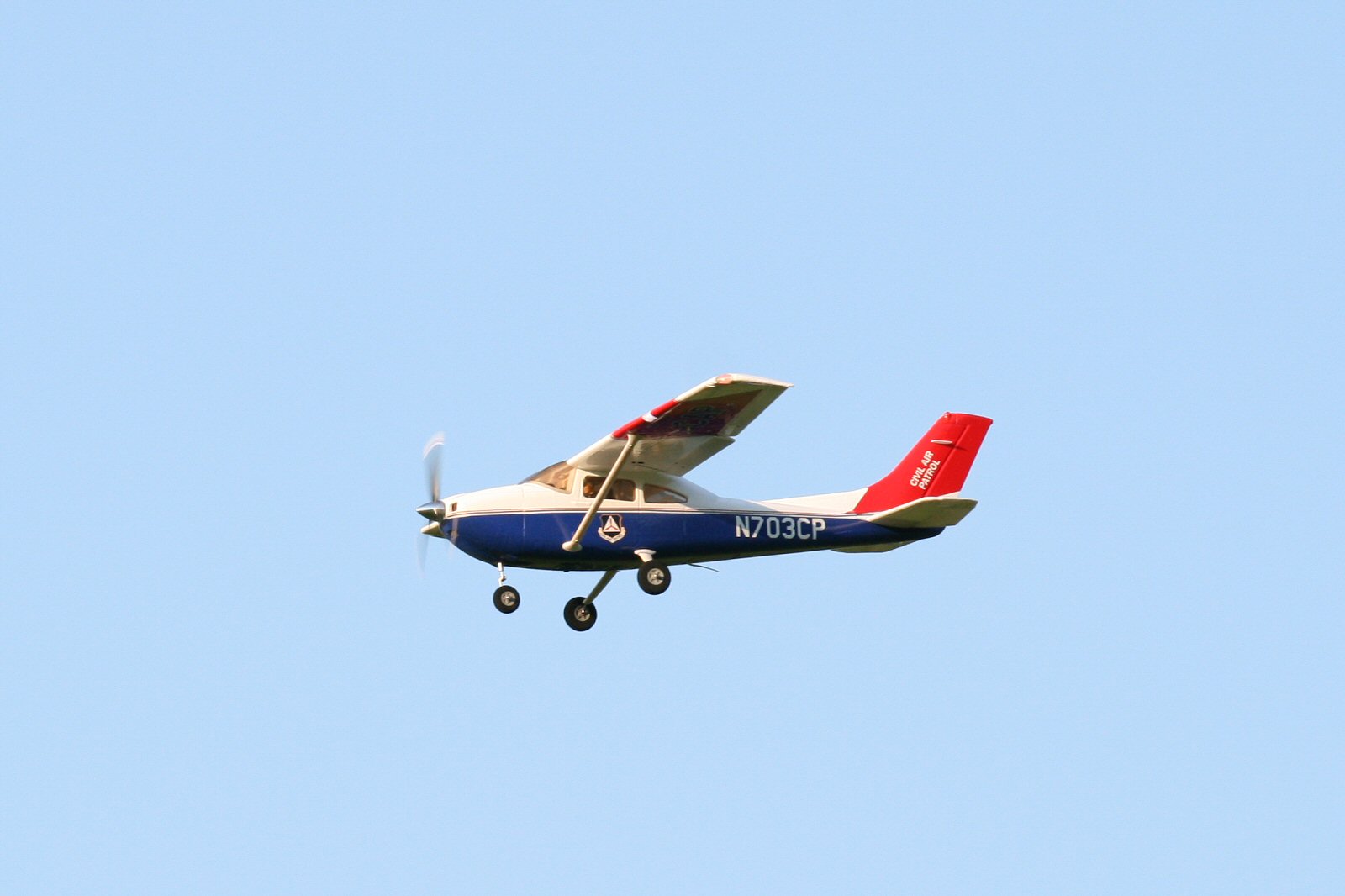

              My planes are not Top Gun show winners. But from a couple of feet and in the air they look as good as any at my field. A big plus is that the film protect the foam from bumps and scrapes. My FMS Cessna has been covered for over two years and has close to 300 flights on it. It still looks very good on the flight line and in the air.

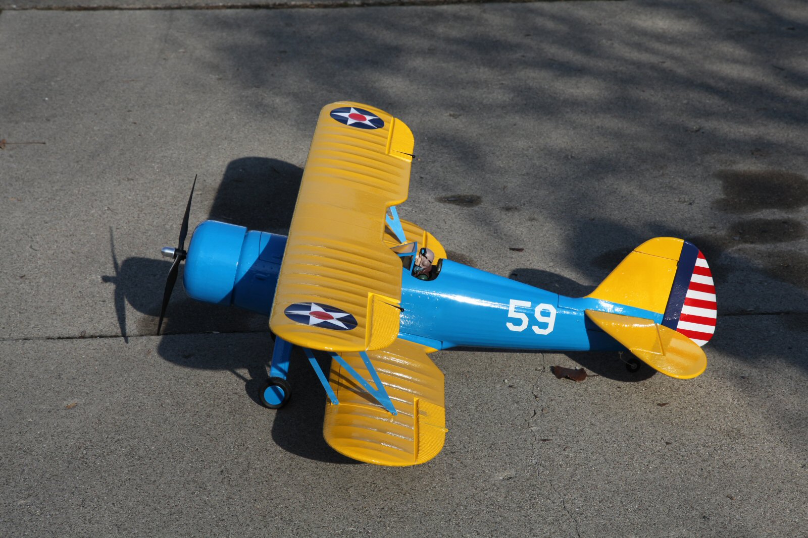

              FMS Cessna 182 covered and lettered as a WV C A P craft.

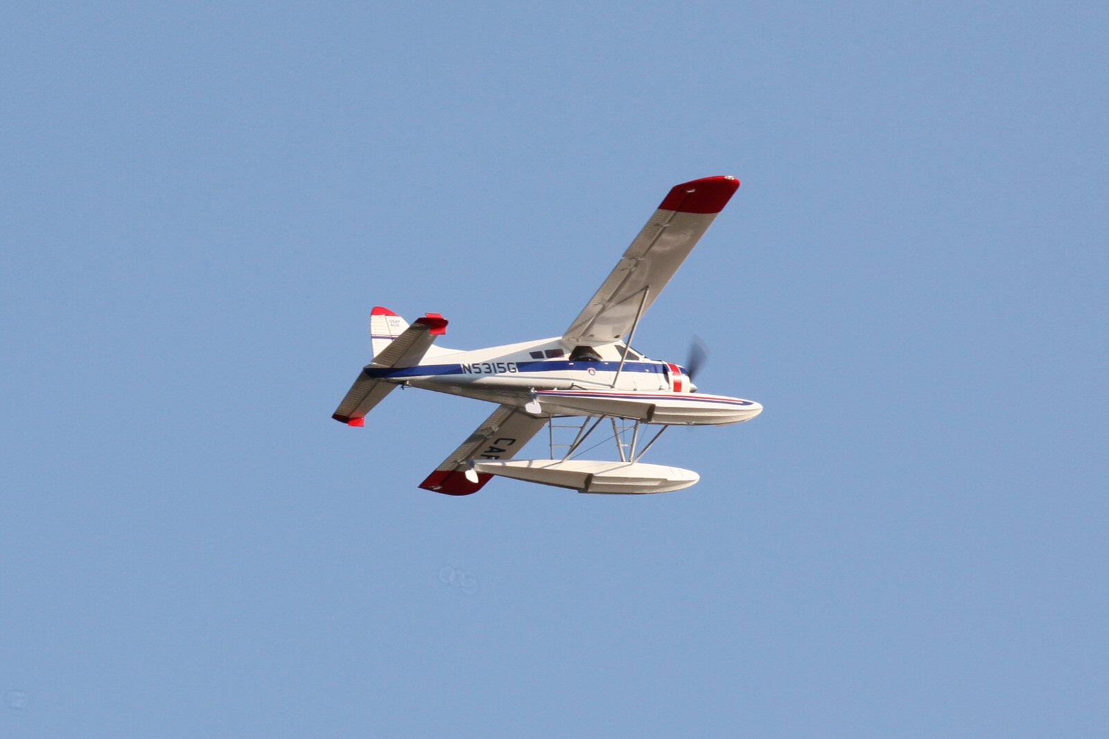

              My first Flyzone Beaver, covered and lettered as an Alaskan CAP plane. The floats are also covered.

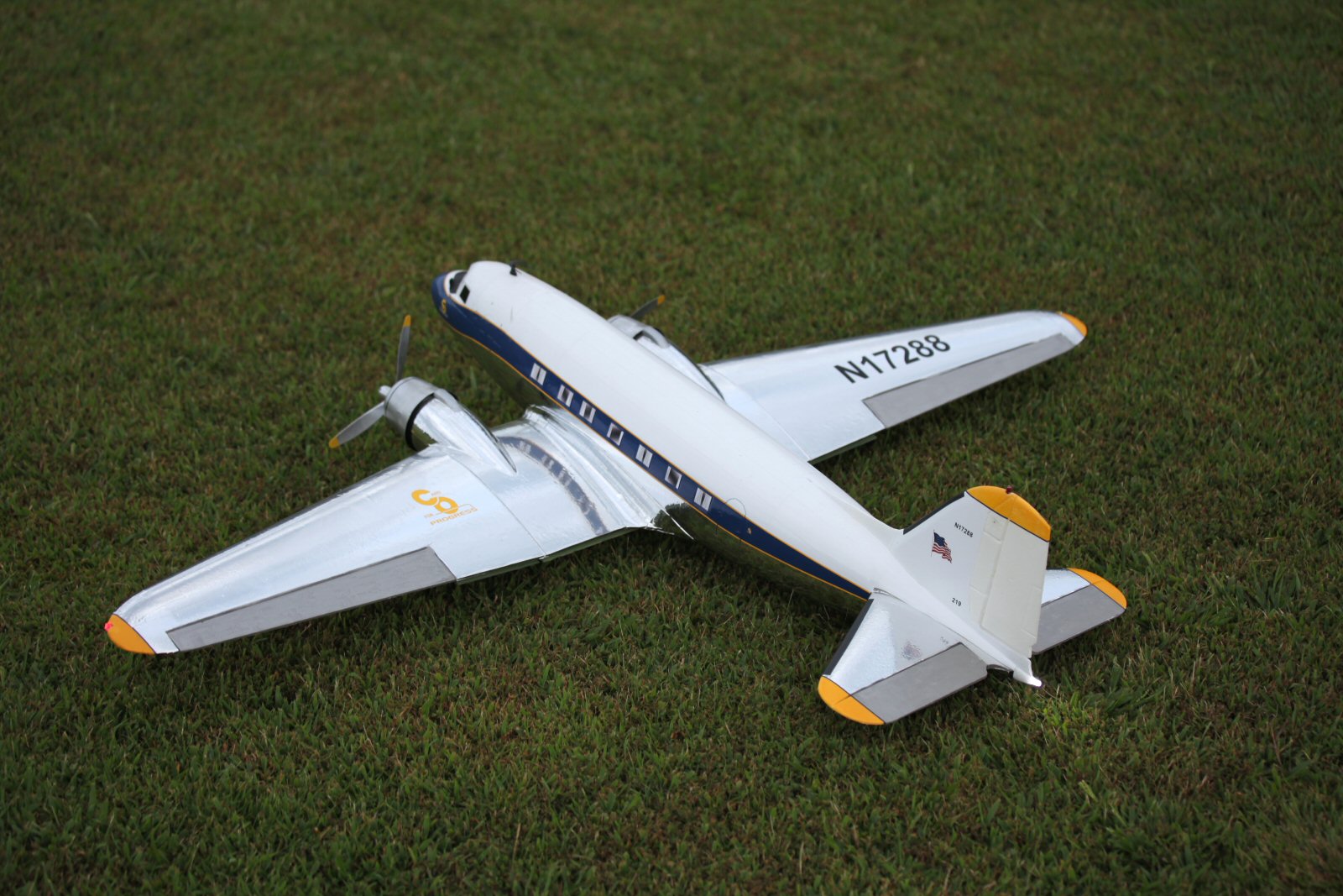

              Dynam DC-3 covered with blue, white and chrome film.
              Dynam WACO covered as a PT-14.

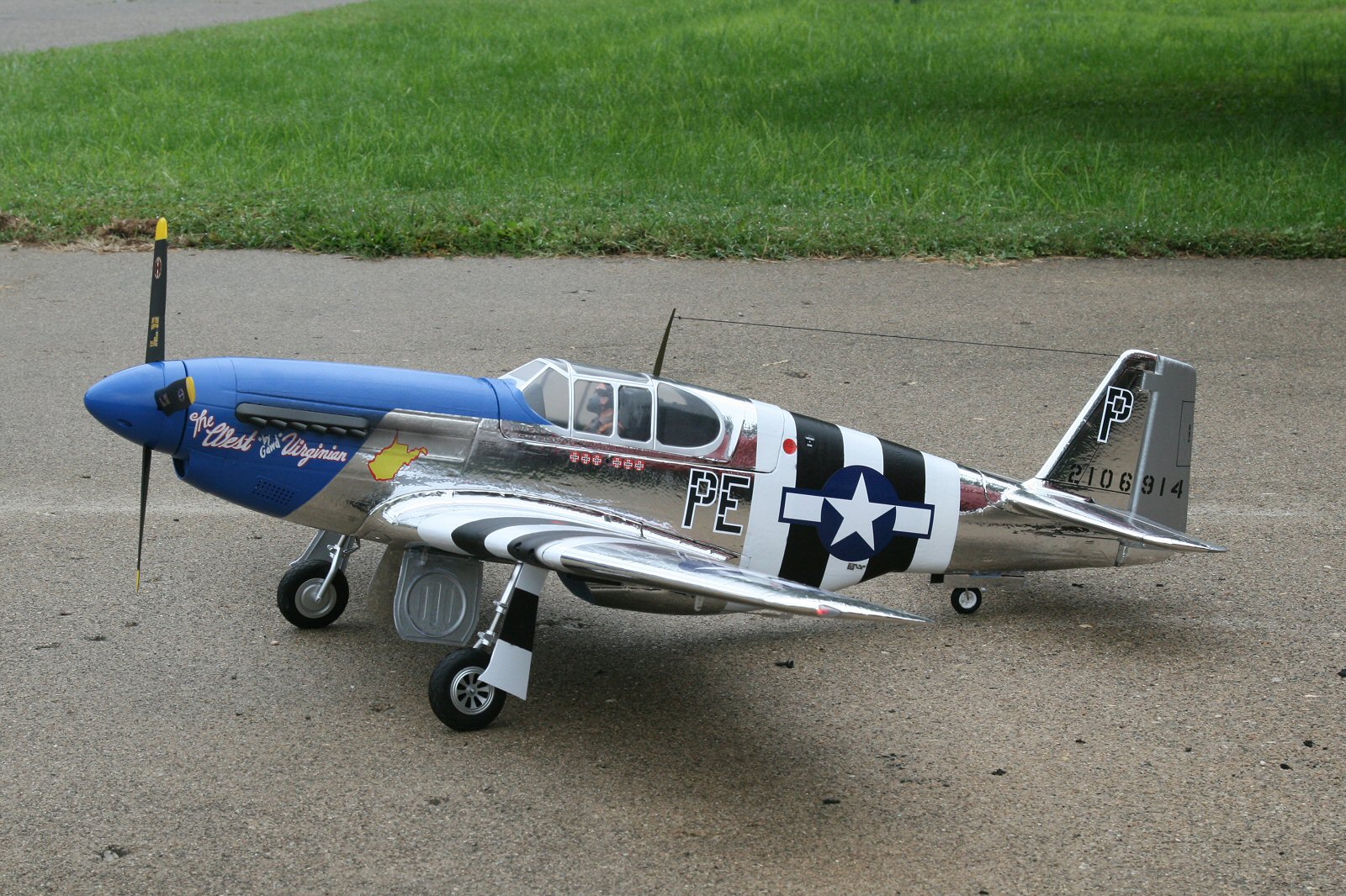

              FMS P-51B covered with chrome and white, the black stripes and blue nose were painted directly on the vinyl.
