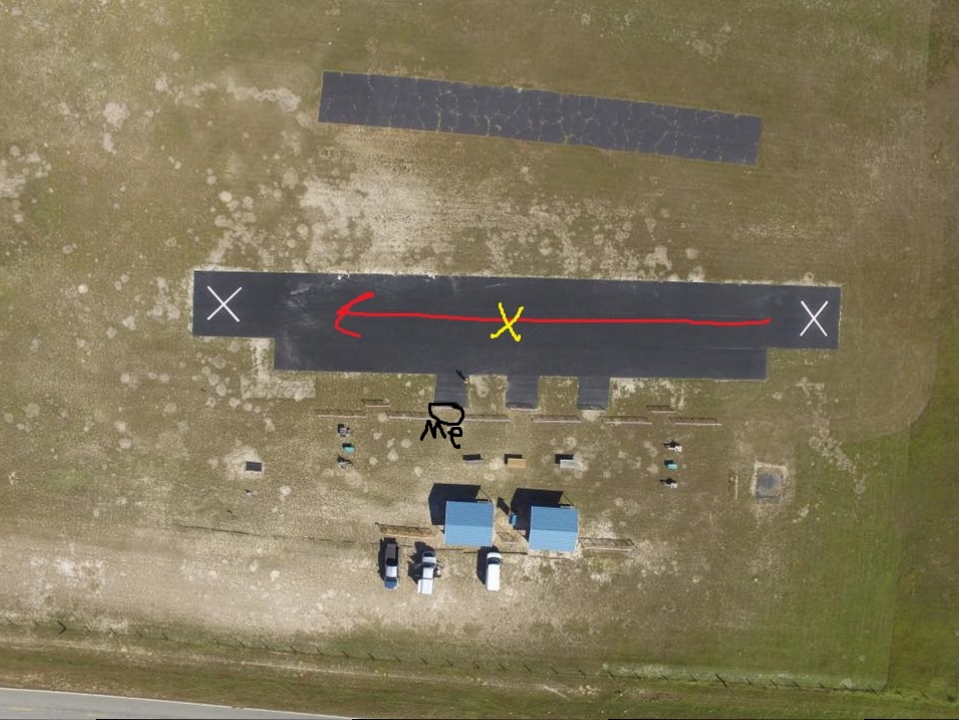

              Another thing I found out was that my depth perception sucks, lol. I was at the far left stand landing right to left. We have a 300ft runway, and it is still in the air when it gets to me(over half the runway missed) so I just cut the power. I'm thinking I need to be closer to where I should be touching down to allow the proper rollout and not cartwheel into the grass.
              The "X" is usually about the area I "land" it.
                That will help until you "learn" the landing, I have a couple planes that have taken me awhile to get the landing right.

                  WinterSol & Tirediron both have shared great advice. If you "just cut the power" because your running out of runway, it's almost a sure bet your going to land hard. Remember this in those situations, don't accept it as the only option but to cut power in order to land before the end of the runway, and "boom" you end of with a HARD landing. You do (with exceptions) have the option to power up and go around. Make adjustments/changes to what just happened, and make a good landing. Just this last weekend with both my P-38 and F-86, I came in a little long or fast. And instead of just cutting power to try and touchdown before the end of the runway, I powered up and went around. Then had a great landing. And like Tirediron had mentioned, with the P-38 if you just cut power, she will drop like a rock!! (Not so much with the F-86)

                                Reading the posts above I see several of you are suffering from the depth perception issue. I have the same problem too. This happens because you focus on one point for a period of time, and this in turn produces tunnel vision. The problem gets worse with age too.
                                With the above in mind when you bring the model in for landing things are out of perspective. Normally you land short because of this issue, and you were absolutely positive the model was on the runway.
                                The next time you fly, try the following. It works for me. When you have the model set up for a landing and you are on the final approach with the wings level. Momentary take your eyes off the model and focus on the end of the runway and then back on the model and you will find it all come back in perspective as to where you really are. At this point you may need to open the throttle slightly to bring the model closer. It will not be where you thought it was.

                                  Well I went back out yesterday. First battery, 4 landings. 2 great ones, 1 average, 1 rough(but not nearly as rough as before)....Second battery, 2 good landings then met a tree. Guess the wind pushed me further than I thought, or like Martin said, I got so fixated on the aircraft I lost all depth of my surroundings. 40 foot drop onto the landing gear, and survived with only 2 small cracks on either side of the landing gear. My first crash :)
