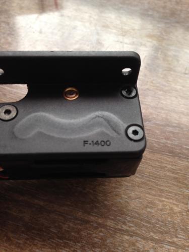

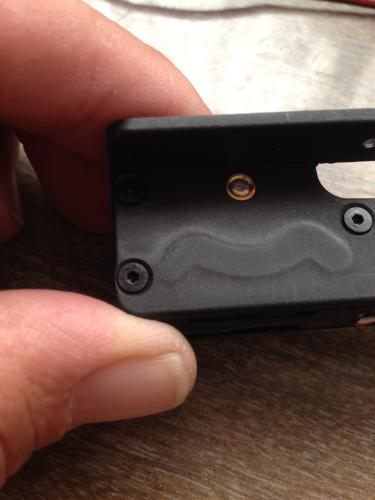

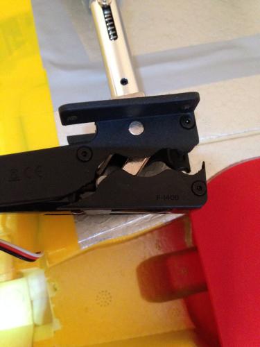

    hello everyone. PLEASE CHECK YOUR RETRACTS if you bought a new V8 P51. My retracts broke at some point after 5 flights on my brand new mustang. It seem there is a defect on the side casing of the retract. There is a squiggle mark on both sides like this ( ~ ) . As you can see in the photos mine broke at the squiggle. The replacements I had to buy because Motion wouldn't replace them because I flew the plane are cracked at the same exact same place out of the box. Please check them.
