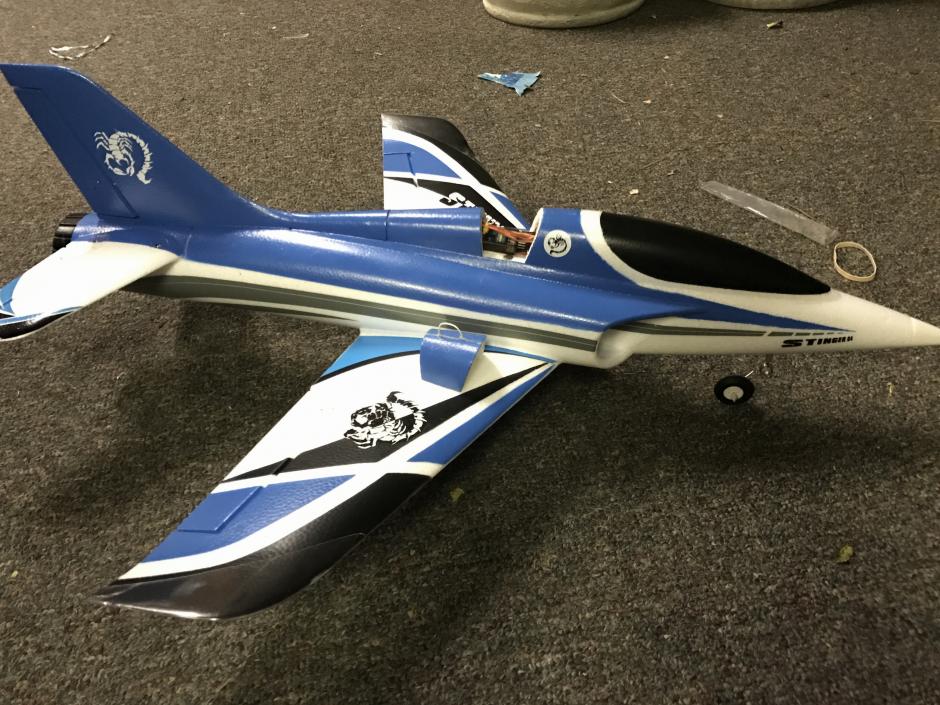

                            EDFs have a power lag that has bitten me more than once. On final with my propeller warbirds, I typically modulate throttle to control my glide slope and, depending on the model, I may be able to completely pull power until over the numbers. I did this with an EDF and quickly found that getting the power/thrust back had a delay I was not used to. This resulted in a lot of bouncing and repairing landing gear.
                            I've been flying warbirds for years with good success but I quickly destroyed an innocent FW Panther during my learning curve. Hand launch stalls were my nemesis and resulted in bulk FoamTac then ultimately taps.
                            I'm giving EDFs another try. I have an assembled and ready to maiden 64mm 3s Stinger on the bench. Like you, I've heard it is a great flyer with tame habits. I've installed the LG....see previous comments about failed hand launching. Hopefully the weather will allow the initial flight soon.
                            Good luck, let us know what you decide to buy and how it goes.
