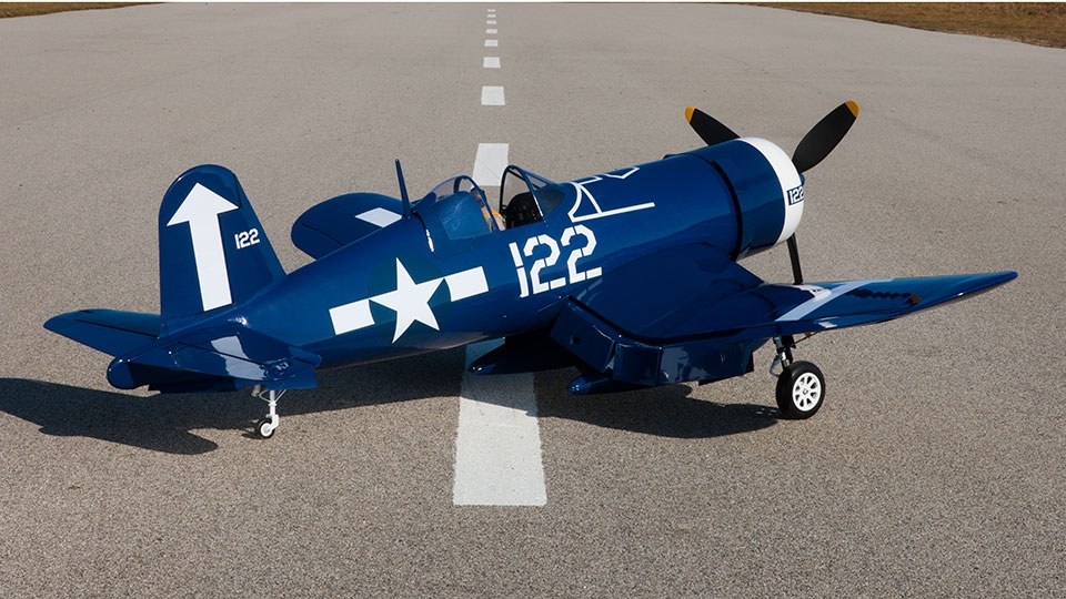

    I've had my eyes on that gorgeous Hangar 9 60 F4U Corsair ever since it came out. It's meant for gas but can be converted to electric. If I do pull the trigger on it I am going to go with a Power 360 Brushless 180Kv motor swinging a 24x10 Biela 3 Blade prop. I've only seen one guy do the electric conversion and it turned out great. Does anyone have experience converting giant scale gassers over to electric? If so, care to share any tips and tricks you learned along the way?

                I'm sure you have seen the RCG (I think) post of a gentleman that did the conversion, and the 1-2 flight videos on YouTube. I think in one post he included templates for building a battery box directly on the front of the firewall, and mounting the motor /ESC.
                He was able to Cog the airframe with a 12S 10000mah setup (4 x 5000mah packs).
                A similar system is used in the Hanger 9 P-51 conversion. https://youtu.be/wOPqCaJnlPM
                If you are looking to stretch flight time further, look into a 14S setup. Motrolfly motors, http://www.subsonicplanes.com/Motrolfly_Motors.html will custom wind, so you can really tune the power system for best performance/efficiency with the scale prop.
                The off the shelf solution other than Eflite would be to look at the big motor from Extreme Flight, I think they all are based on a 12S setup.

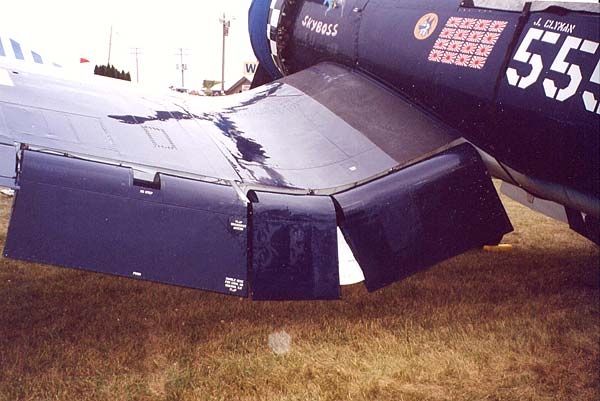

                          IF FlightLineRC or Freewing was to ever attempt a scale Corsair, surely they would make sure the flap's LE's are curved, right Alpha? LOL ;)
                          Every time I see a R/C Corsair with hard edged flaps it makes me want to chew glass! :Scared:
                          Click image for larger version  Name:	f4u-1d-corsair-flaps-555-07.jpg Views:	1 Size:	138.8 KB ID:	63461
