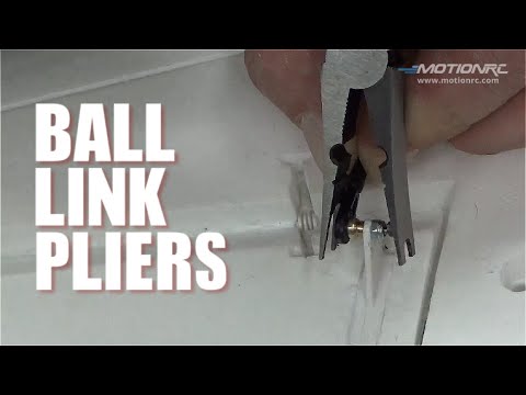

              It probably wouldn't hurt to make a very small investment & get a ball link plier.....certainly cheap enough.
              Denny
              Only US$14.99, buy best ball link plier rc helicopter airplane car repair tool kit tool sale online store at wholesale price.

                  A ball link plier was my next suggestion. Much safer than thumbs, IMO.
                    • 8750
                    I'm not clear on what's being asked here. Are you saying that you "snapped" the ring (circle part) of the control rod over the ball? Isn't that what you're supposed to do? How else is it going to go on? The ring is supposed to have some expansion capability in it. Ball link pliers are the best tool for the job but I've been also known to pop them on (and off) with needle nose pliers when ball link pliers just won't fit in some tight spaces. As long as the groove inside the ring and the ball itself is not damaged and nothing else cracked, I'm not too concerned. Or did I misunderstand something here?

                      I agree with xviper2. I did a short early stint with helicopters where ball links are commonly used and you do need to snap them on whether with ball link pliers or by hand. The whole idea is that the ring "rides" on the side of the ball so the link can function smoothly at different angles. If you were to remove the ball and then reinstall it "through" the ring it really wouldn't be installed properly because the ring would actually be "below" the ball rather than around it. As the "ball link plier" video mentions, they actually are designed to snap on only one way. If you look VERY closely you can usually tell that one side of the ring is VERY slightly wider and that is the side that should be snapped over the ball.
