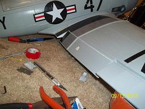

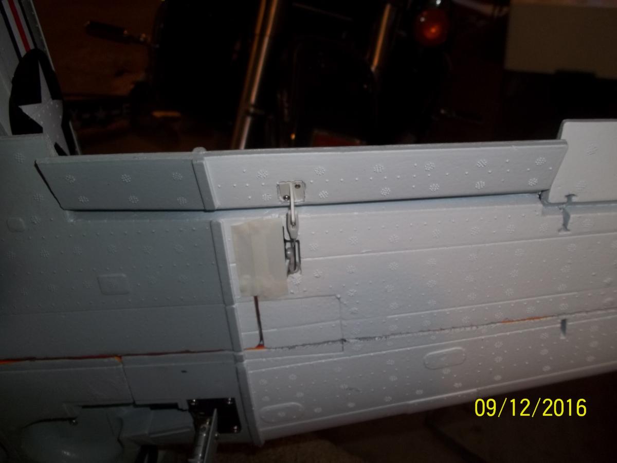

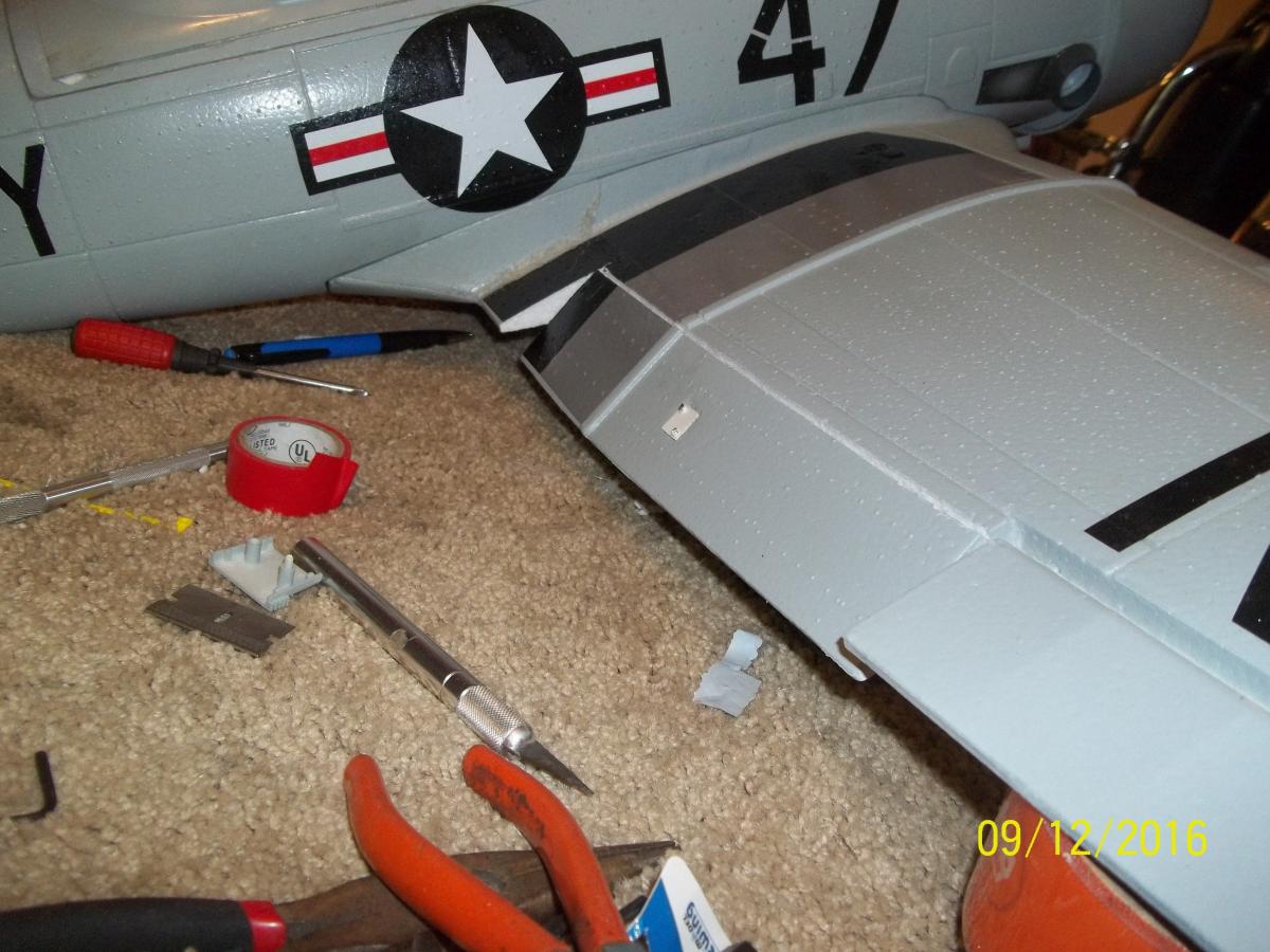

        Here is how I did the flaps on my Freewing Texan
        Dont cut all the way through the foam, that way you can use the foam as the hinge
        Hope that helps
