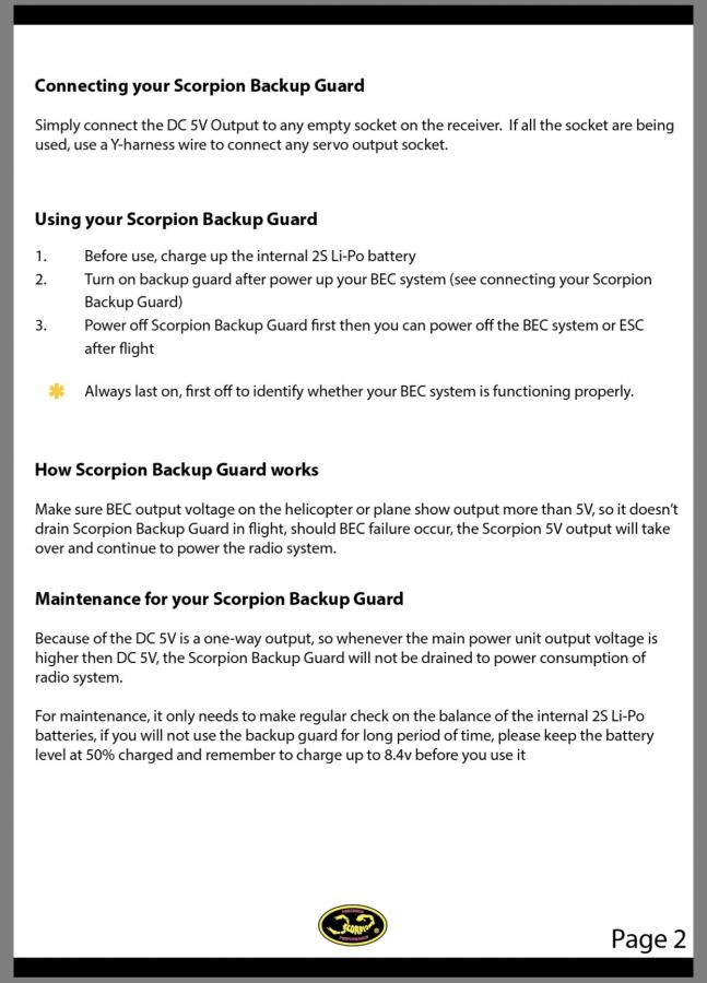

    One goal of bringing up the voltage conversation regarding the BUG activation is that the stock BEC on some equipment including the Freewing 1700mm A-10 PNP jet is set for 5V. Since the manual that comes with the BUG states that it will activate at 5V and lower, the stock BEC may (and likely) not be sufficient to use with the BUG. If a voltage drop is seen during times of dropping down the gear with full flap input simultaneously, etc., the BUG may activate too often since the BEC voltage and BUG activation are too close. That's why going with a different external BEC that can be adjusted to a higher voltage than the BUG activates, such as the voltage you stated as example (5.5V), may be a more consistent and safer bet to keep the BUG from being activated when a person doesn't want it to be. As long as the voltage chosen for the external BEC is still safe for the rest of the electronics in the chain, it should be good to go.

            Your absolutely spot on. Using the BUG with the "stock A-10" UBEC is not a viable voltage backup source.
            I learned that on the maiden flight of the A-10 and found that the Scorpion had been initiated due to a system voltage drop most likely caused during the retract process and found that it continuously occurred with every flight afterwards until swapping in the ZTW where it was set to the 5.5v as indicated in my earlier post.

                  Originally posted by Porkster View Post
                  Mine will not activate unles I jam the retracts in which case it activates then switches back to normal once the system recovers and the motors powering the gear shut off.
                  Am rather confident that you must be using another device other than the Scorpion.
                  The Scorpion sits in a monitoring mode of the system voltage until it falls below the turn on set point of +5vdc and then turns on providing +5vdc to the system.
                  Once it turns on it does not reset back to the monitoring state of the system and continues to stay powered on even if the system goes back above the set point level of 5vdc.
                  This can be a trepidus situation if the BEC's switching circuitry doesn't play well with parallel voltage sources.

                              Originally posted by Legman01 View Post
                              I used the Scorpion Backup Guard in my FW A10 today for the first time. After a 2:30 flight, the BUG and BEC were both very hot! The BUG battery cells went from 4.2v down to 3.8v on this flight, so I figure it must have been activated since gear retraction or earlier. Without the BUG in use, the A10 BEC just gets warm, not hot.
                              Tried the BUG in another plane (xtreme Flight extra 300 on 4S) and it stayed cool the whole time.
                              Thinking I'll discontinue use use of the BUG in my Hog and look for a better "insurance" option!
                              Hello Legman,
                              The BUG was kickin on because the Hogs stock UBEC is only a 5v output and the turn-on threshold of the BUG is set for the same level so it was doing it's job basically the instant you turned it on and was fighting with the stock UBEC for voltage control(That's what switching BEC's do).
                              The BUG is a great insurance option if you use a BEC that has a higher voltage output like 5.5v or 6v.
                              I'm using the ZTW 10A UBEC on my Warty and several other birds that have the BUG in use on them.
                              https://www.motionrc.com/collections...w-10a-bec-ubec
                              I set the voltage output jumper to 5.5v on the ZTW and the BUG stays deactivated until the system voltage truely collapses to/below the 5v threshold the BUG was designed for.
                              Hope this info helps guide all those inquiring minds.;)
