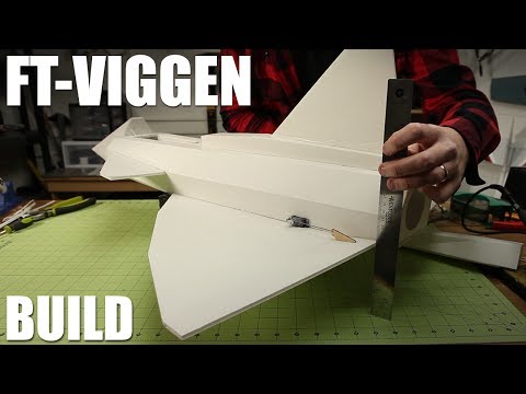

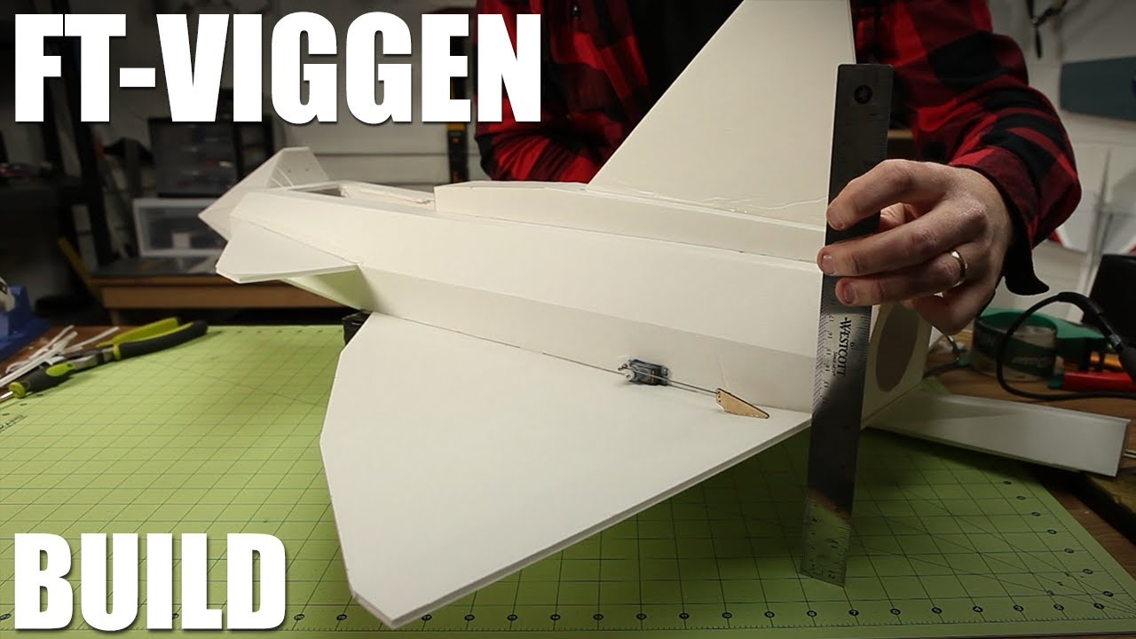

    I honestly can't remember now. I no longer have this plane but I do recall that on the kit version, it's marked on the wing with an "X". If you downloaded the plans and cut your own pieces, then it might be indicated on the plans with the "X". Here's the YouTube build video and it might give you this information somewhere in there.

      Found it, approx 55mm from the forward edge of the main wing (the foamboard part).
