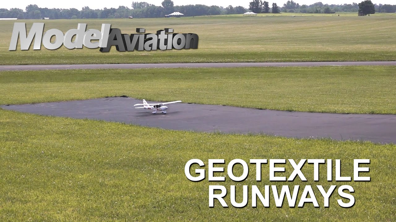

          The best solution for your dilemma is using Geotex to put down your own runway. Then if its not your property you can just fold it back up for the next use.
          With this solution you would be free to fly any EDF your heart desires.

            Wouldn't all grass strip clubs love to benefit but @ a $5k entry structure(cheapo) and more like a nominal $10k as mentioned in the video puts this out of range for most :(

                  I used to belong to a club that had Geotex runways and it was a huge expense. Granted, for just laying out a short, narrow strip for take off, the cost would be much less but still up in the thousands of dollars. You don't just go up to a possible runway and roll the stuff out. The ground must be somewhat smooth, without large tufts of grass or dirt. If the grass is too tall, after you pin the material down, you'll still have lumps all over it like a quilt. Some extensive "rolling" will be necessary. Even permanently installed Geotex require re-rolling every couple of years, especially if you leave it over winter months (where you get real winter). Then there's the pinning and un-pinning. My old club had a 12" pin every foot. If you are alone when you go fly, this is not something the average person would want to do just to fly a few jets. If it's your property, you'd likely leave it there all the time. Weeds, grass and settling dirt will make it look like a quilt again. Then there's gopher's and moles and what they can do. If it's not your property and you can't leave it down for periods of time, how many will haul this around every time they go fly? If alone, not likely. If you've got 1/2 dozen friends, trying to coordinate all of them for the same time will be infrequent.
                  That video made it look too simple. We saw quite a few guys in that video. How many more were there not in frame that helped out?

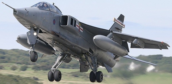

                      This thread had me thinking of what other military jets would be a good candidate for operating off grass. After a while the Sepecat Jaguar came to mind. Its landing gear was specifically designed to handle grass and unimproved fields as well as providing more ground clearance for big tanks or ordinance.
                      Click image for larger version  Name:	Jaguar.jpg Views:	1 Size:	50.0 KB ID:	99682
                      This video shows it flying off grass.

                        But you must realize that's on a "real" jet. Translate that into a model and those double wheels become smaller wheels, as opposed to a single larger wheel. On the real plane, the rough ground and grass wouldn't come that high up the tire. On a model, tall, plush grass could bury those tires. It's not ground clearance that matters to a model, it's the ability for the wheel to get rolling out of thick grass and to roll through the grass and how much power there is to push it through the grass.
                        For grass operations, if you've got little wheels, you need lots of power. If you've got low power, you need big tires. One great example is the Freewing 70mm Yak 130 running on 6s. It's got tiny little wheels, but it has enormous power to weight. It doesn't get bothered by thick grass. Now, take the Freewing 90mm F-16. It's got fairly big wheels compared to the Yak, but it's a heavy plane and it's sinks into the grass. On pavement, it's fine, but on thick grass, it can't get rolling fast enough to take off effectively. It can barely get out of the way of its own shadow. It's somewhat under powered for its size.

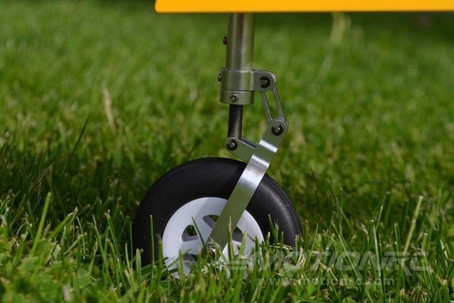

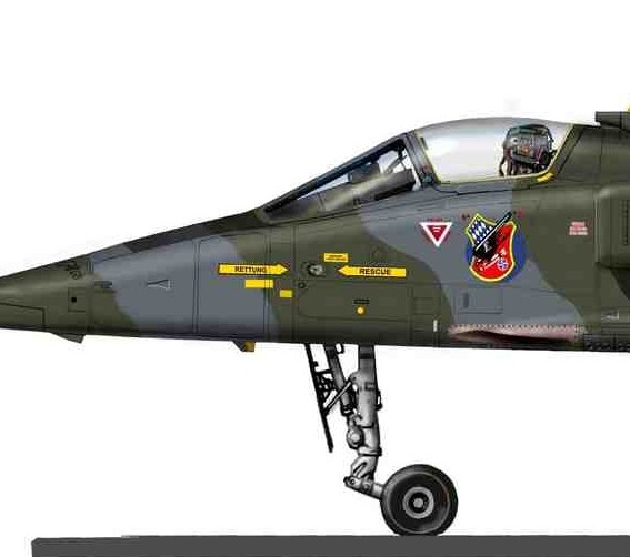

                          You must also take into account the very design of the Jaguar's trailing link landing gear which is what makes it ideal to easily handle unprepared fields . That is a crucial design element that has made the Freewing Avanti and the A-10 so well suited to grass operations. Compare the A-10 which only has rear trailing links and has rather thin tires. The Avanti has trialing link suspension on all the gears but the tires are also thin. Now look closely to the Jaguars gear, it has trailing link suspension all around except the nose gear's trailing link arm is even longer than the Avanti's. The Jaguar also appears to have wider tires almost balloon like than that of the others. The rear gear also has double tires giving it a wider foot print. For those very reasons stated the Jaguar appears to still be a good candidate and could even be better than the rest. Also take into account that the Jaguar is a small jet so it would make for a rather light EDF.
                          Nose gear of the Avanti
                          Click image for larger version  Name:	Avanti-s- gear R.jpg Views:	1 Size:	65.4 KB ID:	99720Click image for larger version  Name:	Jag gear 2.jpg Views:	1 Size:	40.6 KB ID:	99721

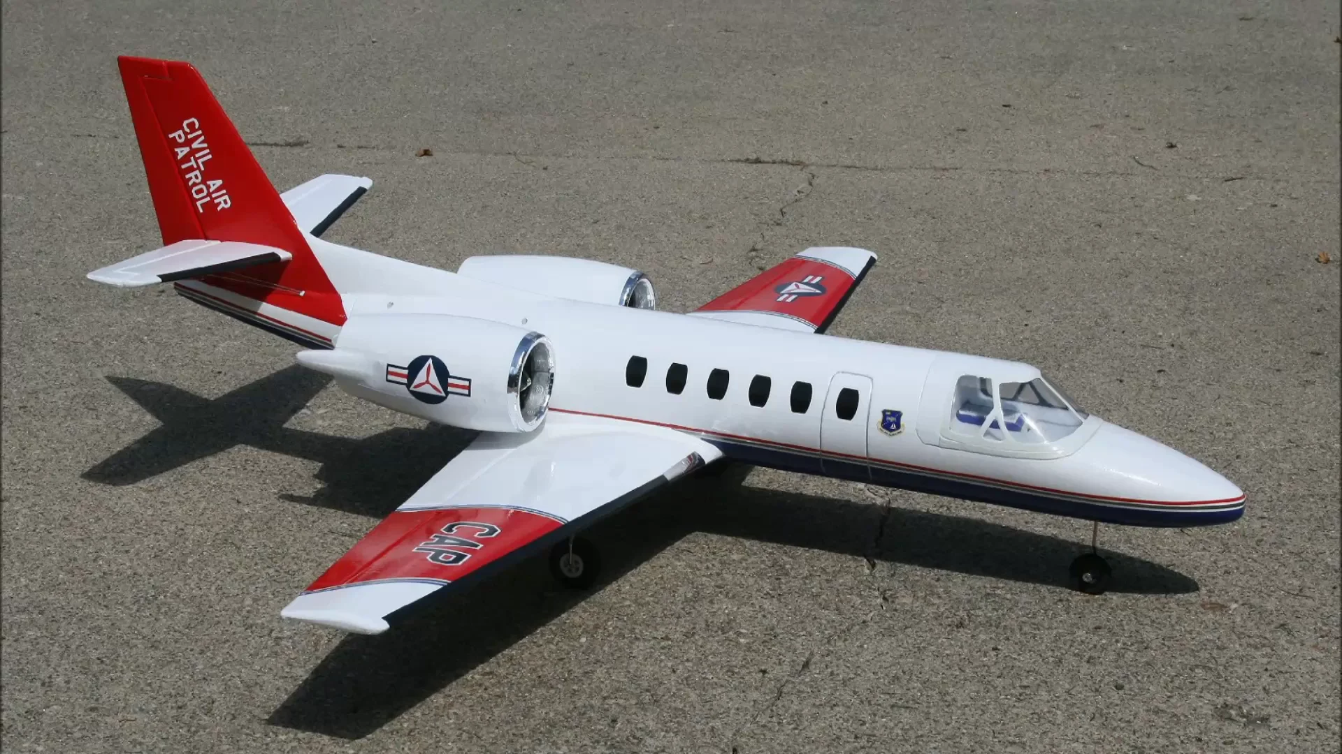

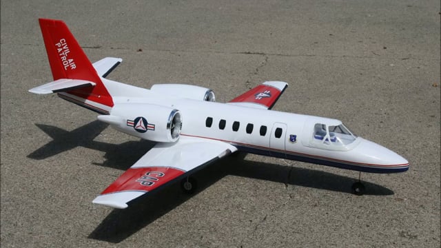

                            I and another member of our club routinely fly Dynam Turbojets from our club grass runway. I have flown it from grass both on 3 cell and 4 cell. Of course the 4 cell really wakes the plane up. We keep the runway cut short and well maintained.
