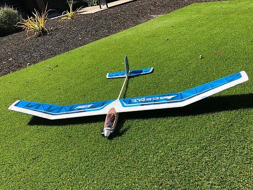

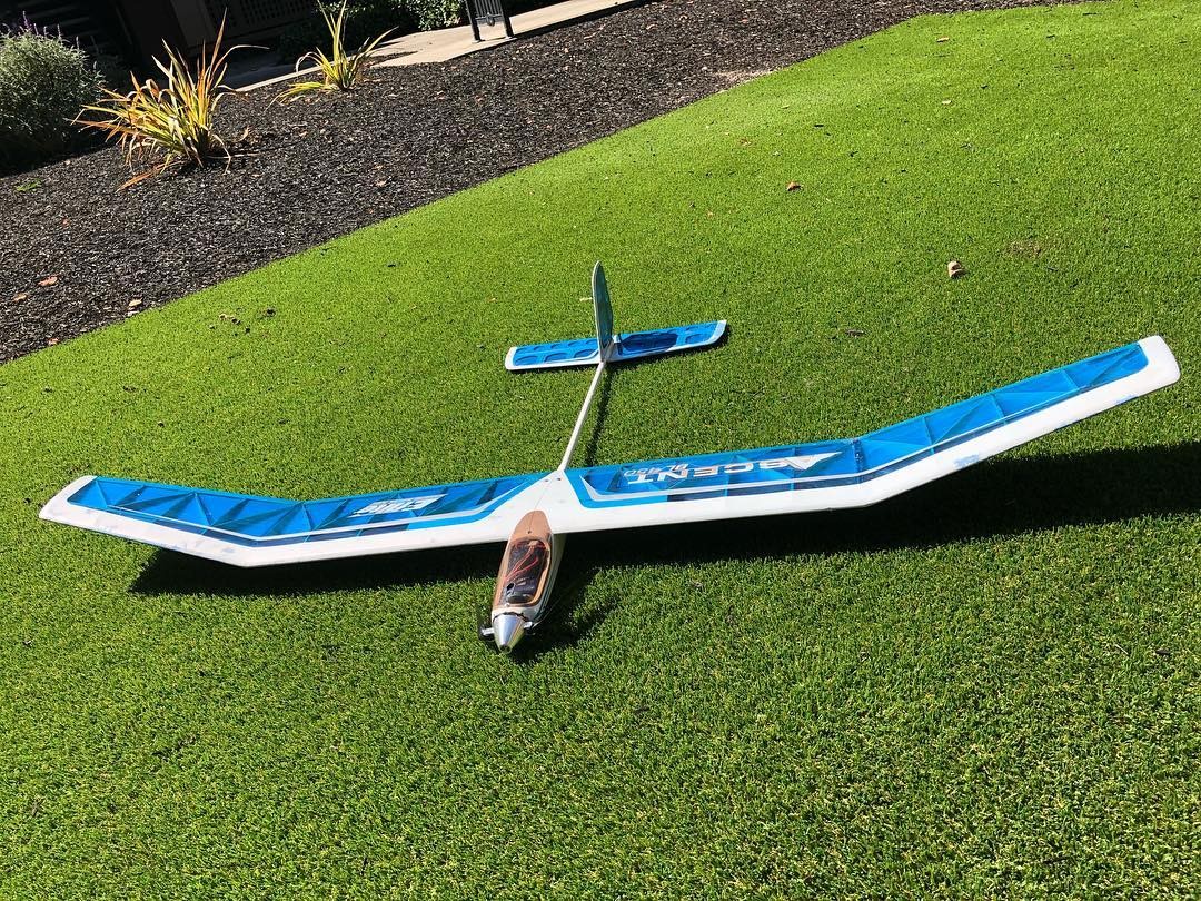

    Here's the blue version I prefer:
    Click image for larger version  Name:	41972316_334220300476922_1326309977443401165_n.jpg Views:	1 Size:	509.5 KB ID:	159741
