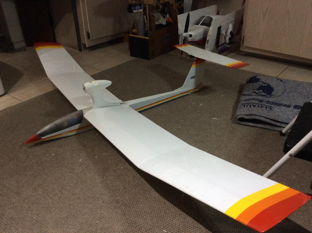

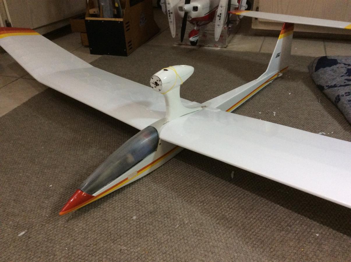

    Click image for larger version  Name:	56B3350D-AA5C-42EC-9B52-9E17F33715DA.jpeg Views:	1 Size:	115.8 KB ID:	178370 so while the glue and paint dries on the Ryan, Check it out.
    Futaba 3003 servos
    eFlite Park 370, tried to shoehorn a 480 in it but had to downsize before the Graupner Power Pod turned into dust.
    40 amp ESC should couple with the 1300 3S LiPo.
    Folding prop size still TBD, but did pick up a nice aluminum hub from Esprit.
    The ‘Lady is a lot further along than the Sport Trainer made way back by Aristocraft - the Challenger. Never flew it as a gasser.
    Bought in the 80’s and assembled, but the covering did not age well. Airframe is solid.

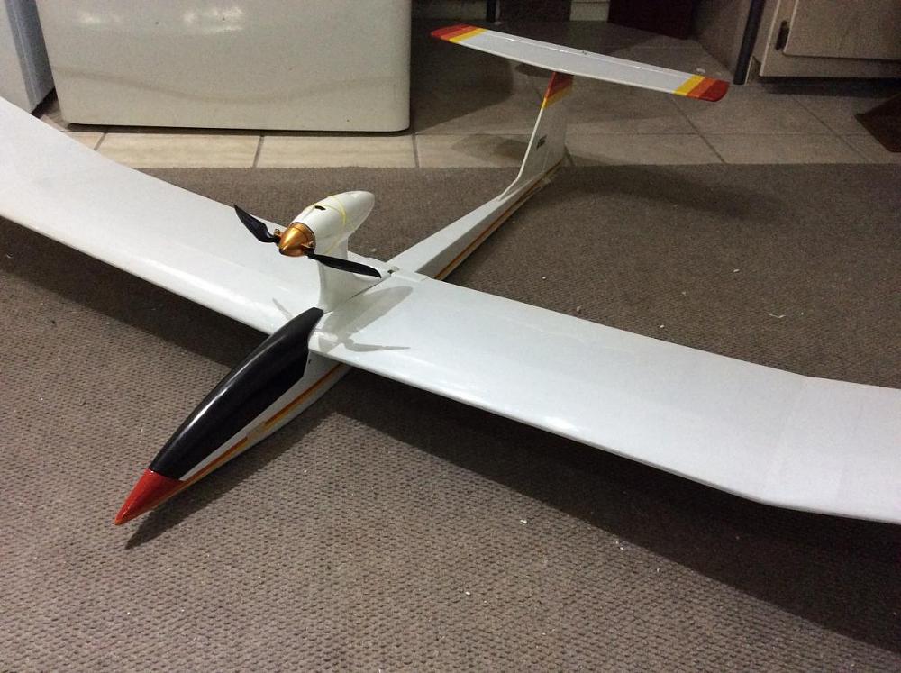

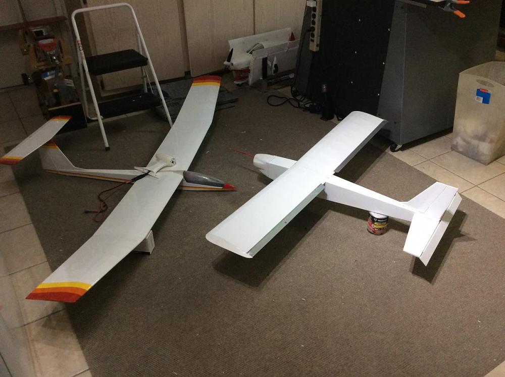

        Anyway, here’s an updated progress picture. Trying to get the Ryan done, but weather keeps me from finishing the paint so I have been making a bit of headway with this gal. Still trying to work out the propeller but am limited to 7 inch. My Adagio props may be the ticket there.
        This girl is the ARF version of that same model, which I picked up on Fleabay for half what the occasional kit sells for and it was mostly done. Previous owner had assembled it but never flew it and it was not airworthy, pretty much had to add all new servo mounting ply. Also had to separate the tail feathers as elevator cable had to be replaced. Wing had to be cut for the Graupner Pod and wing bolts are the next task.

                      Got the last one and an 8” fold prop...an 8.5 I had gives me 2mm clearance.
                      8 x 4.5 and the spinner should look super given red orange hues in the covering accents. Might have to add some pinstripes on the pod...

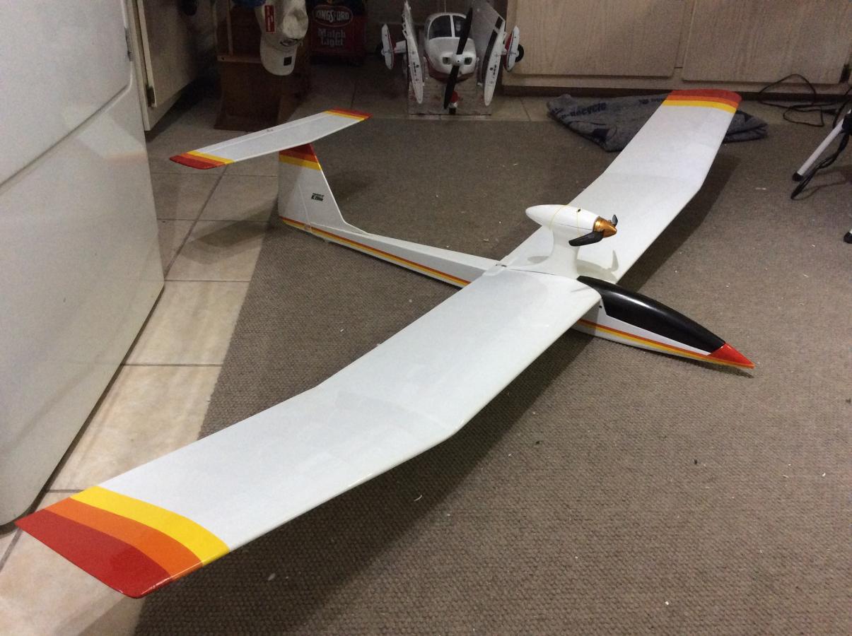

ID:	184981 Still must check the CG, but she’s ready for the maiden. Used the existing holes for wing dowels as openings for the ESC cooling. I get pictures of the cooling scoops later when I can get it outside. Maiden flight on Saturday with the Ryan STA.

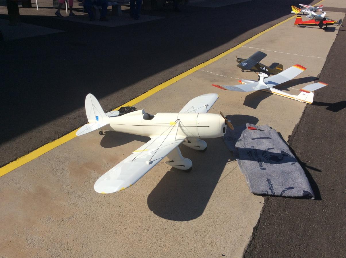

                                      #19
ID:	186252 Took her out on 2 flights today...the Sophisticated Lady that is. 2nd Flight was near 20 minutes and had a hawk joi me in an updraft. She’s kinda heavy and slow till she finds some lift.
