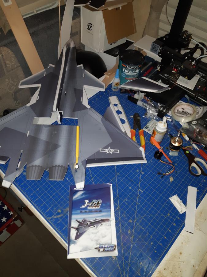

Delta wing elevon settings. 1400 kv motor, 30 amp esc, 5 inch prop but allows 7 inches of prop. Just deciding on servos right now. I have 9 gram plastic servos. Or maybe I should upgrade to the metal geared kinds.
J-20
Hi Skyboom. I've built a few of these "profile" planes myself and all of them have used the cheap, plastic 9g servos. These things aren't very heavy and the loads on the control surfaces are quite light. Metal geared servos are always nicer and can be re-used in another plane later should something happen to the original plane. They can also be quite cheap but I've read where those cheap "metal geared" servos still have one or two plastic internal moving parts. To get a fully metal geared servo, the cost may not be justified for what you are putting them into.
Then I'll use the plastic servos. I've changed the motor to a Racestar 2700 KV brushless outrunner, the 30amp esc should suffice. It shouldn't have a problem straight up vertical flight. P.S. Because there is no push prop jet forum here, wasn't sure where to post these aircrafts. I guess they are not very popular anymore. Besides if I have a crash, I'm only out 20 to 30 dollars. lol.
