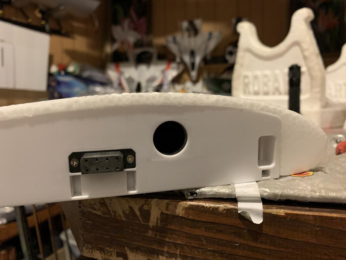

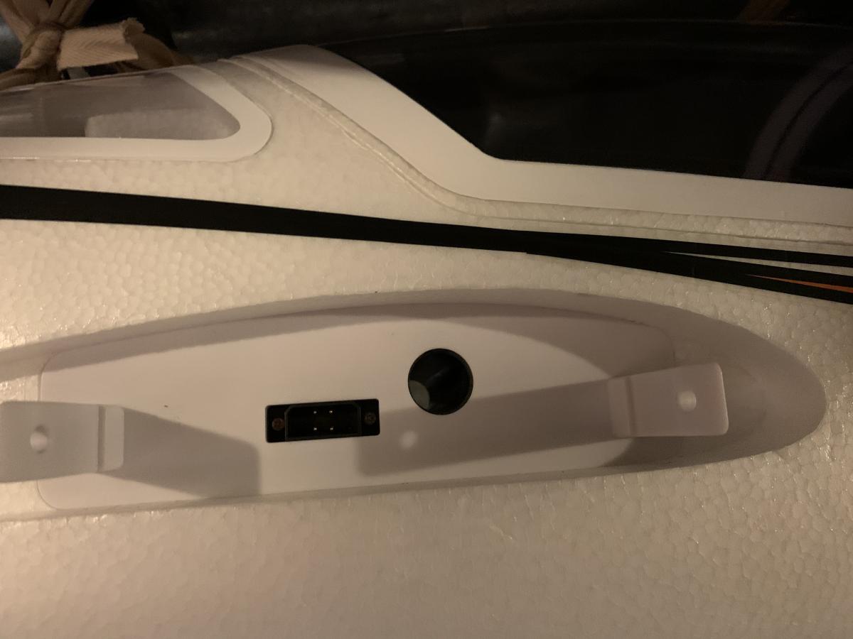

        I think I understand what you are saying but just for clarity, which plate is it - the one on the wing or the one on the fuse? See pictures below:

        On mine, the spar tube on the fuse are fine. On one side, it is recessed about 1/8" and on the other side, it's recessed about 1/16", so no problems pushing on the plate, even though it looks like the glue has expanded a little. On the wing end, it's the same. One side is slightly more recessed than the other side but neither is impinging on the plate. I can see that if the tube is close to the plate and they used an adhesive that expands a little when drying (like Gorilla glue for example), that expansion can push out on the plate around the hole.
        If you Dremel anything, they may not honor any warranty, assuming they answer you at all. However, if you think you can do it successfully, then proceed. I think it's a pretty straight forward DIY fix but that's me.
