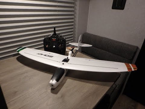

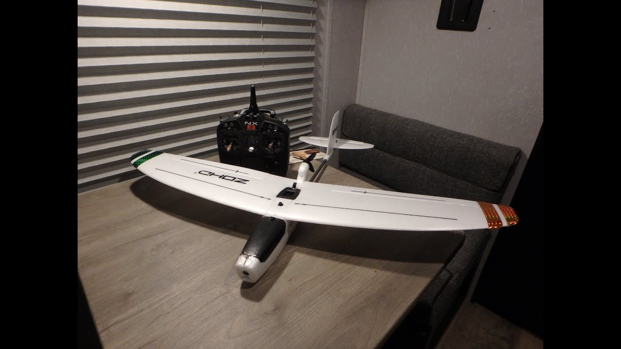

    After a little retuning on the control surfaces (this plane benefits from a little bit of up elevator), I put my ZOHD Drift up for a successful flight. I have a Wolfwhoop WT02-D camera installed in the nose, and for this flight, I let the goggles record the video while I just flew normal LOS.
    The plane goes together fairly easily, though I found I needed to be careful while installing the wings, to make sure the integrated servo connections aligned properly. As mentioned, it needs a bit of uptrim on the elevator, or the plane will have a nasty tendency to nose dive. While the specs state it needs a 4 channel receiver, there is no rudder on this plane, so it's only using 3 channels. It's not intended to be a stunt plane, though other videos on YouTube show pilots managing some basic aerobatics with the plane. I originally had a Wolfwhoop WT03 camera in it, but the cloverleaf antenna on that model was a bit of a tight fit. The WT02-D camera has a straight antenna which fit nicely. I flew for just under 5 minutes, and some pilots on YouTube report that the plane will easily fly much longer on an 850 - 1000 mAh 3S battery. The video is edited to remove about 30 seconds of the flight, in order to fit with the length of the music track.
