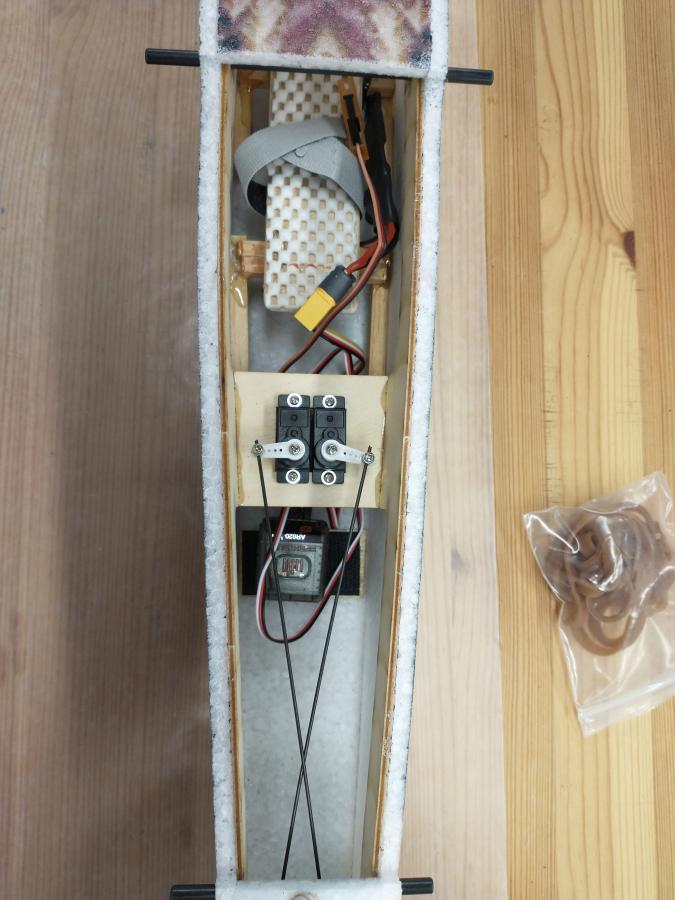

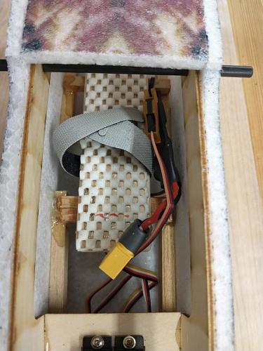

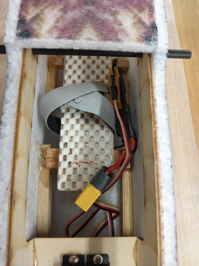

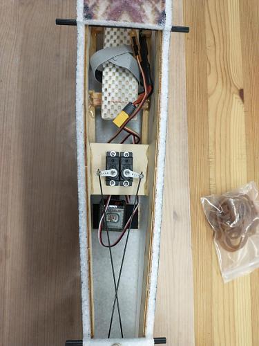

        Got the build finished yesterday. We added a battery tray and added a 1/32 ply support for the foam portion of the tail feathers (pics later). We crossed the control rods for the tail to get proper rudder movement using V-tail-A in the Spektrum DX8G2 transmitter.
        We are planning to do the maiden today.
          #24
          The product page mentions a 1300kv motor. It actually comes with a 950kv motor.
          I fixed the page. Thanks! Good luck on the maiden!
            #25
            Noticed that the revised instructions are now posted on the product page under the support tab.
            We did the maiden +2 flights on the eagle. It's a very nice flying "bird". We set the CG at 60mm and it felt quite good. It certainly looks realistic and presents best when flown "scale".
            The way we set ours up, it will roll and loop with ease.
            We replaced the control horns on all surfaces, as the ones that come with the kit fit quite loose on the push rods. We also moved the push rods on the tail surfaces in to the middle position. We tapered the openings for the push rods so they did not rub or bind when exiting the body of the bird.
            I use the term we, because this is my wife's aircraft. We often build and set-up new planes together. She's been building and flying for several years now and has pretty good skills at both. I'll maiden and trim for her and she takes it from there.
            She is enjoying the eagle quite a bit. In fact, it's in the van for the trip to the field in the morning.
            Here are the pics of the battery tray we installed and the 1/32" ply rear tail reinforcement.
            Click image for larger version  Name:	Eagle1.jpg Views:	0 Size:	77.1 KB ID:	316375Click image for larger version  Name:	Eagle2.jpg Views:	0 Size:	74.1 KB ID:	316376Click image for larger version  Name:	Eagle3.jpg Views:	0 Size:	78.9 KB ID:	316377

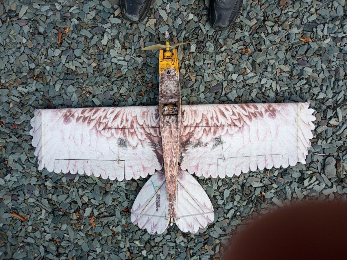

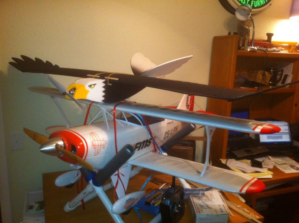

              This looks like another version of the old "Fly Party" Eagle. I still have mine from 10years ago and fly it at will. No Ailerons, the tail feathers are weak but it floats forever and usually brings out the Redtail Hawks and small birds for attacks nearly every time. https://youtu.be/N5q6Pj8bkgM Click image for larger version
Name:	FlyParty Eagle on FMS Pitts.jpg

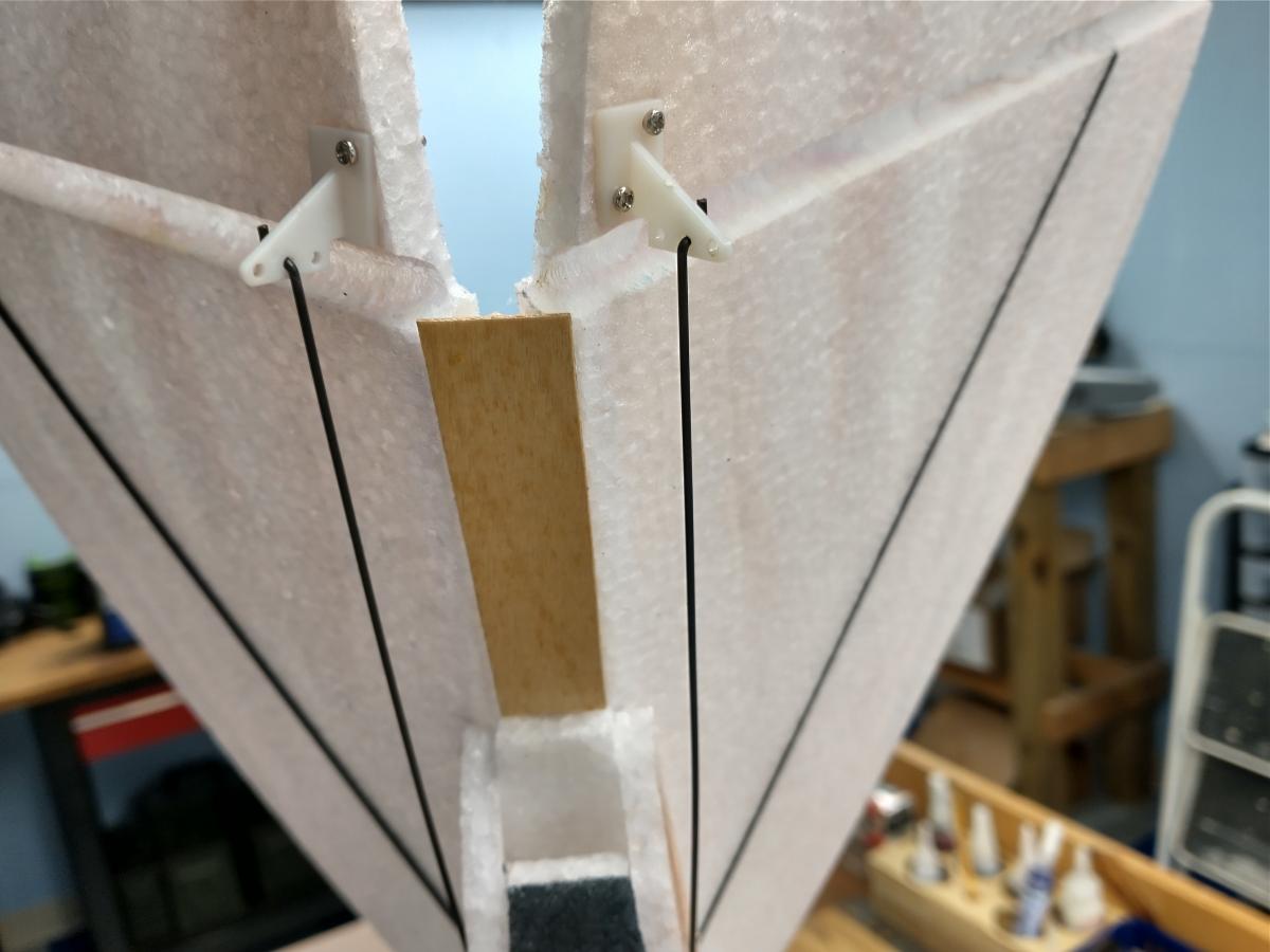

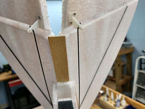

                      Here's how I established the 90-degree angle for the V-tail. Using a digital angle finder, carefully measuring both sides to make sure they were equal, using a heavy battery to hold the fuse in place, and then using four 1-2-3 blocks to support and lock in the glue setup, this turned out well.

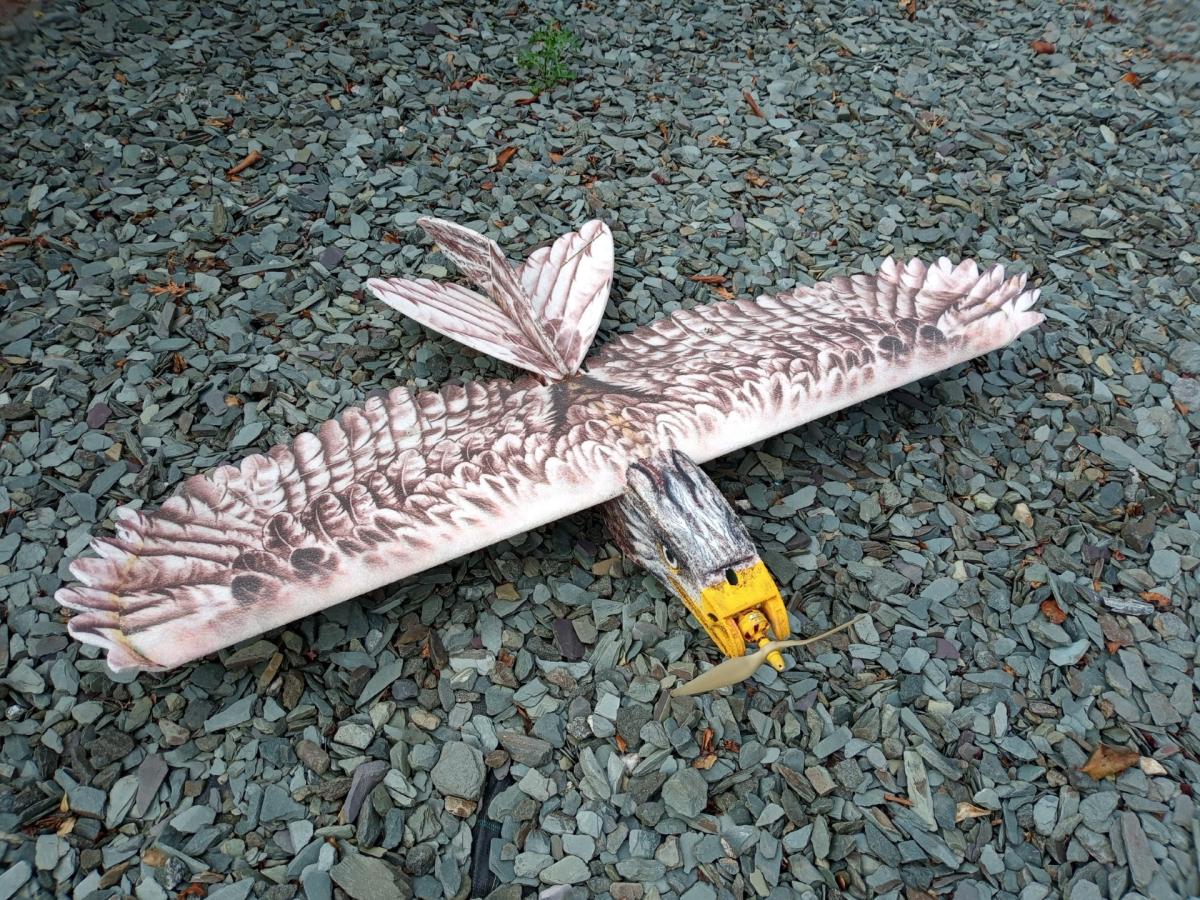

                                  I have the old DW 1200m version to which I added ailerons to assist turning so it is good to see the Skynetic version with these added. The angle of the tail feathers is critical for good rudder and elevator control and the hinges need to be well worked before flight to avoid flexing the V tail when operating the rudder. I found this out when I set mine too flat and ended up adding a vertical rudder in a tail feather shape and mixed some colours to match applied with a small brush rolled and dragged to just about match. Set the V tail too flat and rudder control is useless ! I also extended and beefed up the nose which on the DW version was very weak. I repainted the front and added an egg drop hatch to mine so that I could drop Easter Eggs on a target at our Easter fun day. Extending the nose, adding new top battery hatch to the head and using a 1000mah 3 s enabled me to add the egg drop servo, ping pong ball type egg and trap door and maintain the cg without adding too much weight.. Flies best slow and graceful and it does attract the attention of local wildlife. It will loop and roll now but I find rudder is best for turning . Good entertainment.
                                  Click image for larger version  Name:	Birdplane 1.jpg Views:	0 Size:	288.4 KB ID:	385001
