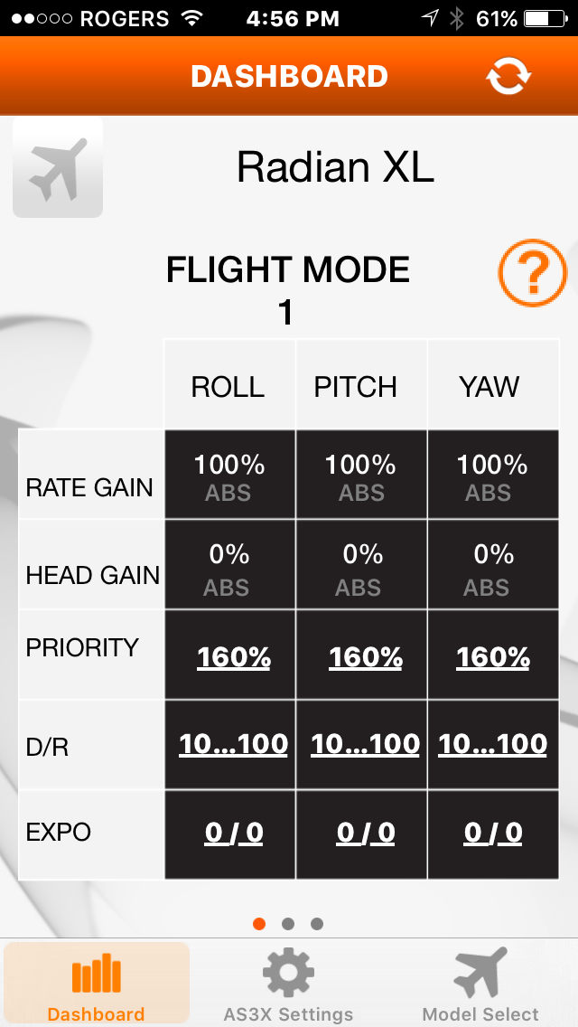

    I took a screen shot of the settings on our XL receivers.
ID:	45171 Click image for larger version
    The first photo is of Flight Mode 1 but all 3 flight modes are identical for the XL. The second one is merely an expanded display of the dual rate. All 3 flight modes are the same. If it becomes necessary, it will be a simple matter of dialing all the RATE GAIN to 0% and PRIORITY to 0%. This will effectively make this RX like any other except for the somewhat limited telemetry signal, which, as I understand it, Spektrum is in the process making it a function that can be switched off in future applications.

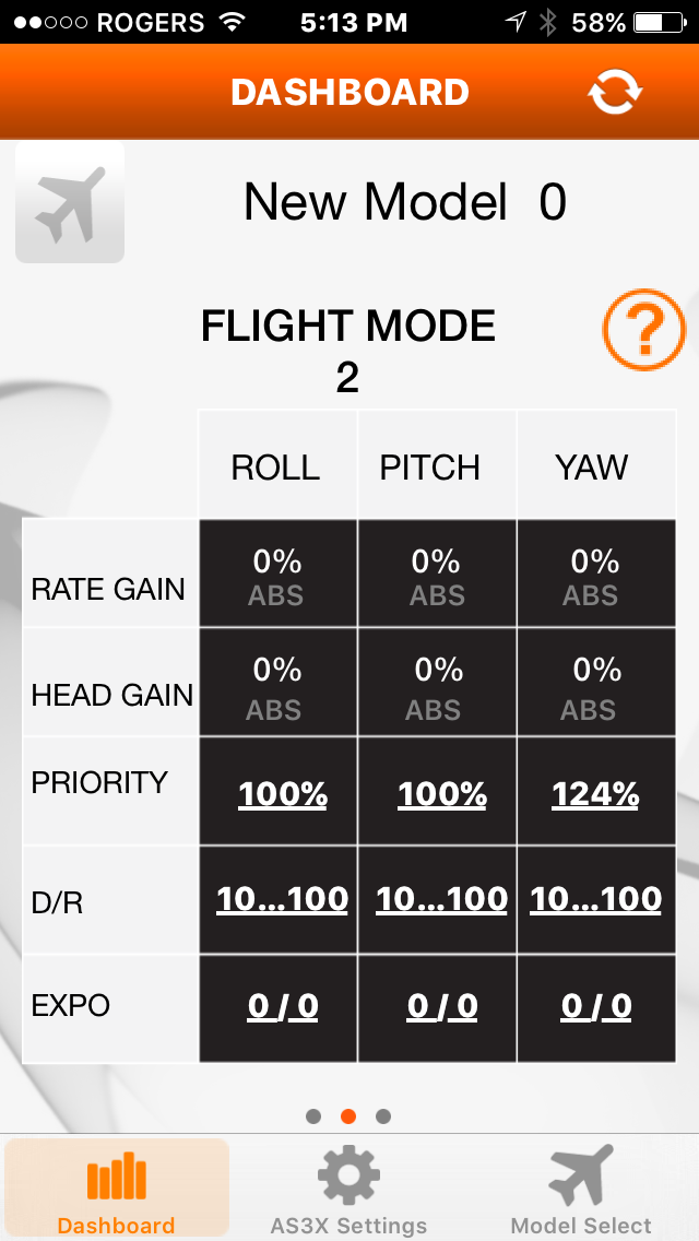

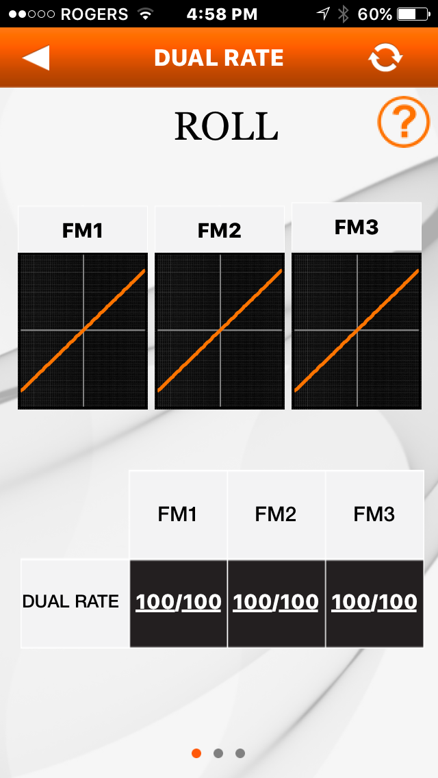

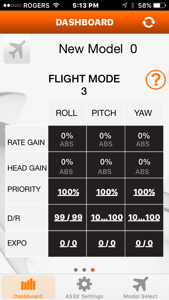

    Now, just for comparison, I've also included screenshots of the stock RX settings out of my Rare Bear so you can see how they program these things individually for each type of airplane product. IE, any product with AS3X will have it's own factory settings out of the box and each one may be different.
ID:	45173 Click image for larger version
ID:	45174 Click image for larger version
