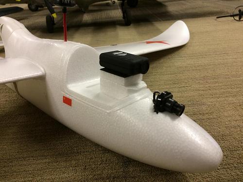

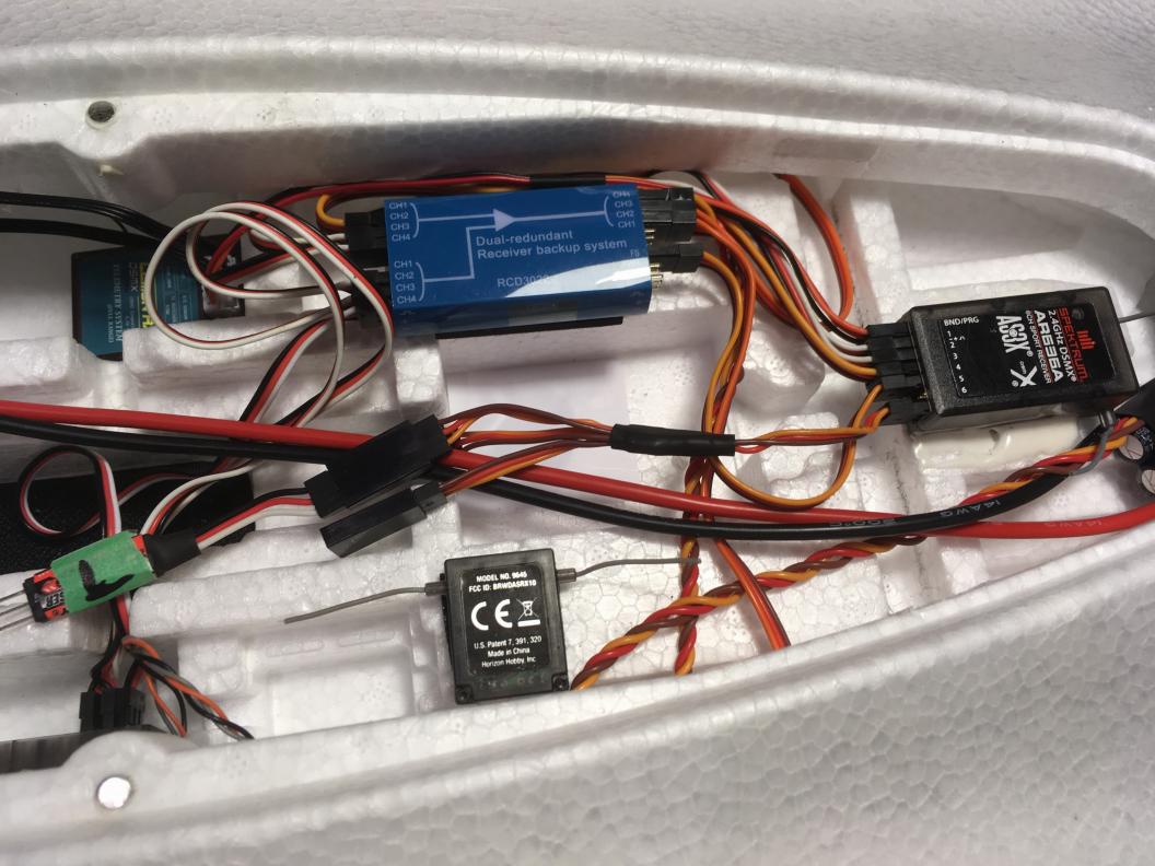

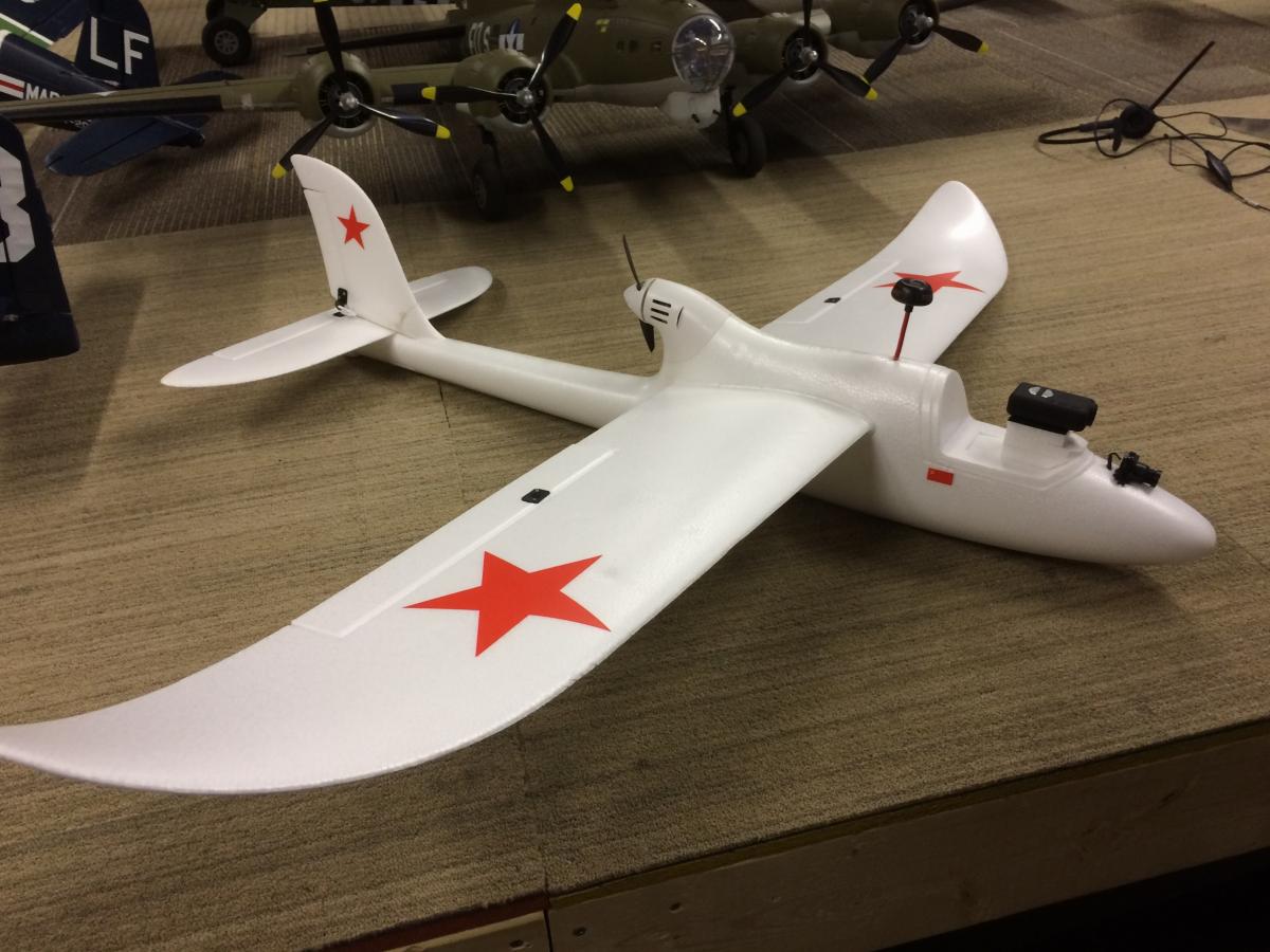

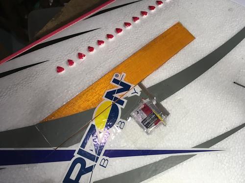

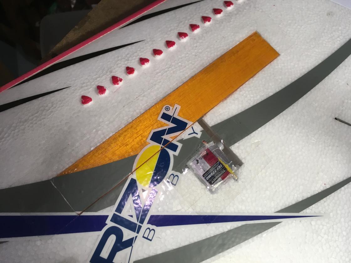

                            I have been doing some modding to my Opterra of late. The 2 of us who fly the Opterra at my field have noted that this plane comes in pretty hot for landing. Once it gets to about 2 feet off the deck, it seems to float "forever". During this time of year, our plowed field is somewhat short so the landing has to be precise or we run into a big ridge of snow. I decided to take the spoilers off an old broken set of Mystique RES wings and cut them down a bit and install them on the Opterra. I haven't had a chance to fly it yet due to the weather but if it's anything like my old X8 wing with airbrakes, the Opterra should slow down and lose lift quite dramatically to achieve a shorter landing.

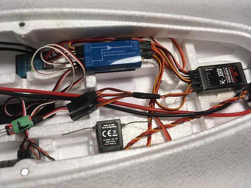

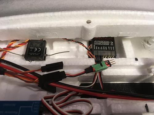

                            I've also decided to install a "Return to Home" module (Bigaole) as this thing can get quite far away and high up very easily and quickly. Losing sight of it takes just a blink of the eye. The RTH gives added insurance to bring it back to make it easier to locate it. However, not wishing to lose the "LAUNCH" mode, I don't want to eliminate the stock RX. Hooking up a Bigaole inline with a pre-configured AR636A is not possible because the elevon mixing is done within the Rx and the Bigaole. You can't do an elevon mix to a signal that's already mixed. Therefore, I've incorporated a dual receiver set-up using a HobbyKing "Buddy Box". This, in effect, separates the signals into 2 different paths, allowing the Bigaole to be spliced into one of them. Once I get all the components (Bigaole on the way), the first test flight will be very interesting.
                            Also added Lemon telemetry to know altitude, battery voltage, RX voltage, amp draw, air temp.
