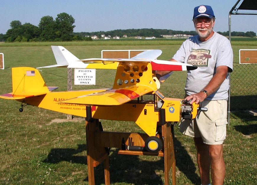

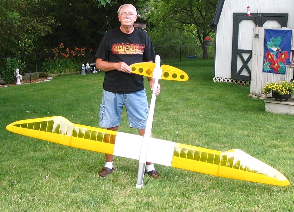

                  I bought a 2 meter Radian and I read this thing don't want to land.:Straight-Face: I read your descrition of the spoilers you installed and what a great and simple idea it is. I do have a question about the size of the opening and I assume the spoiler is the same 2" X 9" size as the cut-out mentioned. I have seen other spoilers in google searches and none looked that large/tall (2"), when deployed.
                  Because of the working-design of this spoiler, is the 2'' dimension needed for the servo arm to work correctly? Did I get that size incorrect?
                  I am thinking this spoiler will not go vertical but maybe open to a 45 degree angle. (???)
                  I am getting back into RC. This is my first post, "this time around". I was in RC from 2000 to about 2008 and like a fool........ sold everything:Crying: At 76, I am moving slower so I want my aircraft to be on the slow side too. My RC club's field does not have as much runway length as some others so I thought spoilers would be perfect.
                  NOTE: Attached are a few photos. The tall, electrified sailplane I built from a kit from Skybench Aerotech, Ft. Wayne IN., their XL Big Bird.
                  Indy Bob
