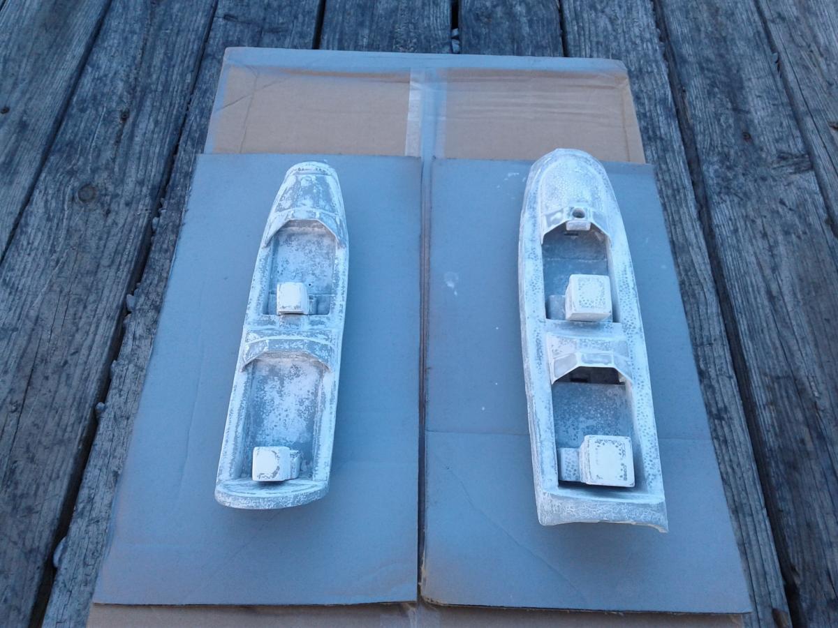

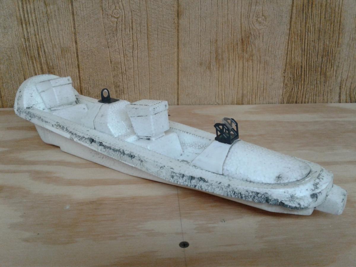

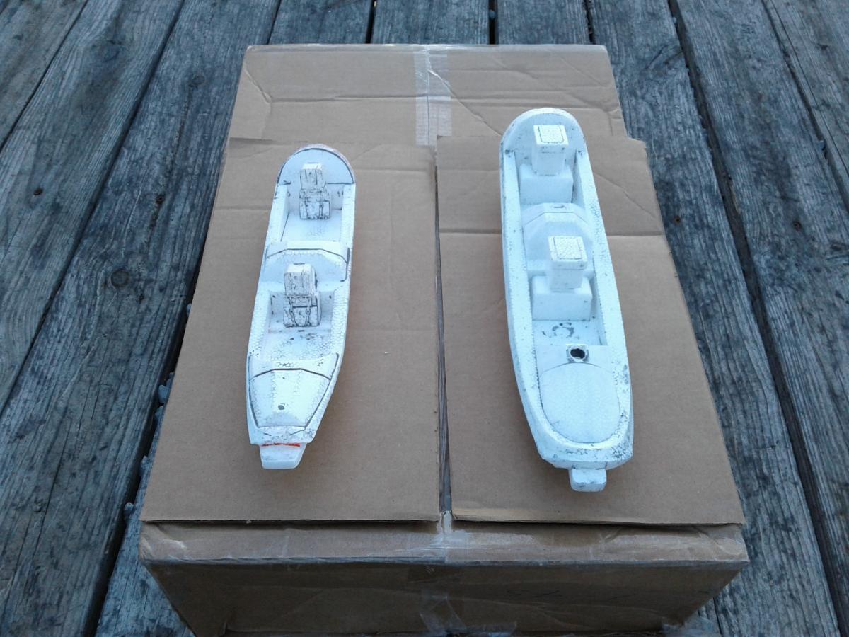

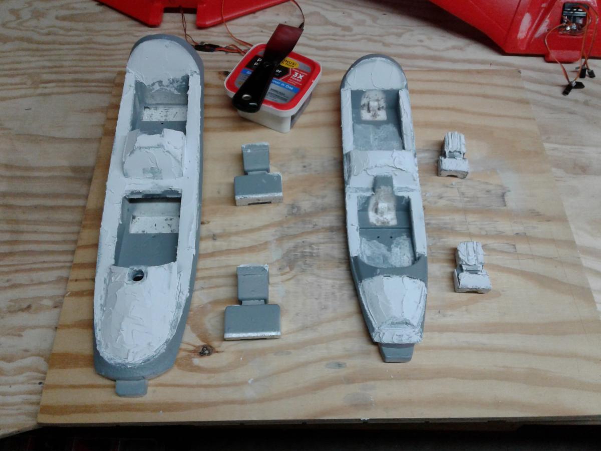

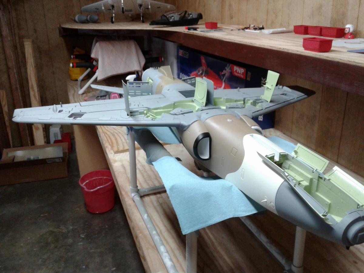

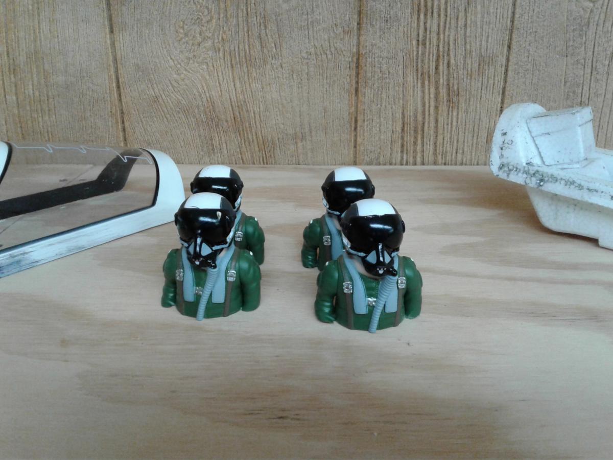

    So, while she is disassembled I decided to go ahead and re-paint her. I'm starting with the cockpit and pilots first. Sawed off those mittens and they look better already. Got a couple extras for other projects. Cockpit is now stripped.
    Click image for larger version  Name:	20171013_124549.jpg Views:	1 Size:	116.3 KB ID:	100359Click image for larger version  Name:	20171013_124553.jpg Views:	1 Size:	114.3 KB ID:	100360

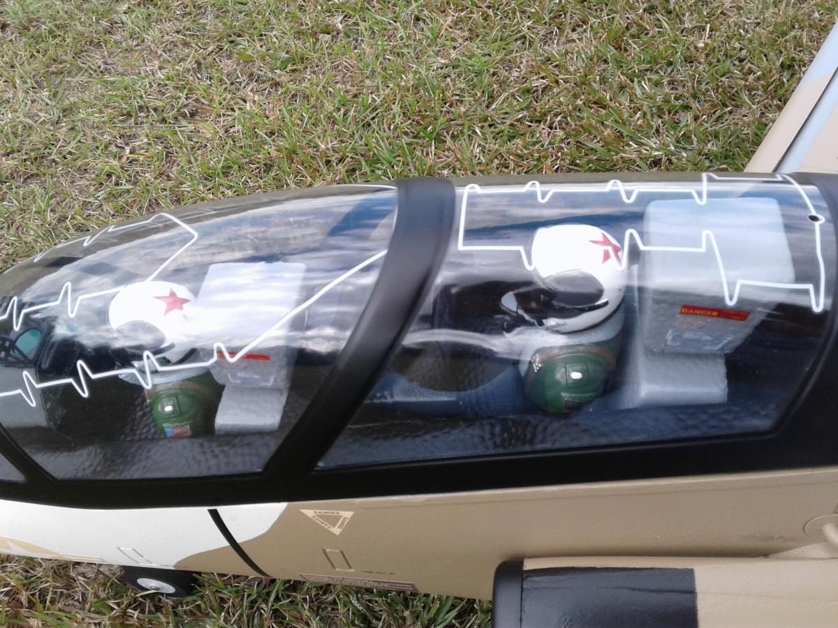

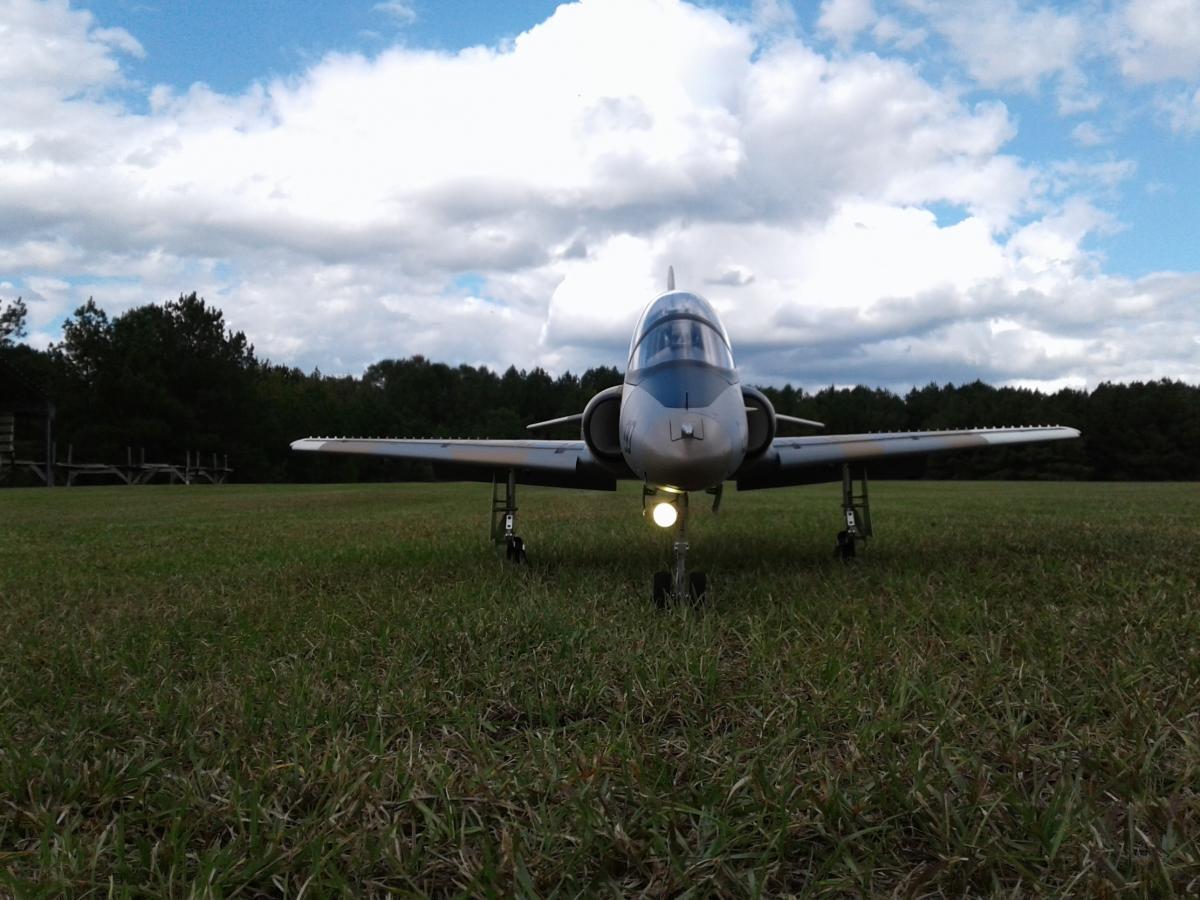

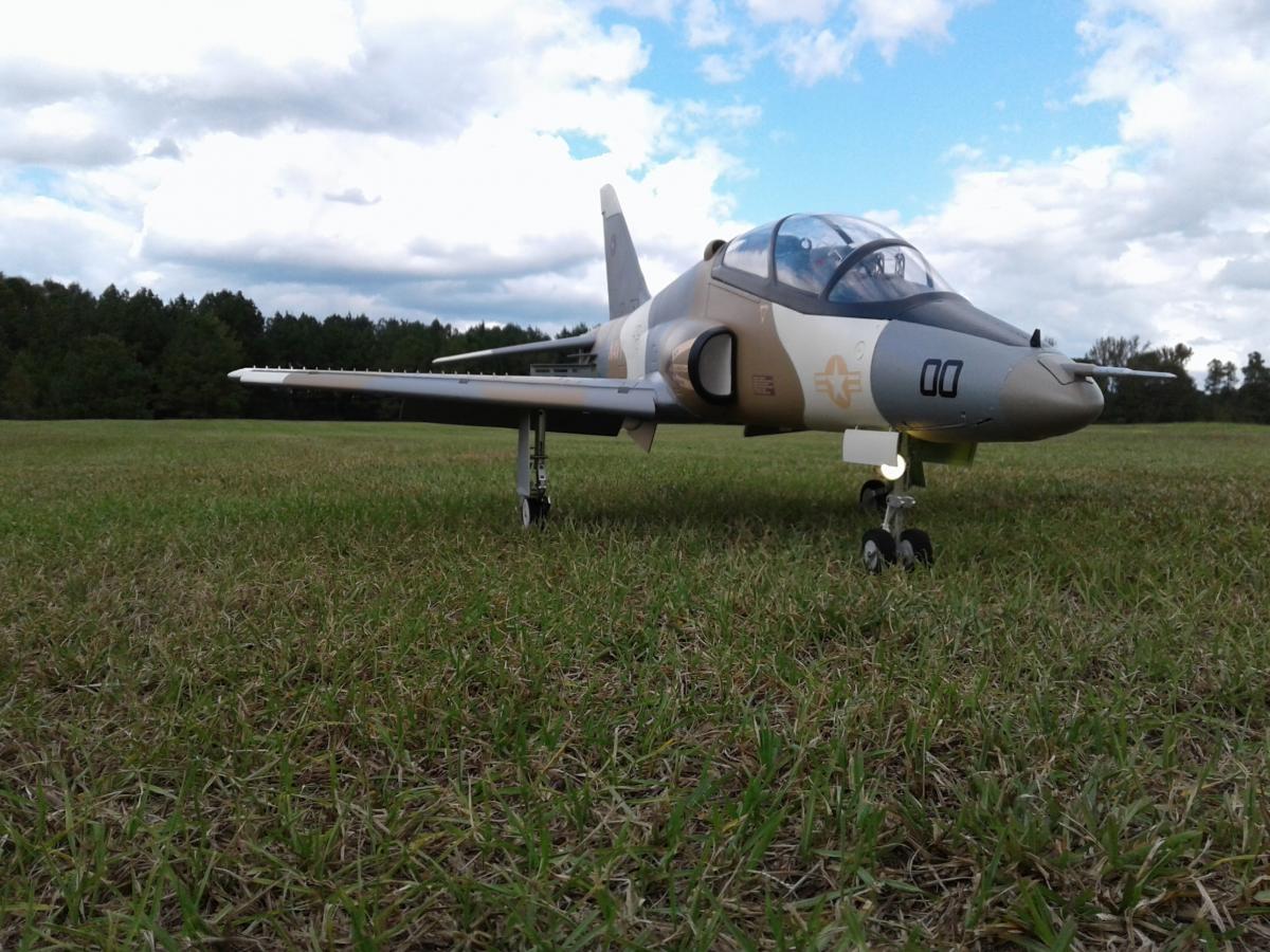

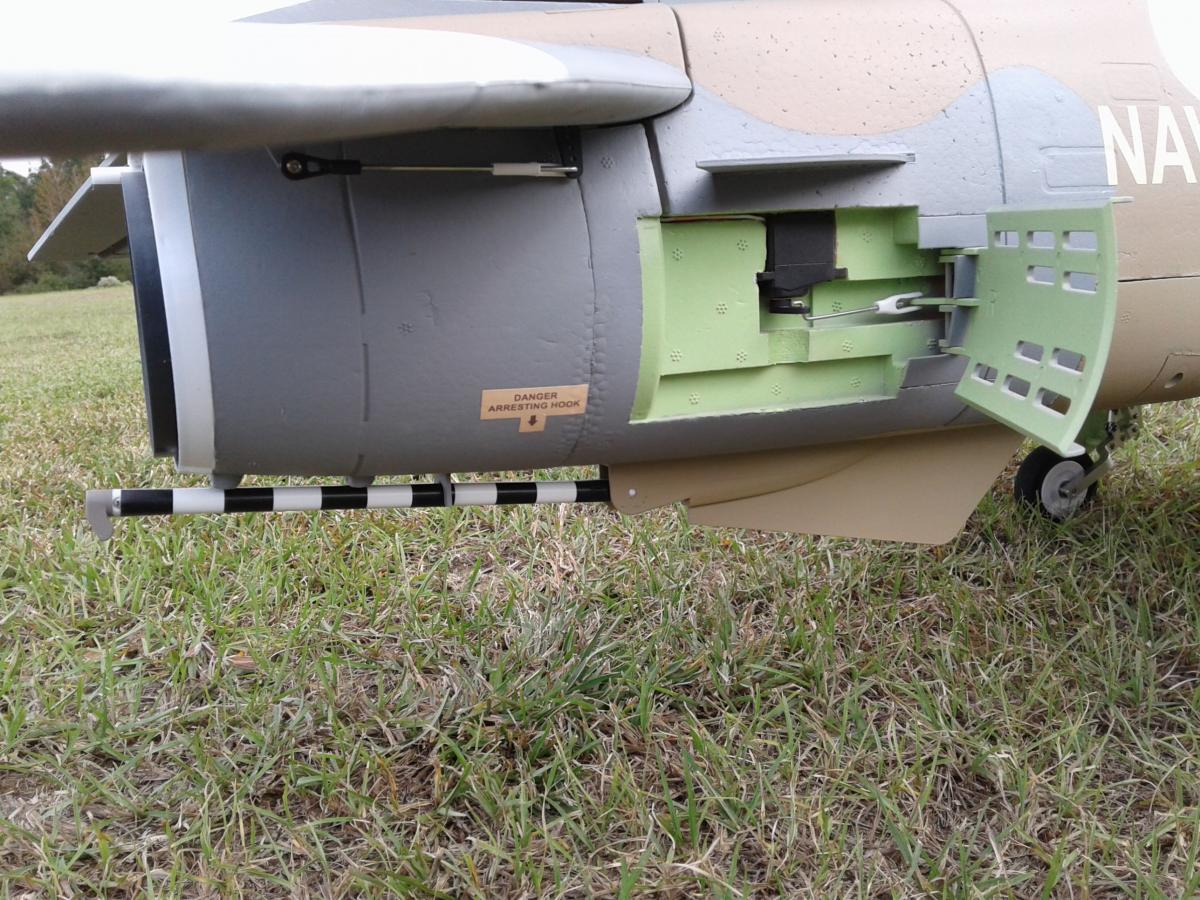

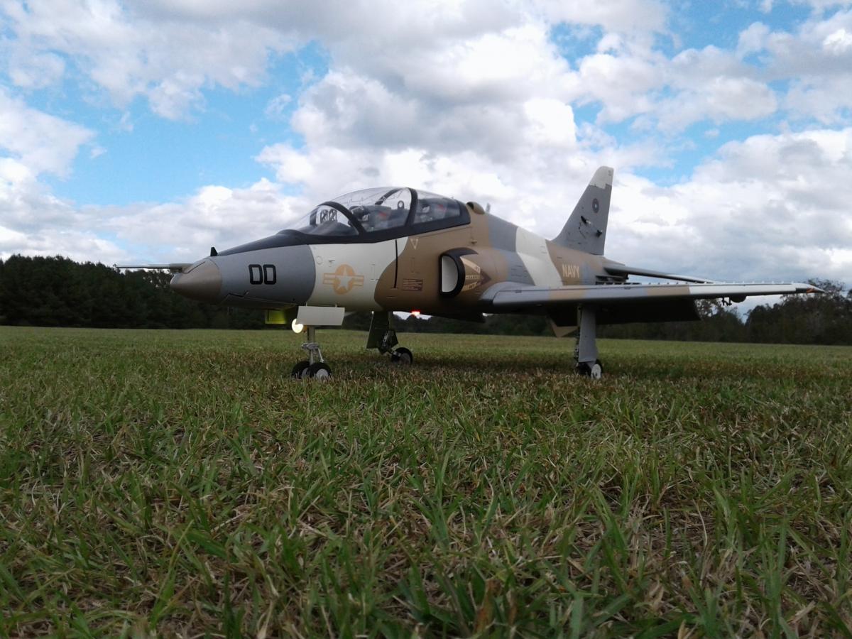

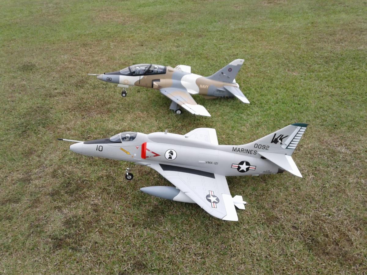

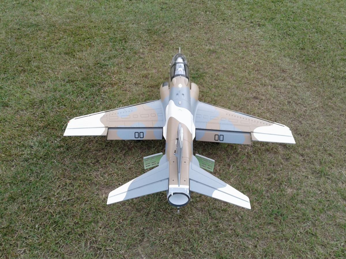

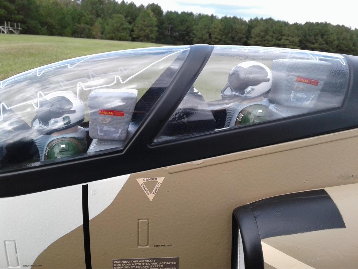

      Finally got the T-45 rebuilt and repainted. I chose a scheme from a US Navy Fighter Weapons School F-16 and adapted it to fit the T-45. Decals are mostly by Callie Graphics. The cockpit decals and some of the others on the fuselage are my own. We have another club member with a T-45 in stock paint. Now ours look a bit different. Got in two flight on her today before the rain. I will upload video sometime in the near future.

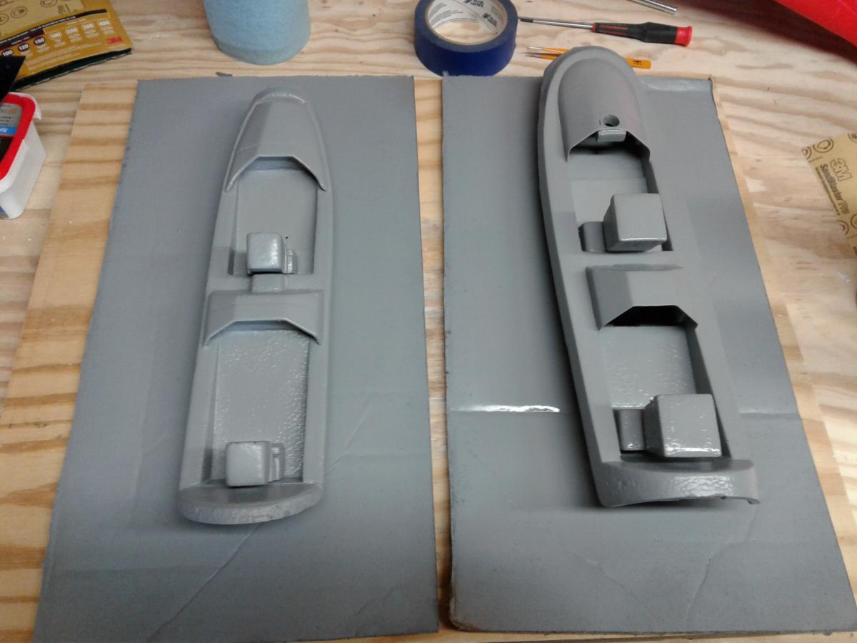

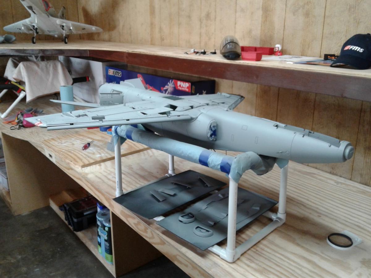

          I used acetone and Valspar primer and spray paint. Masking was via cut wet paper towels (see this thread https://www.hobbysquawk.com/forum/el...orpion-repaint)
          I removed all electronics and ball links from the airframe first. After paining was complete, I reassembled everything and then did decals and satin clear. The home made decals in the cockpit area did great. But they need a very smooth surface and warm water for application.
          I will probably discontinue using the home made water slide decals. Just not too happy with them.
          Anyway here are a few more pics from the paint job. The smaller cockpit is for the FMS 80mm Hawk which is under repaint at this time.

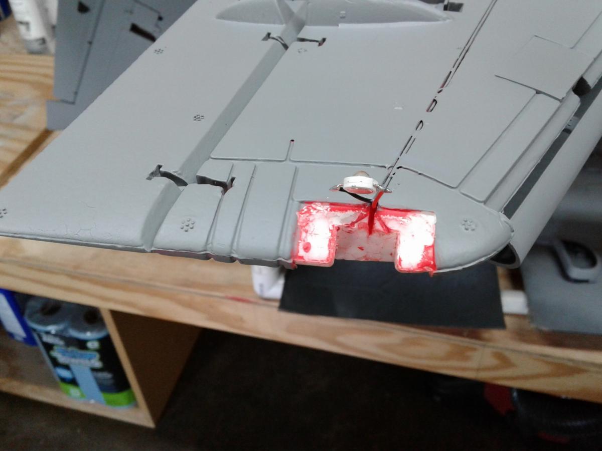

            On this project I had to replace the rudder servo, a speed brake servo, all the servo hatch screws-upgraded to servo screws, and the motor mount screws - factory ones were partially stripped and holes drilled out of line. I ended up using 4mmx10mm screws for the fan mount-same as the big wing mounting screws. I also had to re-do the wingtip lights as they were just glued in all wrong. I really wish the servos were of better quality. But the thing that really gets me is that the servos for the speed brakes are GLUED in. And yes, the speed brake servo gave up only after the aircraft was fully painted. So I had to go and dig it out, repair the foam, and touch up paint. Why do we still have glued in servos?. Also there is too much play in the speed brake mechanism. But overall I have a better ship now than stock out of the box.
