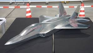

                                Sounds like a dead cell, check every individual cell to see where the charge is. I had one like that at Nefi, three out of four cells were good, one bad resulted in an emergency landing with my P-51B after about two minutes of flight, no damage thankfully!
                                Got her on the ground and revved up to motor. she went to high RPM and then died off.
                                Thanks for your input , at least with a war bird you got some glide left to land with the jets Im finding they like power even on landings. Click image for larger version
