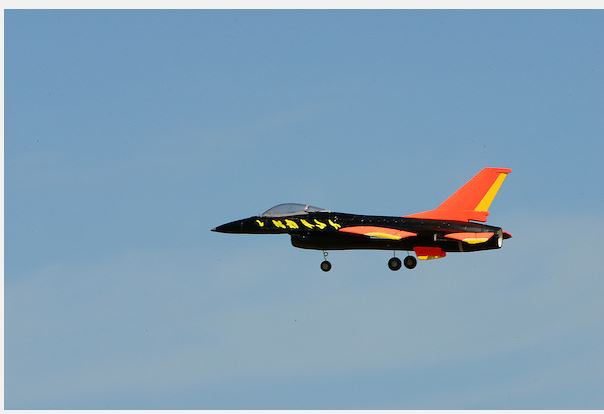

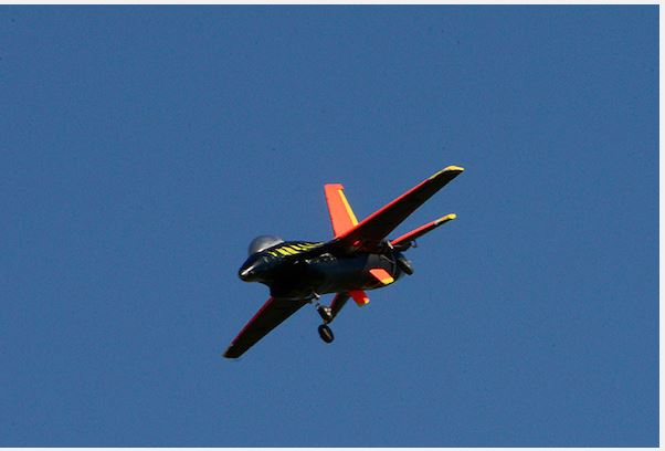

                  Lastly I have a hard time seeing some of the Military schemes even though this plane is really something to see, I painted mine out in a black and yellow/orange scheme. It gets to 80+ mph now so seeing it in my colors really helps.

                    • #11
                      Here are a couple of pictures of the paint job I did on my F-16 so I could see it better...Our field is overcast in the mornings being by the beach so there colors really help.
