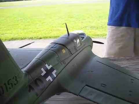

            Here's a short vid of rocket prep.....

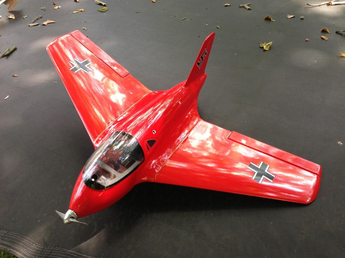

                            I own two Durafly Komet and the main issue is certainly the dolly. I have no smooth runway to takeoff so typically it’s a crash waiting to happen. If I can get it airborne then no sweat.
                            I quit flying mine also...
                            I do also own a HET Me163 and it must be launched with a bungee. It smokes the MUCH slower Durafly offering.
                            Onboard gps has it at 130mph flat out and faster in dives.
                            I have 144 flights on it and i’d Certainly say you gotta have you’re game on while flying it.
                            It must be landed as a glider and the power comes off about 1000ft out. At 100ft agl.

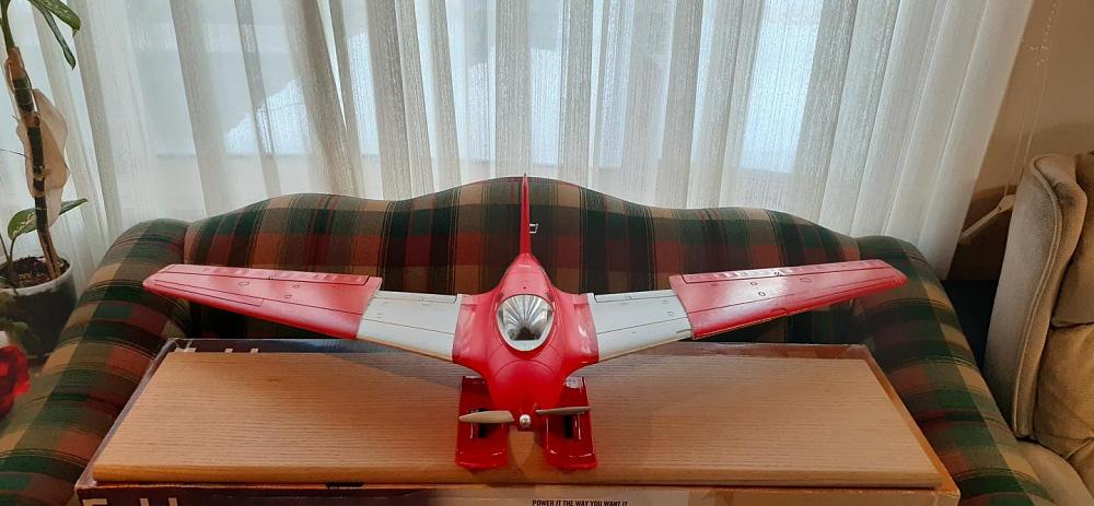

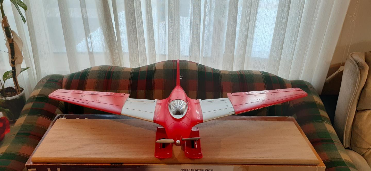

                                This 48 inch wing span modification is game changer for this plane. Decreased wing loading, effective flaps for landing with full control at any speed (no ballooning), yes a small amount of up elevon when flaps deployed is programmed on the switch, short takeoff runs, slow landing speeds, much better visibility, aerobatic like the stock one, longer glides, longer flight times (6 minutes with a 3300 3s battery, and 4 minutes 2300 4s), still fast, a joy to fly, 29 flights so far without a singe mishap. Wing is reinforced with a carbon fiber arrow (cored foam with sharpened brass tube) and leading edge tube joined with a section of solid rod). The wing is attached to fuselage the normal way. Will eventually produce a second one with the spare sitting in the closet as I have a spare set of wings to work with. The skis were used this winter off snow, worked very well, and now flying it with the wider dolly wheel gear. Put on easy lights under the wing tips which makes for better skids.
