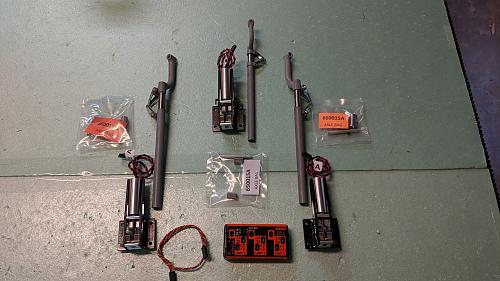

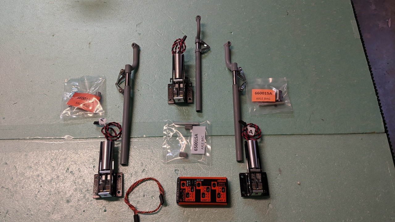

    Progress so far... I received today the Robart electric retracts for it and I am impressed.
    Click image for larger version  Name:	IMG_20180822_190728.jpg Views:	1 Size:	298.8 KB ID:	148119
    It will have 3.25" main wheels and a 2.25" nose wheel. Basically the same as the A-10 so it shouldn't have a problem flying off of grass surfaces.

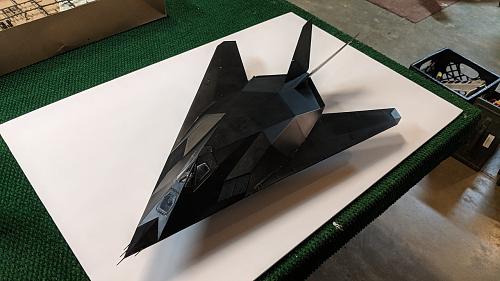

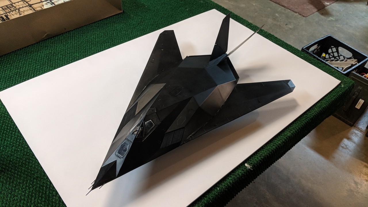

    I started out purchasing a Testors 1/32 plastic model of the F-117 which helped me with a start on a drawing for it.
    Click image for larger version  Name:	IMG_20180708_210511.jpg Views:	1 Size:	230.3 KB ID:	148120

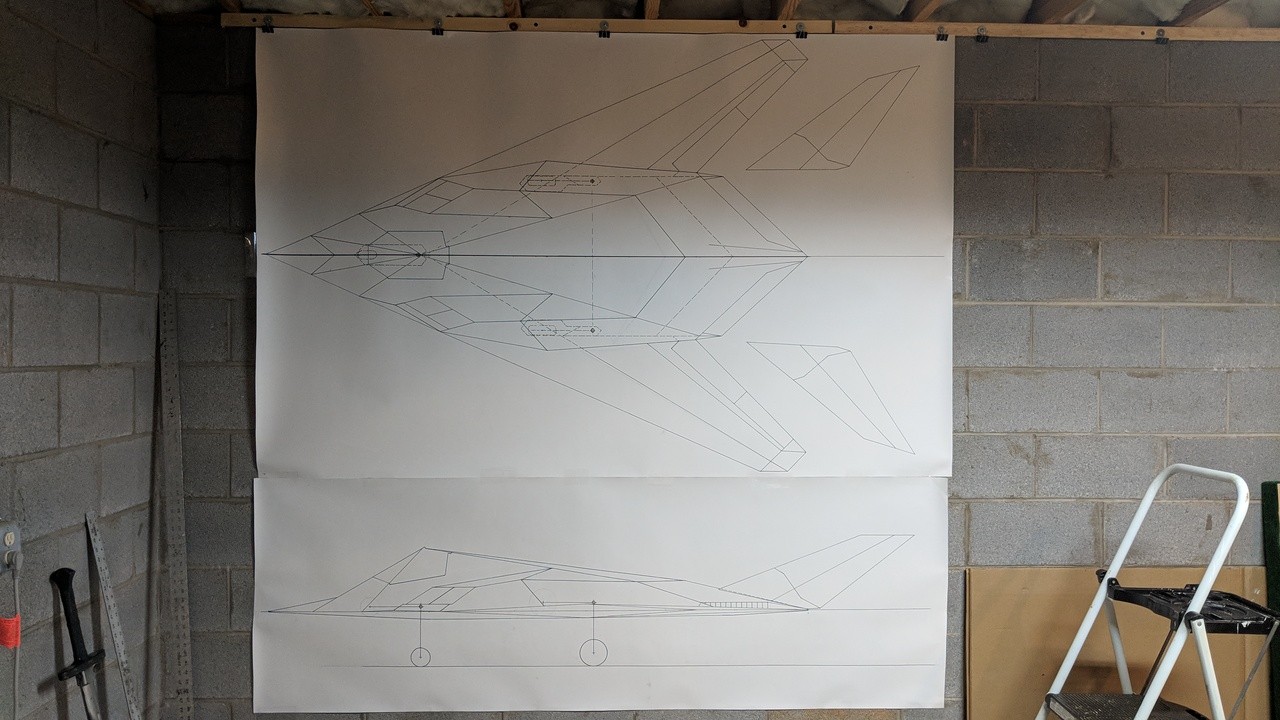

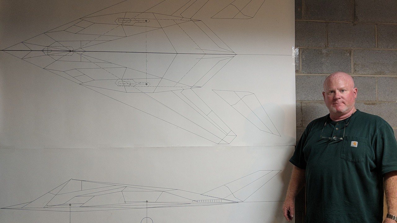

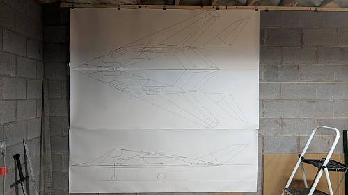

      The drawing is full size.

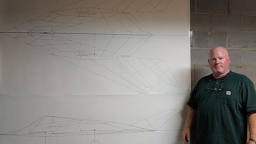

      It has changed slightly as a result of finding a Squadron Publications walk around book of the F-117.

                  • #10
                    The Testors model is very inaccurate--just look at the engine inlet area. Also the FLIR camera opening and canopy look off. Consider using the Trumpeter 1/32 scale model as a reference. It is arguably the best F-117 model out there.
                    • #11
                      Cool! I will look into it. That was the first thing I noticed when I got the Squadron book was that the Testors model was completely missing the intake grate de-icing features and some of the facets were different. Always makes me wonder if there were earlier versions? None the less, I want to make it as accurate as I can to full-size service birds.
