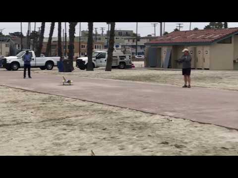

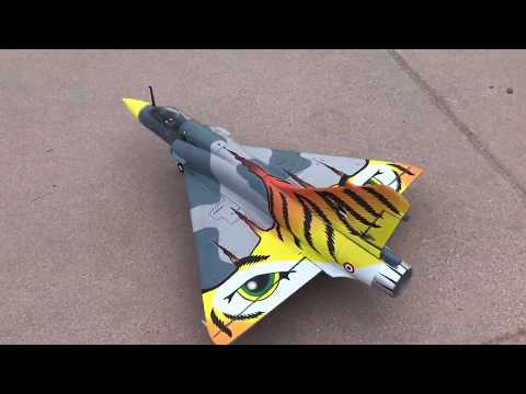

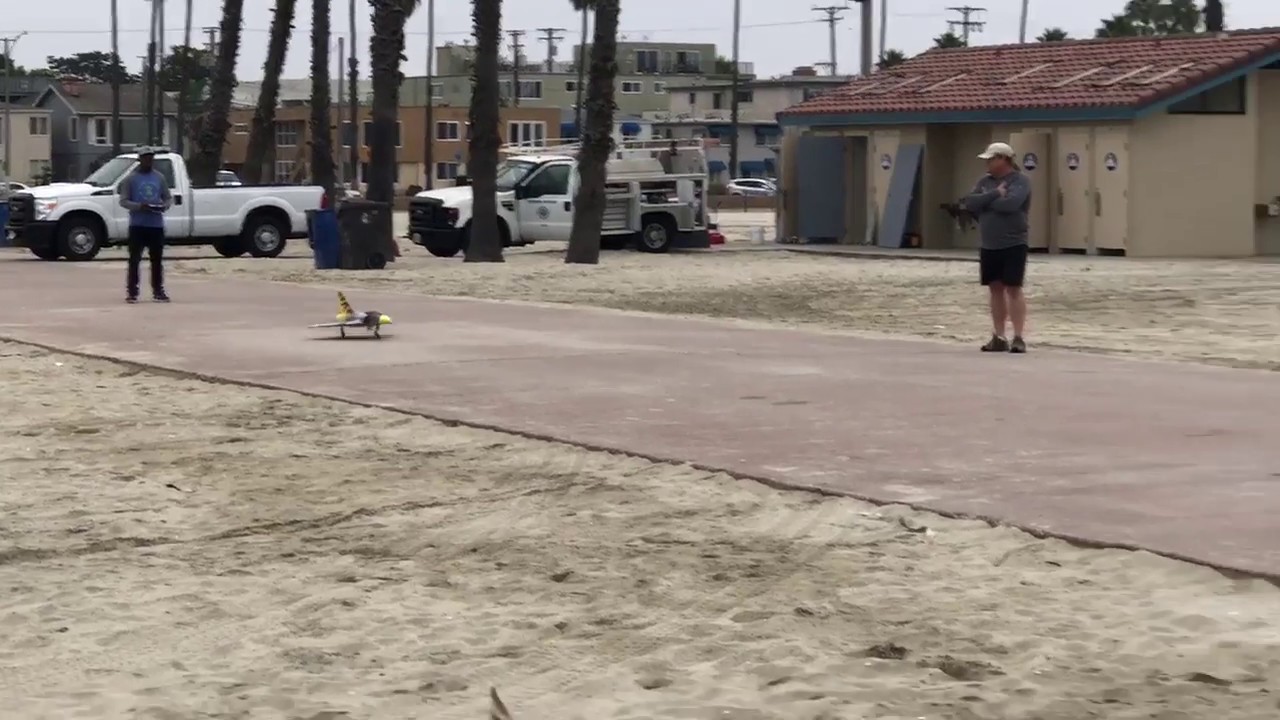

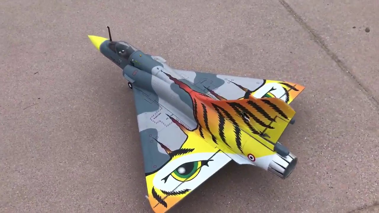

    I just got this Freewing Mirage 2000 V2! Wow this plane is a rocket ship, not only does it have speed but it flies great in slow flight. This plane is really touchy and the aileron throws are crucial, I had to turn them down quite a bit. I have my D/R-Expo at 35/30 aileron 75/40 Elevator and rudder at 100/15 and it flies like a dream. I noticed that that the "Tiger Meet" Scheme shows up nice when flying, but the slim profile of the plane appears small and a bit difficult to see during landing approach. So I painted the nose cone bright yellow to see the plane on final! I will say this is one of the best jets I have in my fleet! I am running a 6s 4000mah 60c Lipo battery and I have to push it back into the battery bay a bit to get the CG correct.
