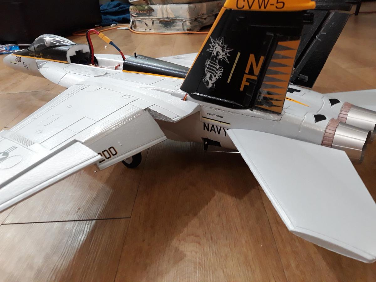

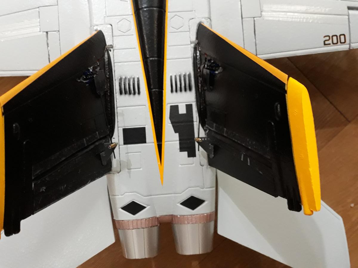

Maybe try the rudder mod like killerplanes did on his F22, in between the two fins a servo.
Saw the killer planes mod, aesthetically absolutely hate it, it's functional and adds a wee bit less weight to the back of the jet, but to me it's just ugly as sin!Maybe try the rudder mod like killerplanes did on his F22, in between the two fins a servo.
https://youtu.be/VfWzynw-PRgComment
