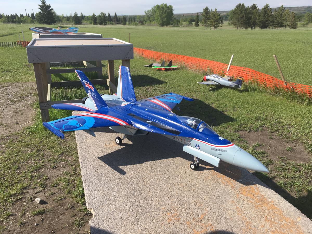

                        Am I the last person to actively fly this old bird?:Thinking: I found the unmarked box lurking in the dark recesses of my garage a few days ago. This is the maiden.
                          • 8814
                          Perhaps only till I fly mine again. I flew mine last summer and I plane to fly it again in the coming weeks. All 4 dozen of my planes take their turns. I'm sure there are still many of them out there but with the advent of the new V2 version, I doubt anyone really thinks much about the old one anymore.

                            Thats great to see. My first thought when looking at the dates of this thread was the last of them might be gone. I like your custom livery!
                              • 8814
                              Well, it's not really "custom". It was the stock livery as sold in Australia through Xtreme Hobby there. They stopped selling them some years ago as Xtreme had a poor reputation in OZ. In fact, Xtreme doesn't even sell Freewing anymore and they don't seem to sell much of anything anymore. They didn't take the remaining stock from the Freewing Factory and Motion was kind enough to get me one of only 5 remaining in the warehouse as a special order for me. I think they are all gone now. Even your livery, which was the main theme for the rest of the world, is no longer available. I have a feeling they've been discontinued since the factory now makes the V2. I don't know what they did with the molds. It's not the same size as the V2, so they may have melted them down for scrap and made other molds out of it.
                              I'll be getting my V2 on about a week and I'll bet the quality of the foam in the new one will far surpass that of the old one. You know as well as I do, the foam on the old one was quite soft and not very strong. It's also quite porous. I coated mine with Mod Podge to seal up the pores and help make the surface a bit more solid.
