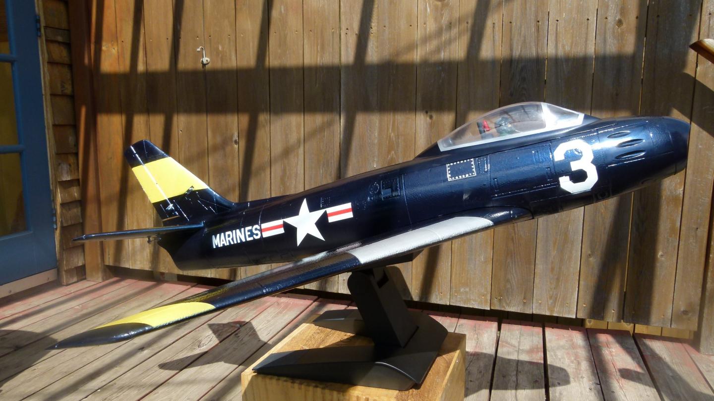

                      Ditto on the F86! That was my first 80mm. A little hairy at first, but it's a great glider and not too expensive. This is my F86 rendition... I also went with the Dynam Turbo jet too.

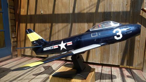

                        Beautiful work! Looks awesome with the Marine scheme!
