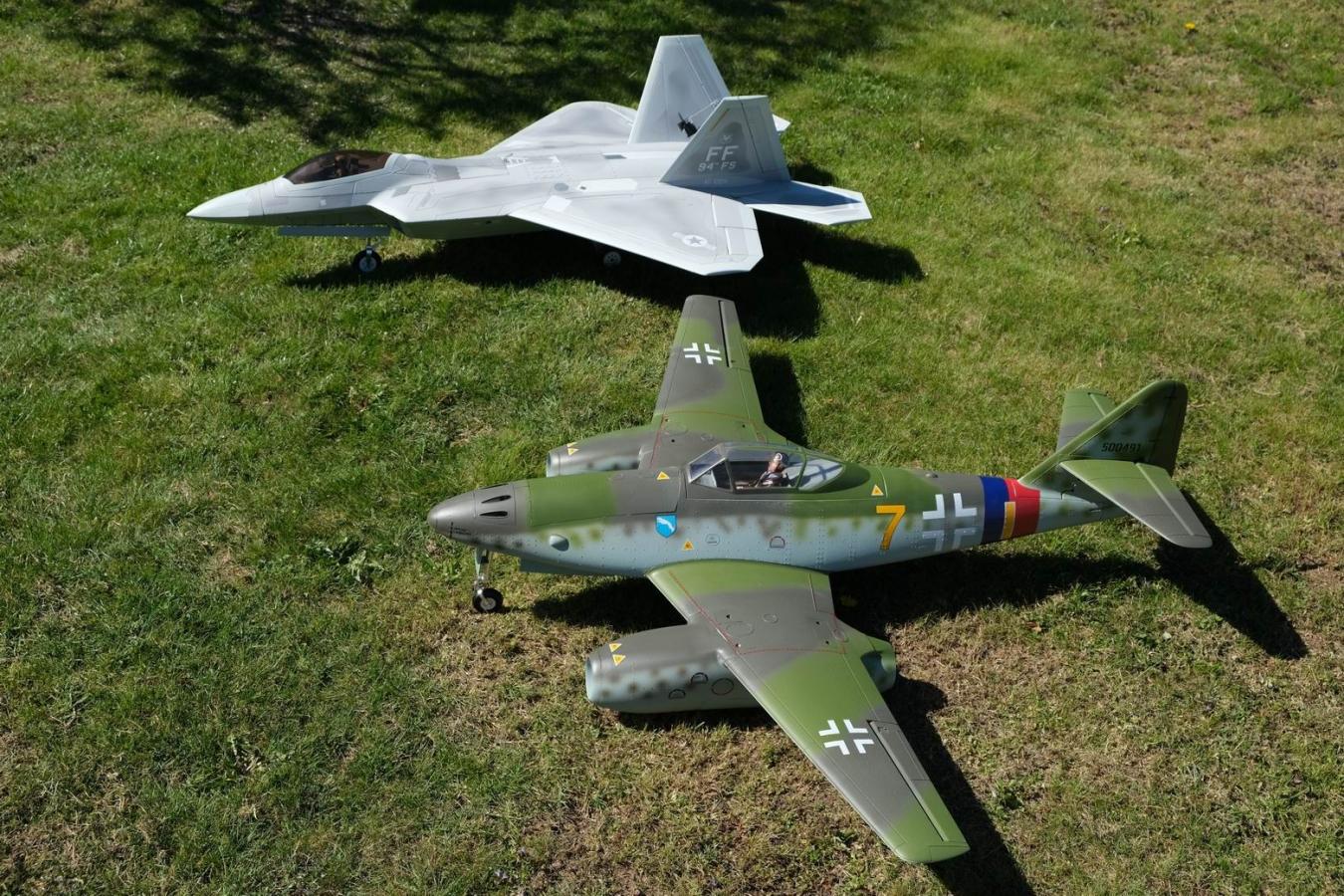

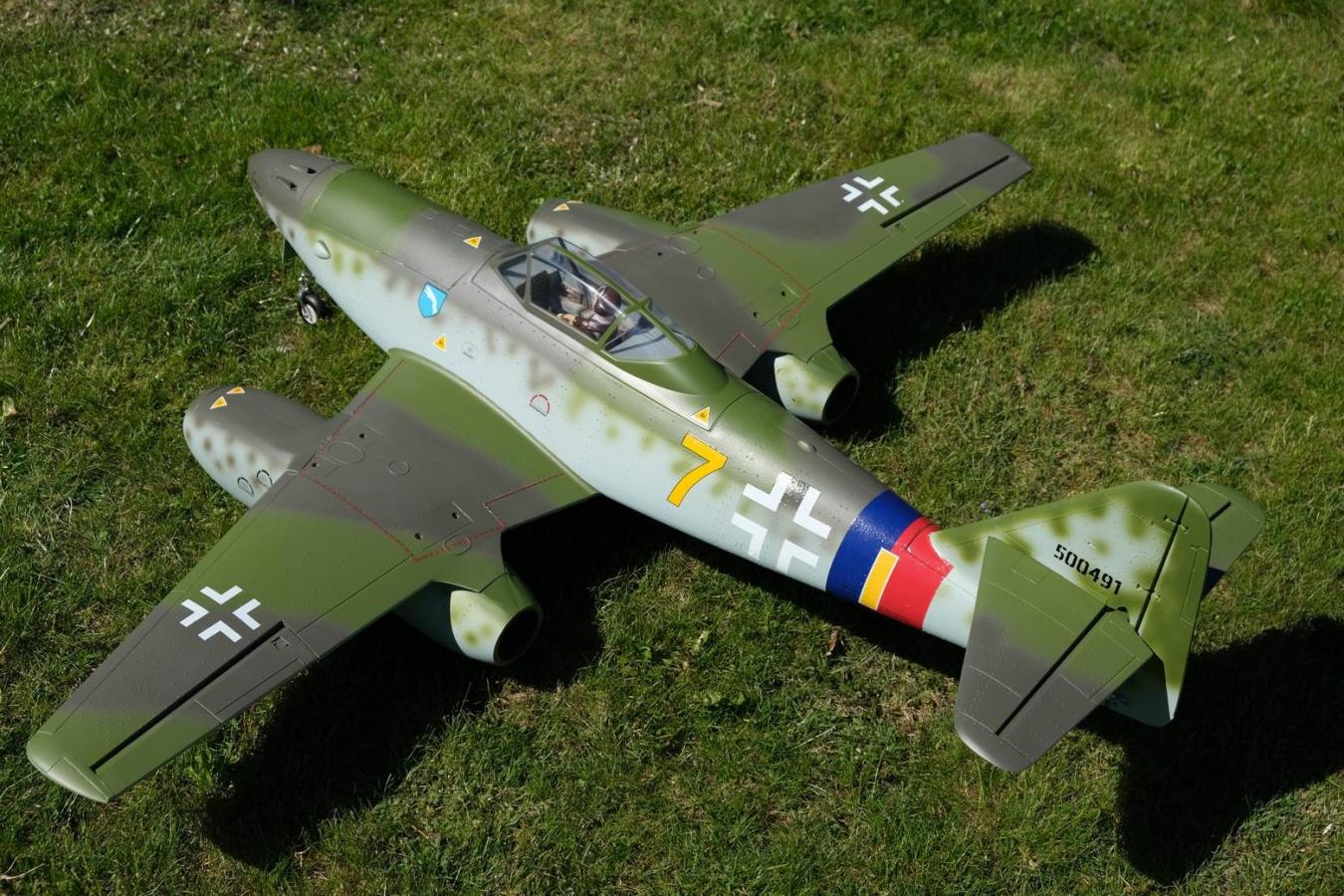

              I'm impressed. Quite a model...

                Good, all went well then? Yes, in fact for me its neck and neck between the 262 and the Venom. As it happens, I flew our 8S F-22 today, a very different bird to the 262, but fun none the less.
                Look forward to seeing more from you Radar on this.

                  The falling leaf mottling is never easy to recreate, especially on a mass produced model painted by hand. We implemented a special training course for the paint team to airbrush the mottling pattern by hand. After painting the main areas using conformal paint molds and letting it dry, the mottling alongside the fuselage is applied by a different painter using a smaller airbrush. It adds lots of time to the production line, but I think the result is much more realistic than hard lined mottling. Our gradations and patterns are unique; no two Me-262s are identical.

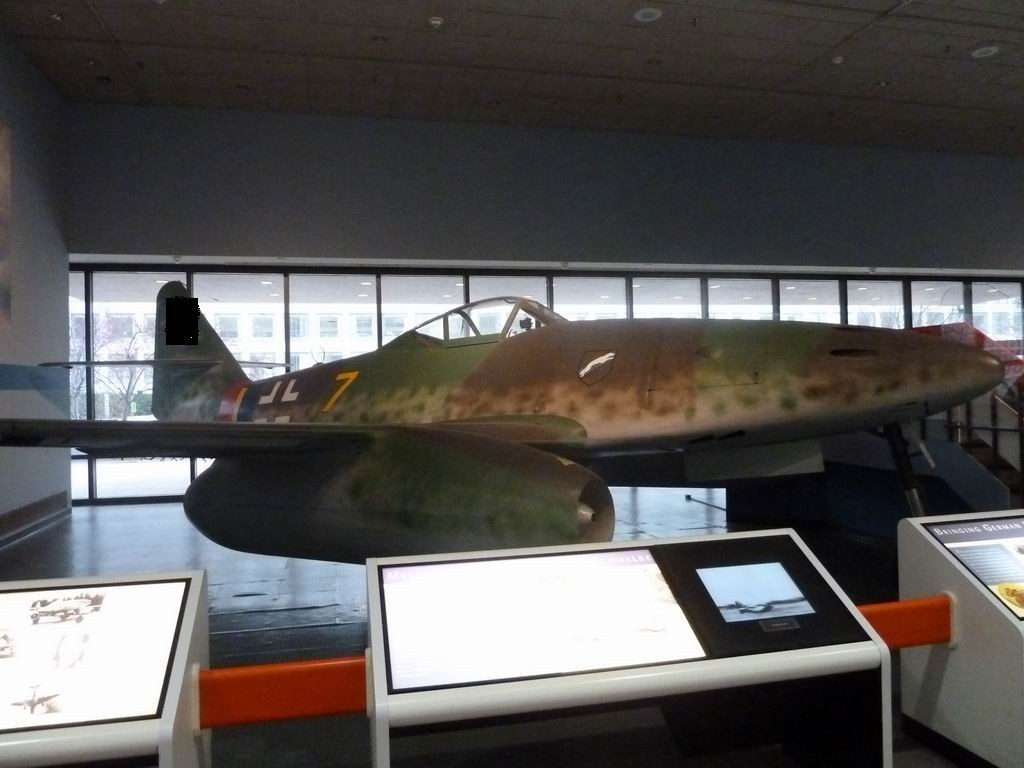

                    Great paint job, although the FSA looks a bit different. More mottling, please... ;)
                    Click image for larger version  Name:	Original Smithonian.JPG Views:	0 Size:	113.7 KB ID:	190972

                      A masking "card" held a couple of inches from the model and spraying through the holes will result in fuzzy edged mottling.
                      Do it with a card for each color and doing the mottling will be quicker.
                      Wastes more paint and your "cards" will have to be cleaned off (thin metal) or replaced (card stock) when the buildup is thick.
                      But it would save time and make the pattern more alike from one plane to the next.

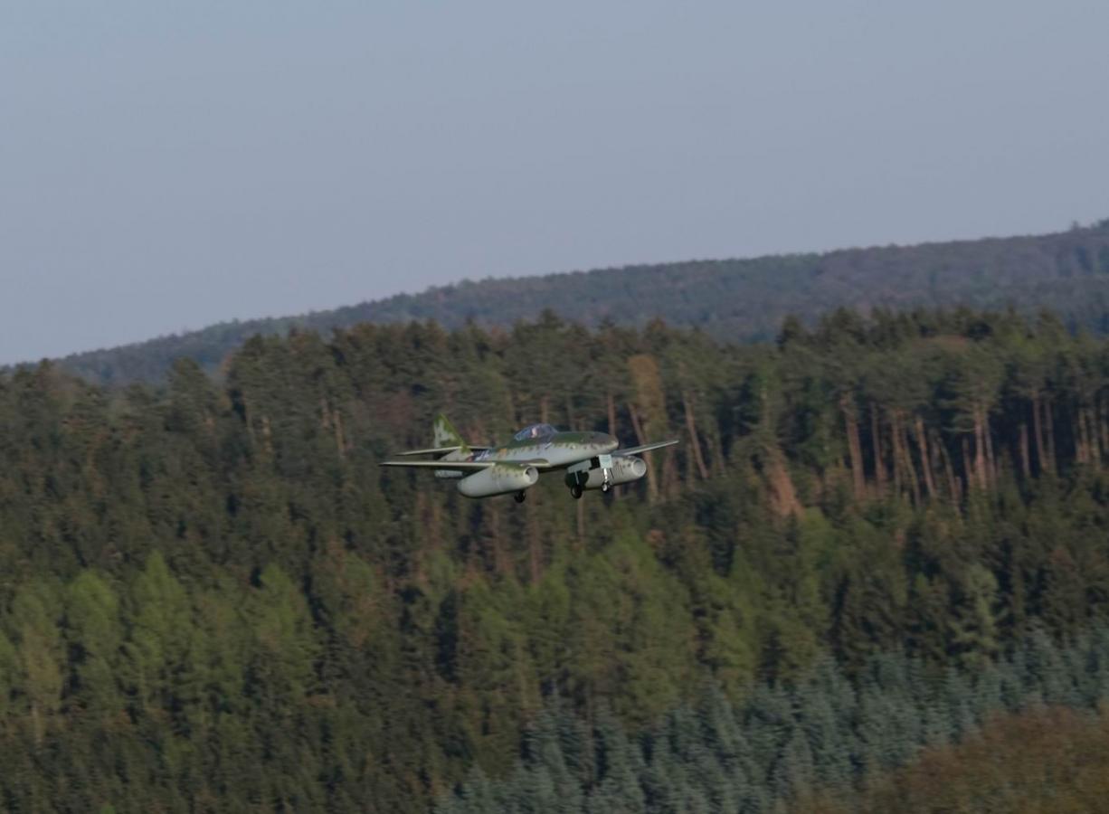

                        Made the first three flights, absolutely no issues. No problem with take-offs even from higher grass. Flight times with 6s 6000mAh between 5 and 6 min, ~3,7V left per cell.

                            Great proof that the 262 can coupe with even rough grass strips ;) Nice video Radar-guy and what did your club mates make of it?
