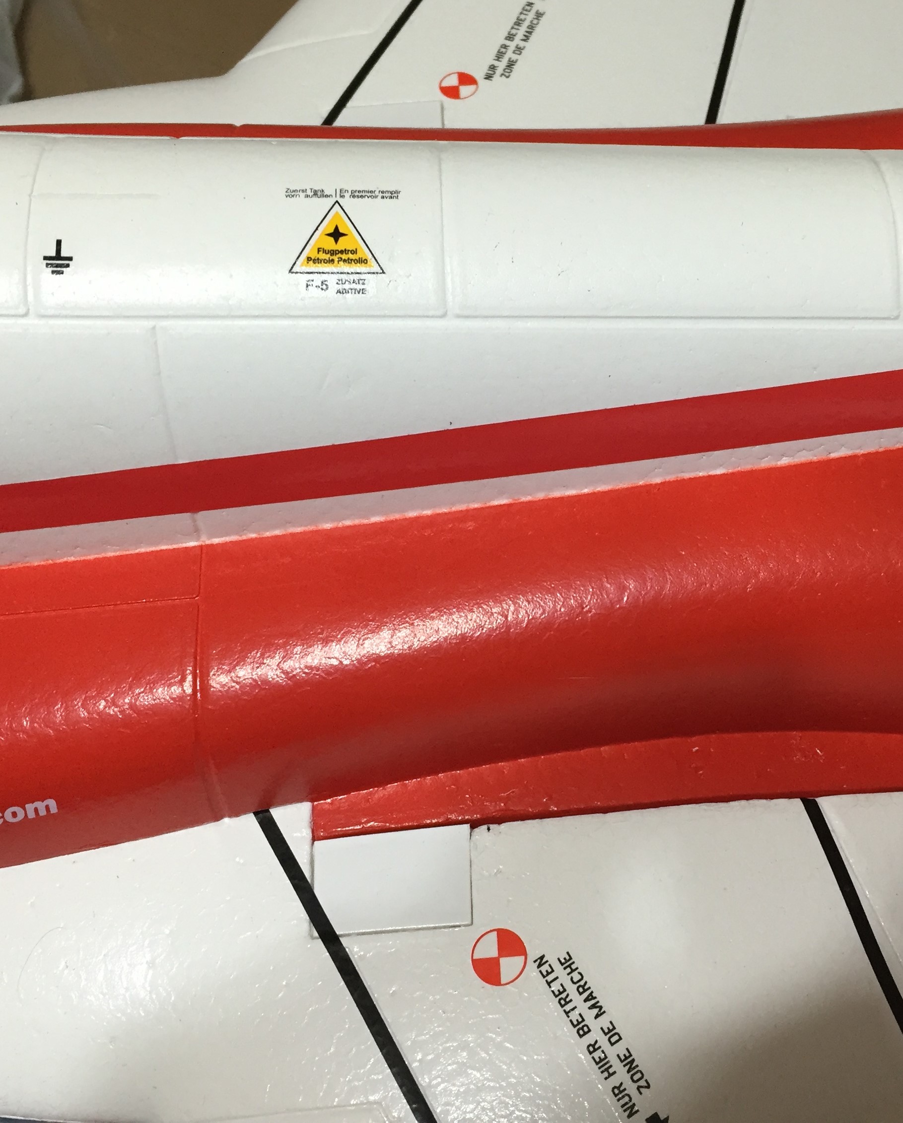

          I appreciate your help.  When you balance, I assume that you balance it upside down with the wheels down since it is a low wing?  And the COG I measured it from the tail and is at the proper place which puts it at the point it is recommended.  See pic, not real sure what you mean by the wing hold down spreader plate, sorry.

            Nope I balanced right side up with the gear retracted at 540 mm from the aft end per the manual.
            You should see a plastic spreader plate which the front hold down screws go through. I balance right on the aft end of this plate (bottom of wing).
            I balance by moving the plane along the sharp edge of the table until the nose starts to drop. The teetering on the edge means that that is the balance point. No pendulum effect to mess up your reading.
