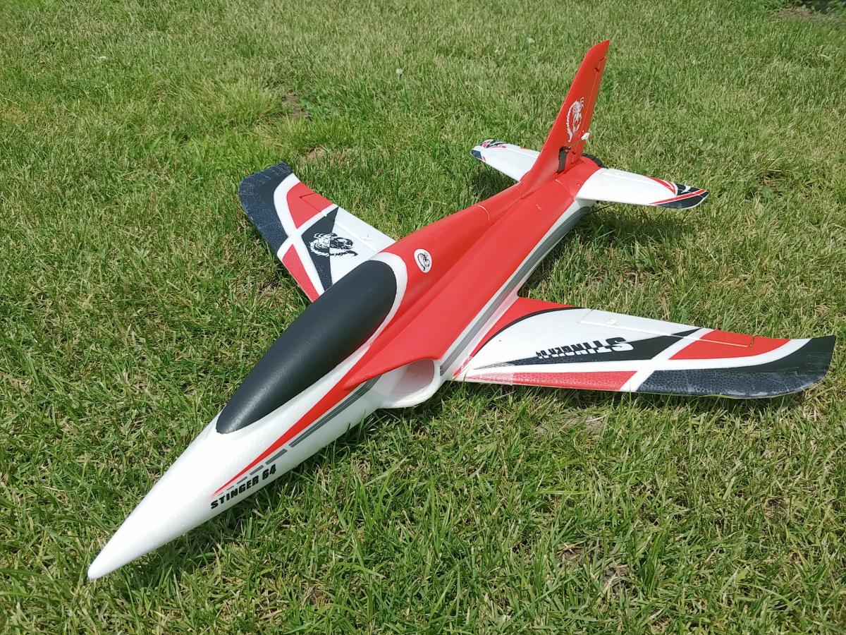

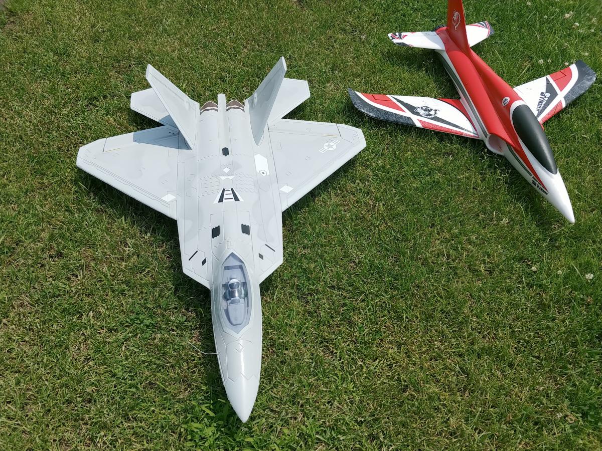

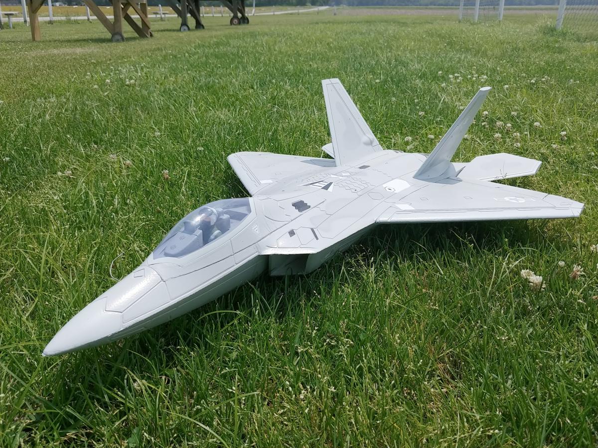

                                    Click image for larger version  Name:	20190602_140249.jpg Views:	0 Size:	341.4 KB ID:	202106 There are vents on the sides of the scoop holes.
                                    :Silly:
                                    The ESCs are rather small compared to similar 40A esc. It has the size of a 30A, and the fact that there is no brand, no spec sheet, basically a Banggood Aliexpress package, makes them look much cheaper.
                                    I already bought 45A to replace it and use those cheap ones from the F22 and the Stinger for cheap slow flyer projects. I will later upload and put side bt side. Its simple as that, similar to laptops were the chassis is the heatsink. Been too small, heat has nowhere to go. The other option is to make a hole and expose it metal plate facing out.
                                    I can definitely tell, at the beginning has a lot of punch, but a minute into flight and as a governor turned on.
