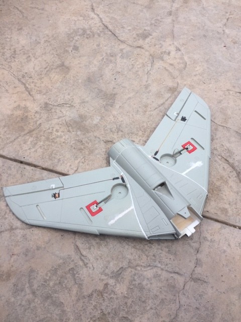

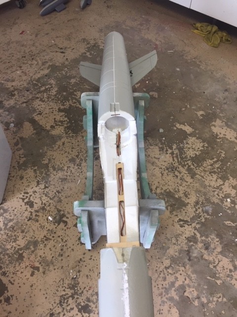

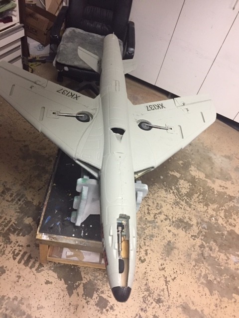

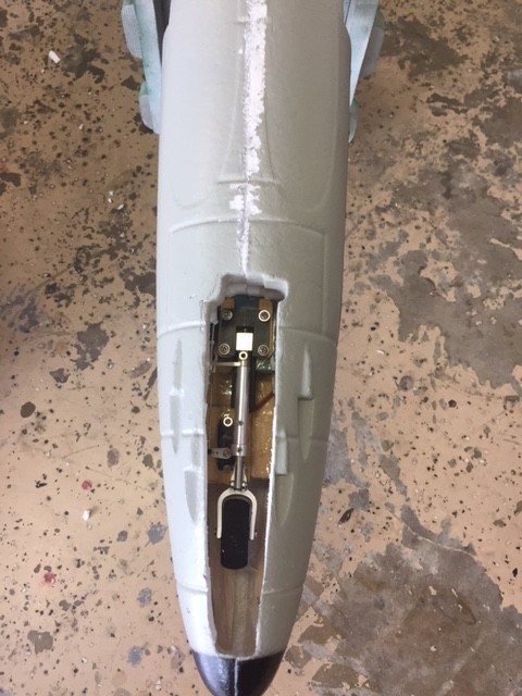

    However, the kid in me wants to believe their prediction of Hawker Hunter. I just hope it's not going to be another 70 mm jet. I just finished building my Fly Fly Hawker Hunter and it took me over 30 hours of build time. I knew that if I Freewing came out with the HUNTER, I would certainly not waste another minute building the Fly Fly Kit. So I got the Fly Fly Hunter Box out of my basement and started building it with upgraded Freewing electronics before its too late. I would not recommend anyone to buy that KiT, since it took a great deal of building skills, to make that into a decent jet.

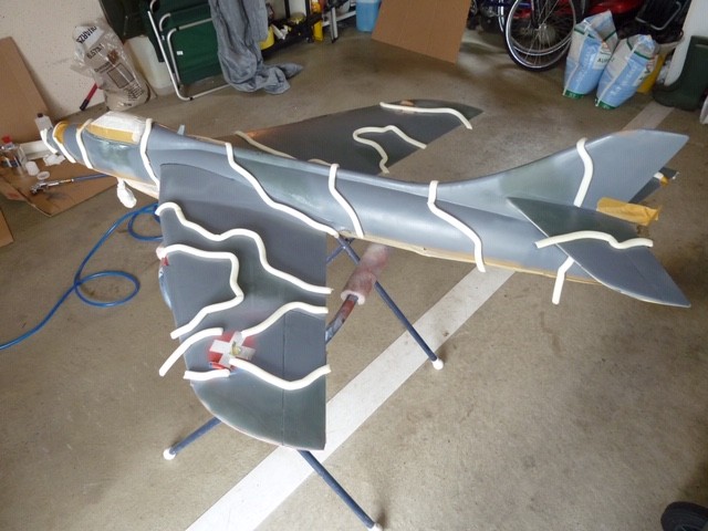

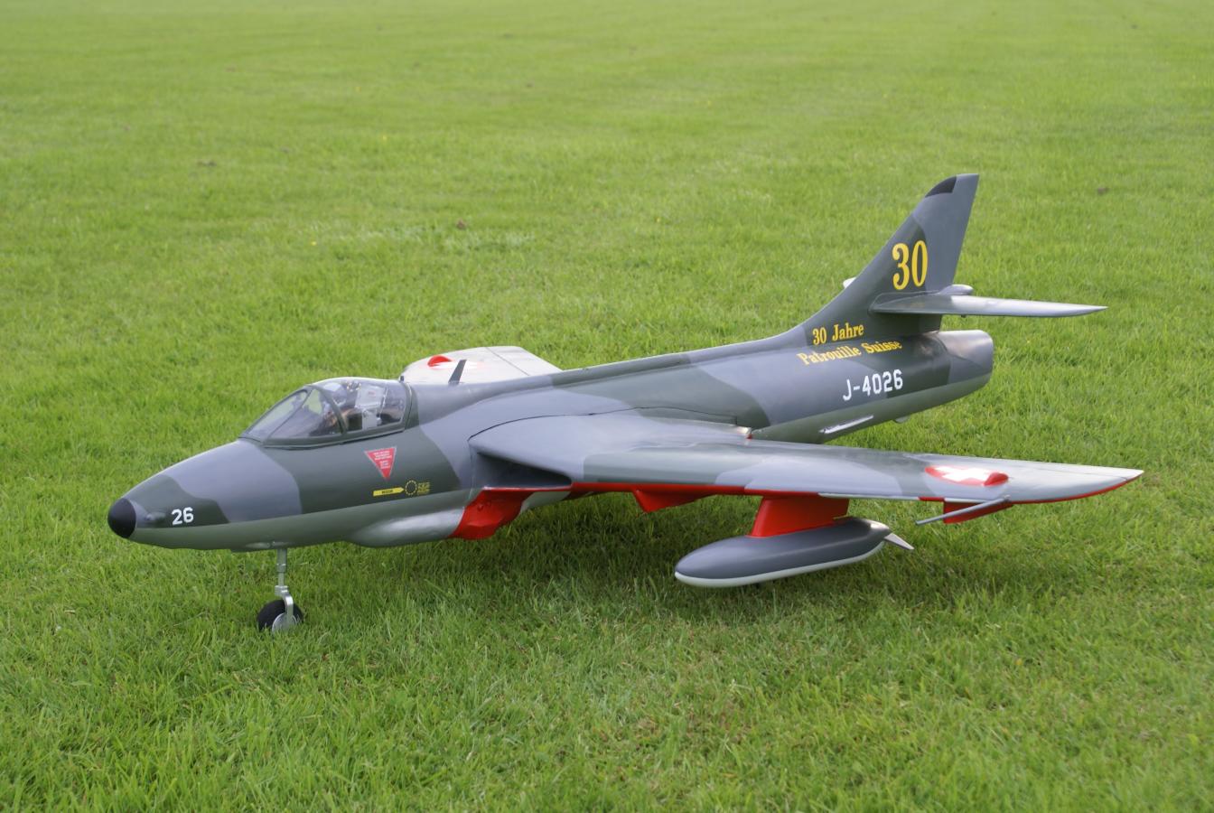

      That is one of the best Fly Fly Hawker Hunters I've seen. Any chance you'd share more photos of your jet? Especially the under belly where the red scheme is. I believe the red would make the red would make the jetvisible in the sky.. Judging from the clean crisp paint lines, it looks like you re painted the whole thing. This is my 3rd Hunter build and I tried to improve the quality each time. I do agree, that in the end it ends up a great flyer.
      • #4
        Many thanks. It came as an unpainted white EPO kit, ordered from JePe in the Netherlands. It has balsa leading and trailing edges, revised aircraft grade ply gear mounts and a 3d printed rear end (75mm outlet diameter9. Covered with 25gr glass and painted. Note that there is no ventral 'cheater' hole. Here are some pics (incl. FSA).

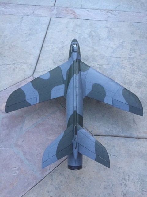

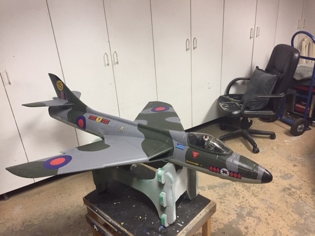

                    Here are some photos of the finished Hawker Hunter build. Hope to maiden it this weekend.
                    • #11
                      A few different squadrons represented there but very nicely done. You will find that she becomes one of your “‘go to” models when either you or the weather aren’t 100% ! What is the motive force in yours ?
