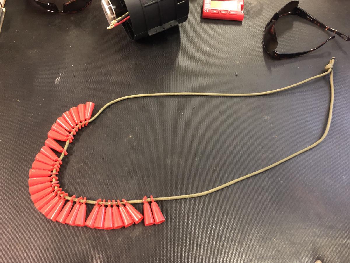

            You're welcome...;)

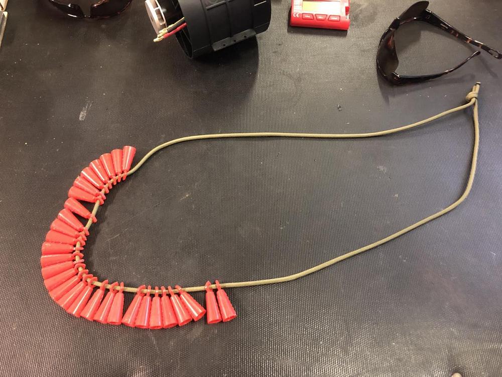

              You're welcome...;)
              You could almost get "lei'd" with that.
                At $9 a bottle I already have ;)

                  It's over $12.00 a bottle in Calgary. I must have way more expensive taste in high end call .............. I mean glue, than you.

                    You guys crack me up! LOL

                      LOL. George, I love the lei !!

                        I wish I had thought of it before I threw the first 20 or 30 away, Hangar Days take a toll on Foam-Tac :Silly:
